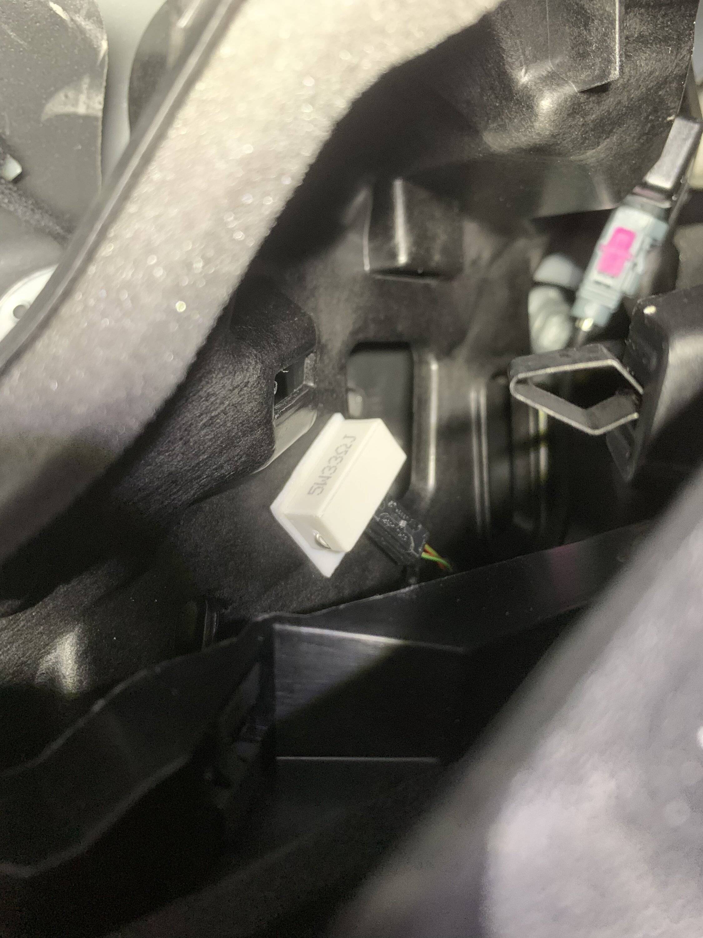

Thanks for the tip @Tincan for the Cross Turismo. I removed my speaker tonight and replaced it with a 33ohm resistor I had lying around. The close button still works, maintaining all functionality, and no codes.
@ciaranob @BobC

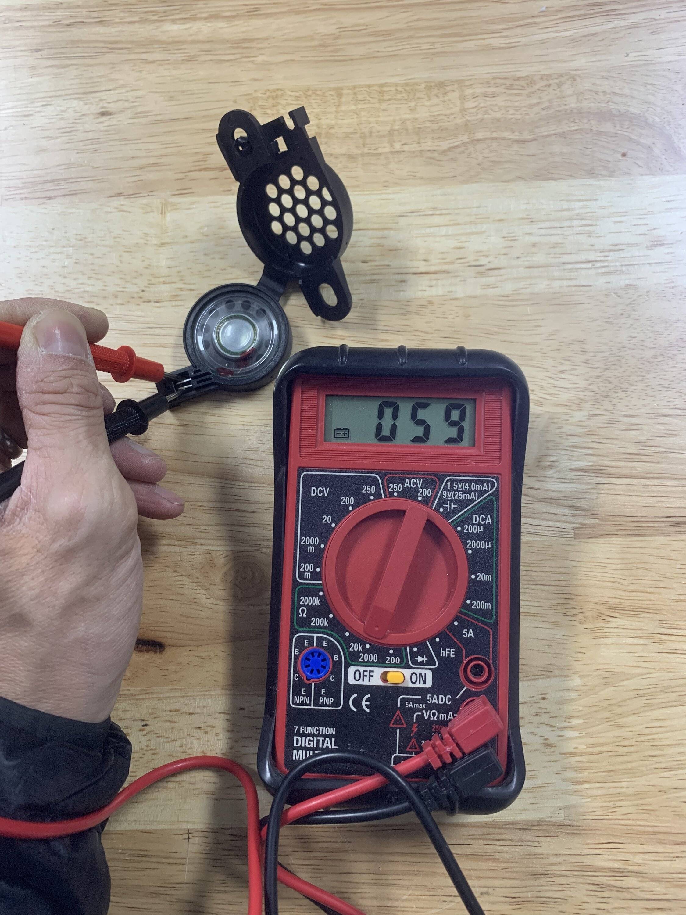

FYI, the speaker has a resistance of about 60ohm. I used some foam tape to hold the resistor in place.
Forgot to ask but have you wired the speaker plug to this resistor or did the OEM plug fit an available receiver socket on your resistor? - can’t see from angle - thx!
I put a couple bends in the leads on the resistor and they fit directly into the (female) speaker plug.

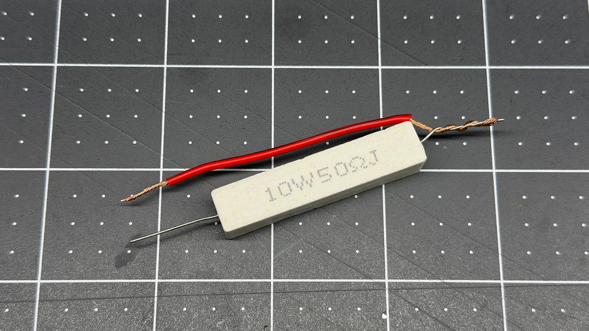

I just did this speaker removal yesterday. I followed the video's example with 2 50 ohm resistors wired together. The trunk would not close from the screen. I assume this comes down to a software difference, because 2 x 50 ohms worked for him, but not for me. Since the speaker is 60 ohms, 2 resistors is 100 ohms and that's apparently too much. I extended the wire lead on one side of the resistor and plugged that into the speaker harness, for a total of 50 ohms - much closer to 60 ohms. This worked. I'm sharing this for anyone else who ran into this issue. It's a very simple fix to extend the wire and the silent trunk is so nice.
