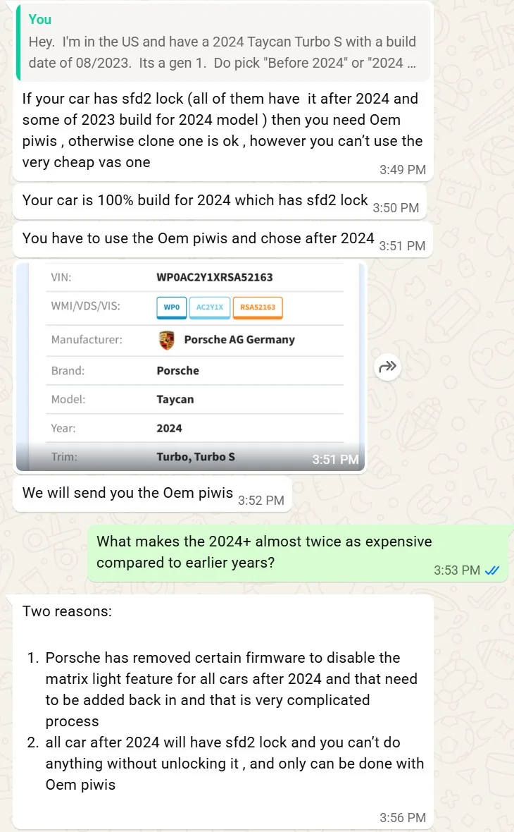

I chatted with Innovativesoftnz via WhatsApp and yep, they are very responsive. This checks one of my boxes for going this direction.
They looked up my VIN and it looks like my US 2024 is late enough that it has the sfd2 lock, aaarrrggghh:
Porsche Taycan Successful Matrix headlight activation for US Taycan Screenshot 2026-07-26 195521
Given this, I don't think I want to tackle this myself.
They currently have all 4 of their oem plwis sets in the US right now so it would get to me relatively quick if I pulled the trigger. Queue is about 2 weeks right now. Decisions, decisions....
