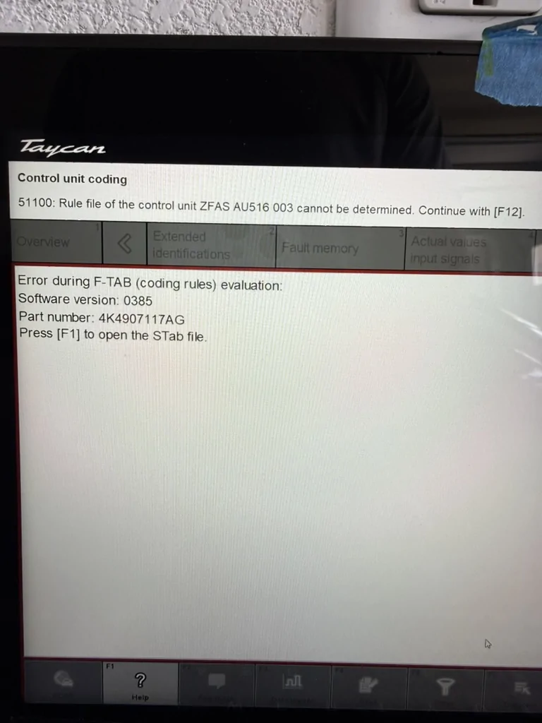

Dealer just completed the driver assistance recall and lost my matrix functionality. Fortunately, no other ECUs were touched except for ZFAS. Would anyone happen to have an updated version of PIWIS that supports this ZFAS software version?
Which recall campaign was that?
