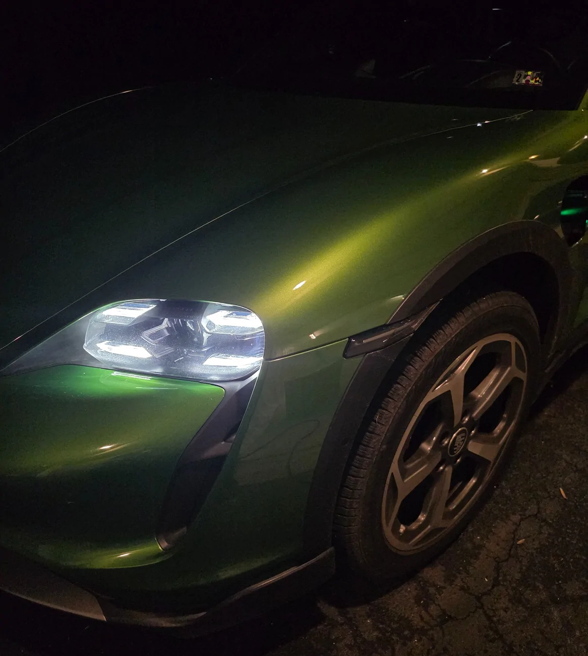

Sergey, can you confirm if your side markers work after the matrix coding. My stopped workig completely, only work when turn signal is ON
They do not. I did reply to your new thread. I am not happy about it, so thank you for noting this. I will ask the coder to see what can be done.

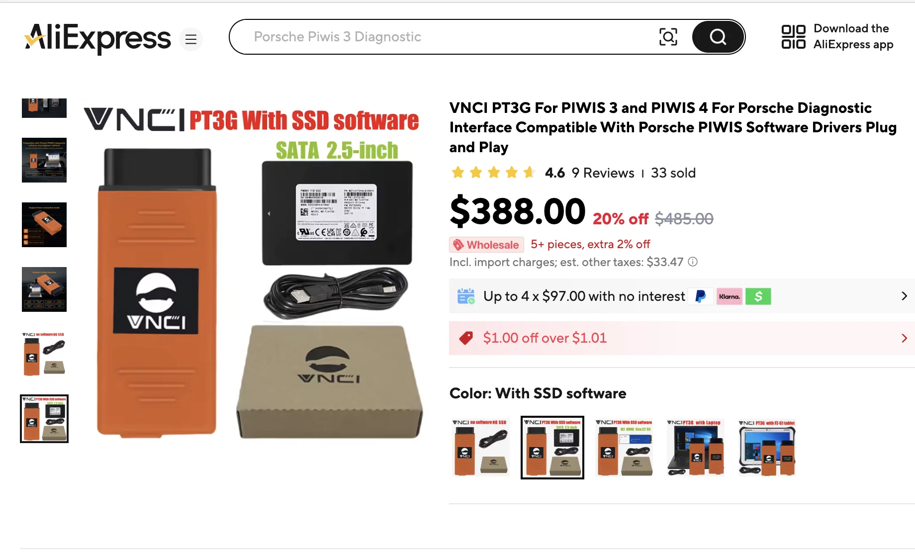

I ended up doing the Matrix activation as a DIY. There are a lot of threads about setting up a cheap PIWIS with a $40 and a free or near-free bootleg PIWIS installed in a VM, but after spending many hours trying to make that work, I found that for a Taycan you absolutely need the most recent PIWIS 3 version and a VNCI clone, which I bought for about $400 (including software preinstalled on a SSD) from this guy on AliExpress:
https://www.aliexpress.us/item/3256...il_item.4.2805f19cLl2vRF&gatewayAdapt=glo2usa.
Ideally, you will want a dedicated laptop (like a used Lenovo ThinkPad) as a dedicated PIWIS machine, but I used a desktop machine that I had to move to my garage for a day. Also, you do need to have a good charger or high quality jumpers and an other car running to make sure your 12v on the Taycan does not drop in voltage while you are coding. When the Taycan is in maintenance mode, it disconnects your high voltage battery, so you do not get to use it as a backup while coding in PIWIS.
I definitely spent way too many hours on this project, but I was not going to stop without success. It helps if you know how to operate in PIWIS, as it was time consuming figuring out how that software operates. I like a DIY challenge, and the $800+ price tag on having a coder do this plus getting to have a PIWIS myself for future use was my motivation. In the end, it cost me $400 and I now have working Euro spec Matrix headlights, a good PIWIS install and some well earned DIY satisfaction.
The specific coding entries from @bigkraig were very helpful. The only surprise I had when finishing was that my spoiler stayed up like it had Perony's disease, but after parking for a couple hours and then driving, that resolved itself.
