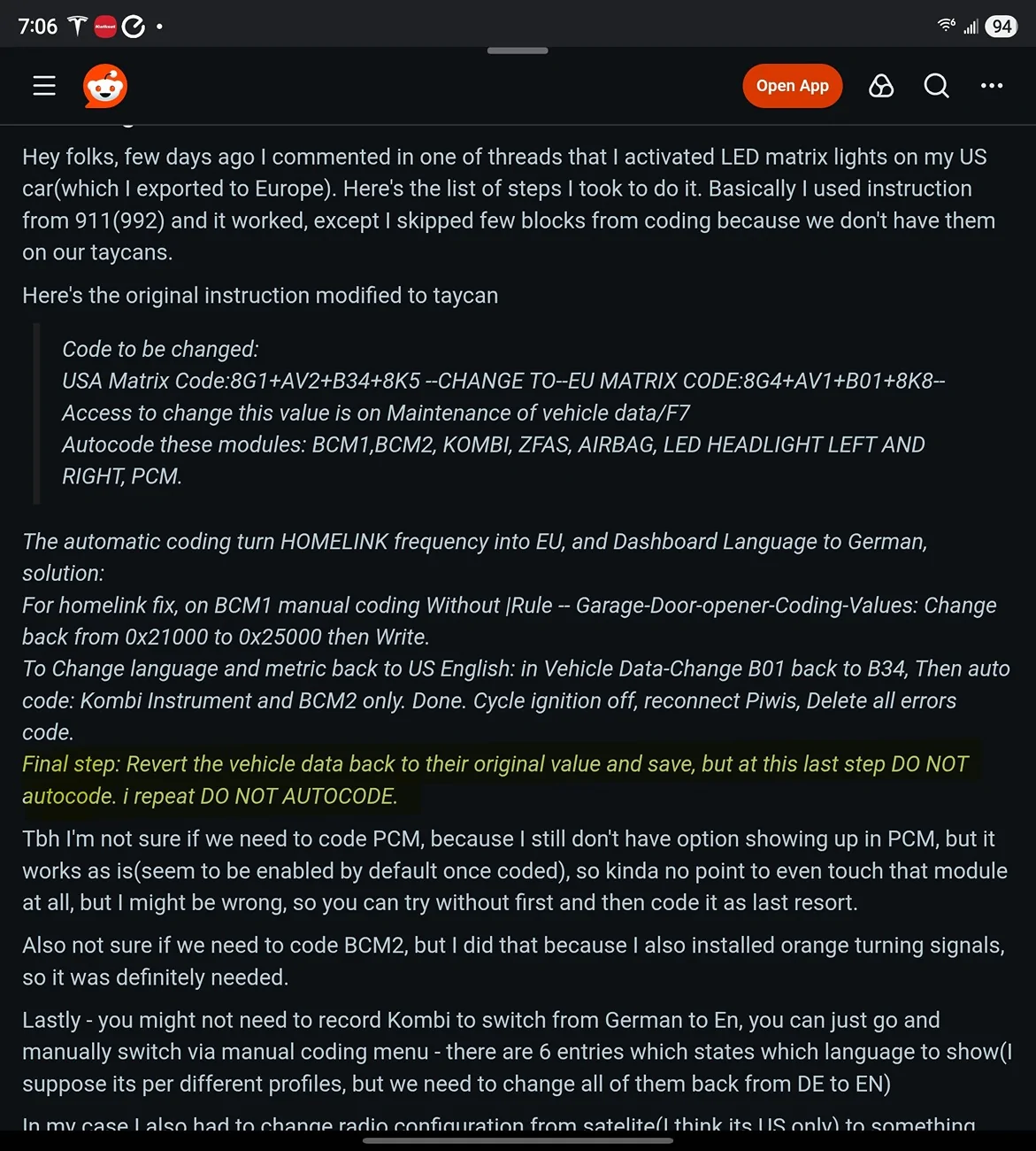

BCM2 autocoding may not be necessary- with the “vehicle data” using the euro spec, it may throw rear taillight defective errors against US taillights; it did for me. I redid the process and skipped BCM2, and no issue.
I couldn't find my notes (I have them, but I think in a backup somewhere), but I'm sure I never recoded the BCM2 for matrix headlights (I did that activation before I added euro tail-lights, at which point I had to recode BCM2). I also recoded my BCM1 back to the US in order to get the homelink back, and MIB3 back to US as well to eliminate a warning (which only showed up in logs, never on IC or PCM, but I still didn't like it) - matrix headlights still work (and have worked for me for 3 years now).

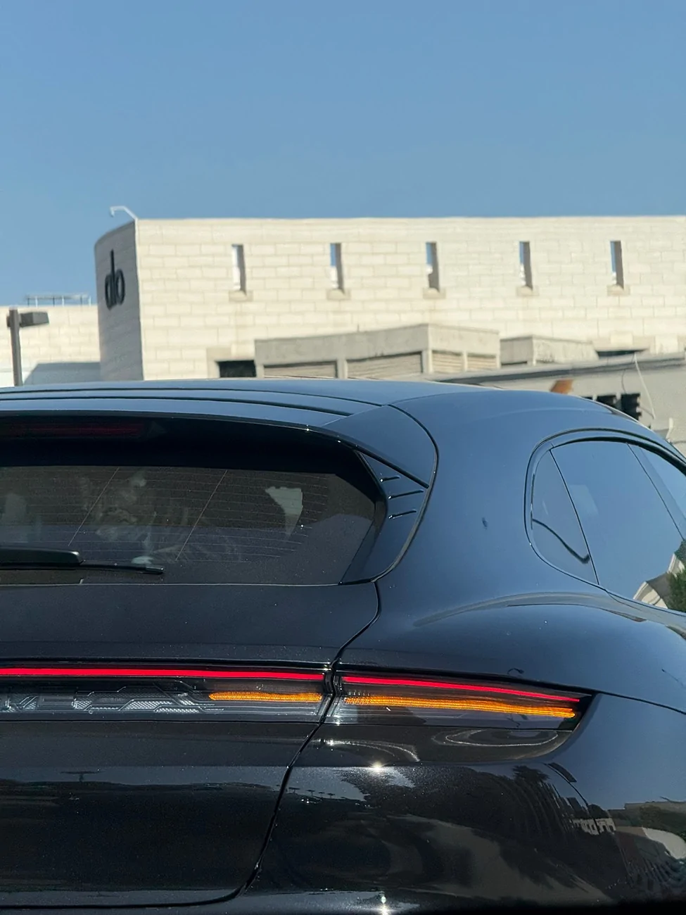

Turn on your hazards and check? The additional wiring is for hatch amber light which US lights don’t have. The picture above is what my US lights looked like after coding BCM2. Furthermore, your frunk exit button might also be blinking when your hazards are on (one of the missing wiring for EU tail light is wired to that button instead, on cars).

Ok. Wish me luck :) Will be coding my Matrix lights right now. I have one question regarding the attached notes - what it means revert the vehicle data to original value? What needs to be done? If I code everything back to original values as it was before I will lose the EU Matrix option, no?
You're basically changing back the vehicle data, but not actually using those option codes to auto code the ECU modules again. So, you're not losing anything. This is actually a VERY IMPORTANT step.
The reddit OP also switched to euro amber taillights and needed to code BCM2 and mentions maybe not needing to for US cars with US taillights.

Ah, I didn’t know you had euro tail lights! My point before was that anyone following the previously given instructions, which include recoding BCM2, who doesn’t have euro tail lights would end up with the short, red turn signals.
BCM2 does not need to be recoded for Matrix.
