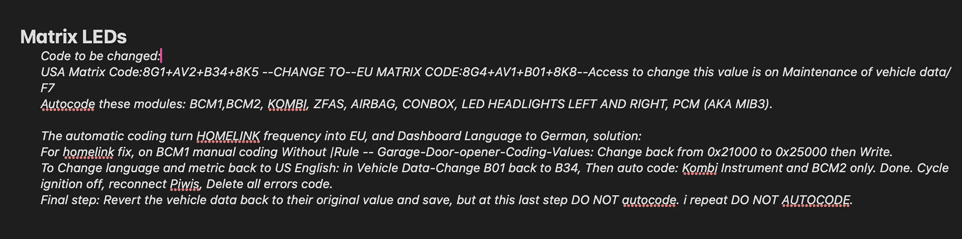

try searching the forum. i have posted it here before, these are my notes. you probably dont even need to code as many of the modules, but i did mine a long time ago before i learned more about the system and didn't take before/after VALs
Porsche Taycan Successful Matrix headlight activation for US Taycan Screenshot 2026-02-17 at 5.09.19 PM

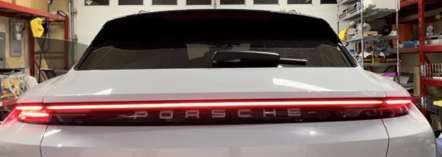

I'm curious, do your tail signal lights look like this?
Porsche Taycan Successful Matrix headlight activation for US Taycan 1771380537067-0i
(the above is from my adventures retrofitting EU tail lights, shows US tail lights with BCM2 auto-coded to AV1+B01).

hmm no i am pretty sure mine is lighting up the light on the hatch, i think it required coding and running the additional wiring. it's been a long time
Turn on your hazards and check? The additional wiring is for hatch amber light which US lights don’t have. The picture above is what my US lights looked like after coding BCM2. Furthermore, your frunk exit button might also be blinking when your hazards are on (one of the missing wiring for EU tail light is wired to that button instead, on cars).

Also good to read and be aware of draining 12V battery when autocoding modules and causing limp mode:
https://www.reddit.com/r/Taycan/s/jUe7kArZQ4
BCM2 autocoding may not be necessary- with the “vehicle data” using the euro spec, it may throw rear taillight defective errors against US taillights; it did for me. I redid the process and skipped BCM2, and no issue.
The reddit OP also switched to euro amber taillights and needed to code BCM2 and mentions maybe not needing to for US cars with US taillights.
Also to translate some jargon in the steps:
KOMBI: Kombi LG
CONBOX: Telematics
PCM: MIB3
