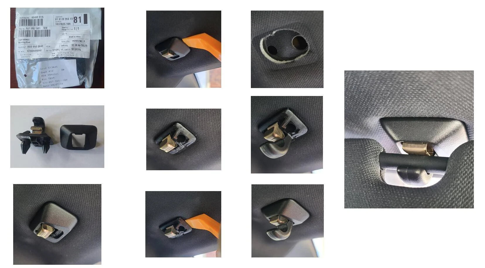

Both of mine were broken at the time of delivery. Not sure where in the process it occurred, and still waiting for parts after about three weeks. Apparently there are clip shortages as well as chip shortages..... and this is obviously a poorly designed part.

It simply pushes into two holes in the roof structure.
And those roof structure holes are obviously stronger than the plastic clip, but if you replace the plastic clip with a metal one, the roof structure holes become your next point of failure. It could be they are very strong and it would take a hammer to break, but maybe not, maybe slamming a sun visor could do it too.

The clip actually incorporates a spring-loaded metal latch, so I'm guessing a little more than 50 cents, but your point stands.

Love the pictures! I've ordered two replacement clips from Suncoast Parts and hope to get them soon.
Safest using a plastic interior trim pry tool. Remove just the outer finish piece first. Don't try to remove the entire part in one shot.

Mine broke tonight, lol. So fragile. I ordered a new one from SunCoast (thx for the link!). I also took mine apart and used gorilla glue on it. I will reinstall tomorrow and see how it holds up. Then when the replacement arrives I can either install it or have a back up.
