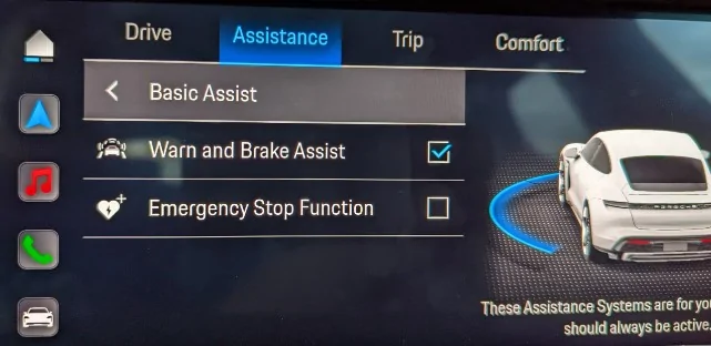

Porsche Taycan Take over steering problem Screenshot 2022-11-15 152333
If you go to the little white car icon on the bottom left and then go to assistance tab (second from the top) and then click on basic assist and turn off Emergency stop function, then the "TAKE OVER STEERING" warning stops coming up. My car was at the dealership for over a week until they can figure this out. I still believe this is a problem that should be rectified by Porsche. My hands are on the wheel when this message used to come up.
Thank a bunch for posting this fix. I was having heart attacks every other day when this message would pop up.
