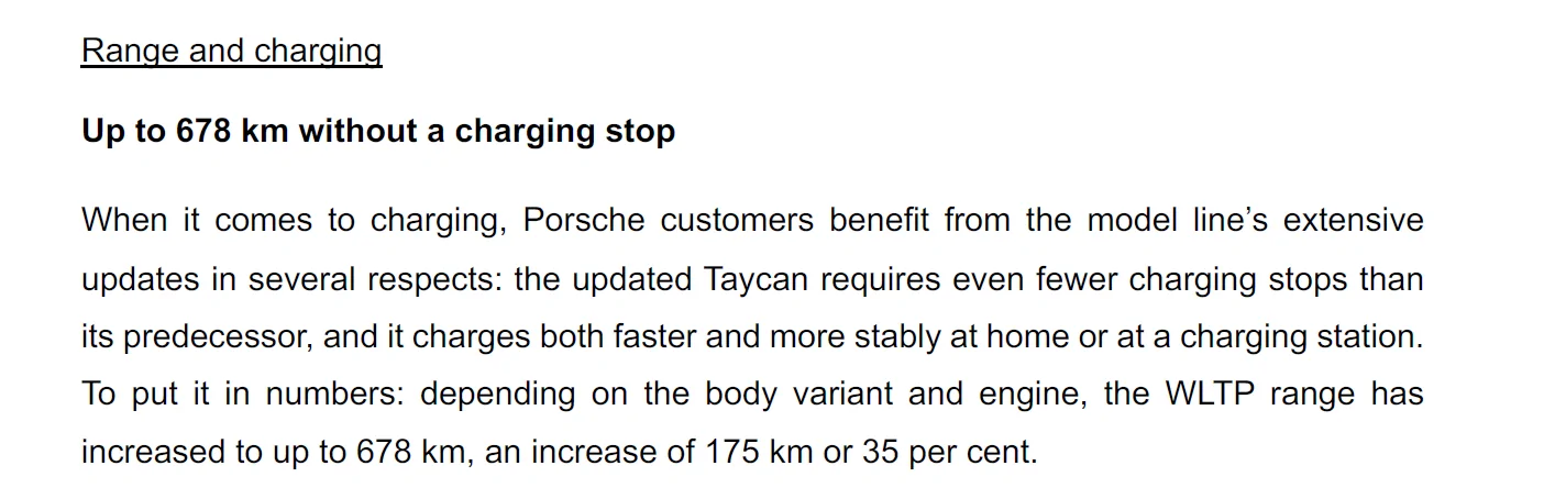

That is way low for a Gen 2 4s and with the latest and largest battery. My advise is to get the OBD reader and CarSanner app and get the data of SoH (state of health), Battery Energy, and individual cell data. I agree, that you need to look at trip efficiency as well and share that. I am getting more than you in now cold weather on Gen 1 Turbo with 21 inch all season. The range makes no sense for the type of car and battery you have.
I know this is press release stuff and ideal conditions best case (421 miles), but that is to show with data that you are way low:
