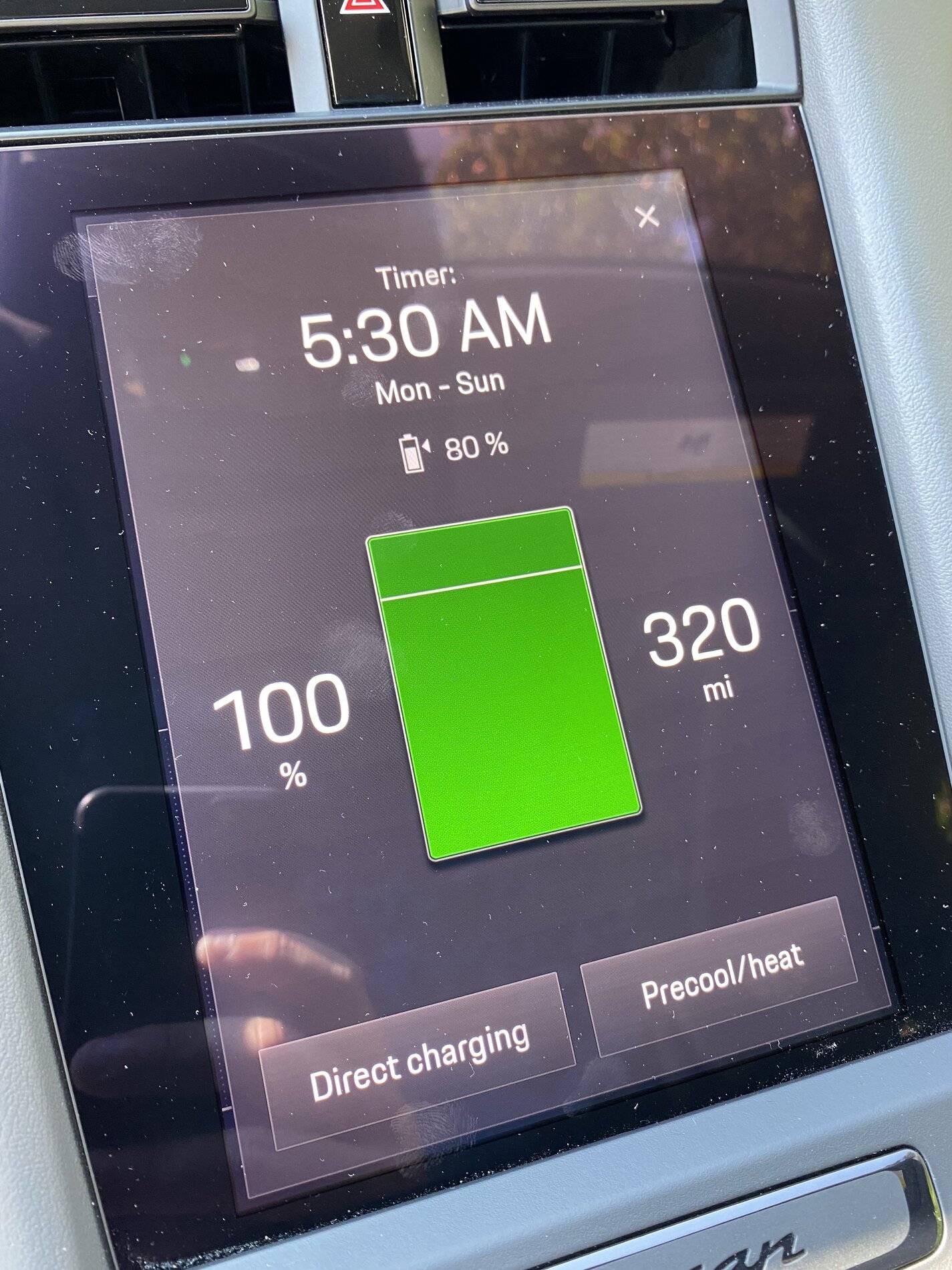

We just traded a Raven S (refresh) MS LR+ and experienced real life range consistent to about 330 or about 20% less than advertised.
My wife and I went for a quick ride for breakfast yesterday (about 9 miles round trip). We left with 232 mile range and returned with 244. I’m guessing the computer is just calibrating based on usage. My wife drove with regen in auto and she wouldn’t be considered an EV friendly driver—especially now. I left for the office this morning and said just don’t get any speeding tickets.

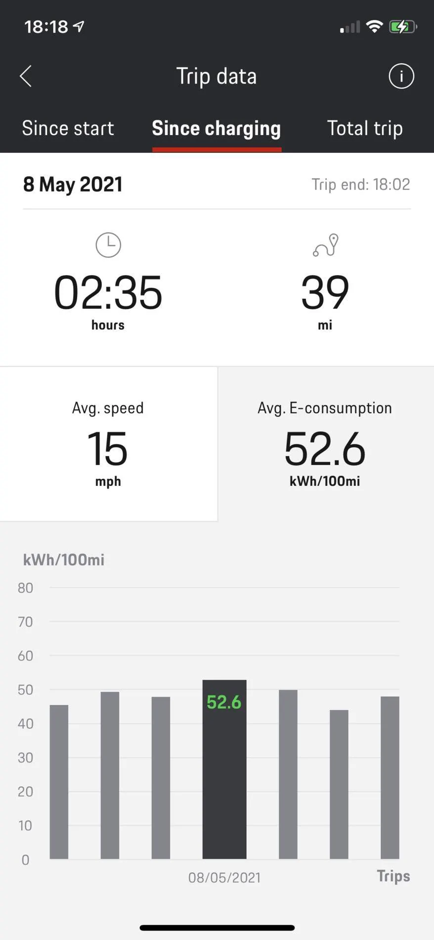

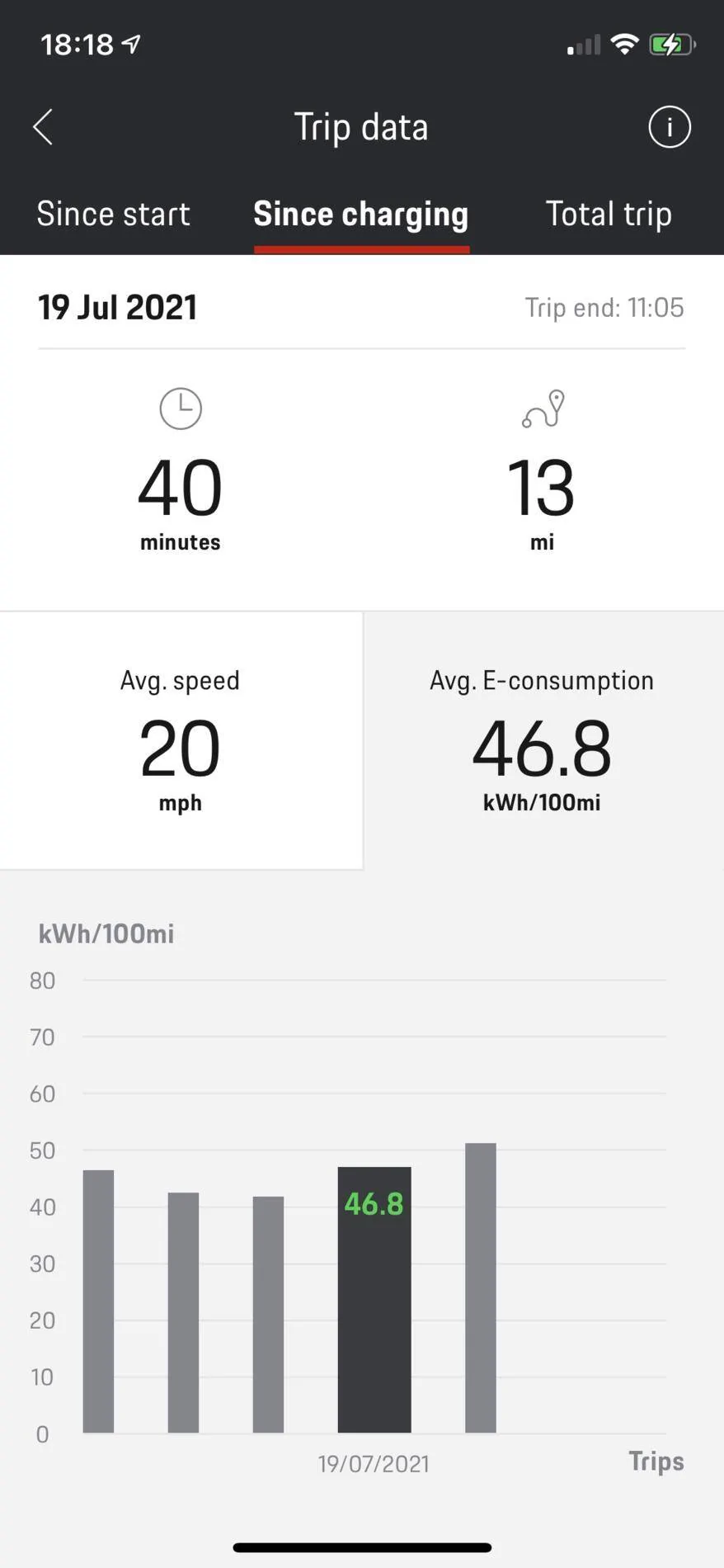

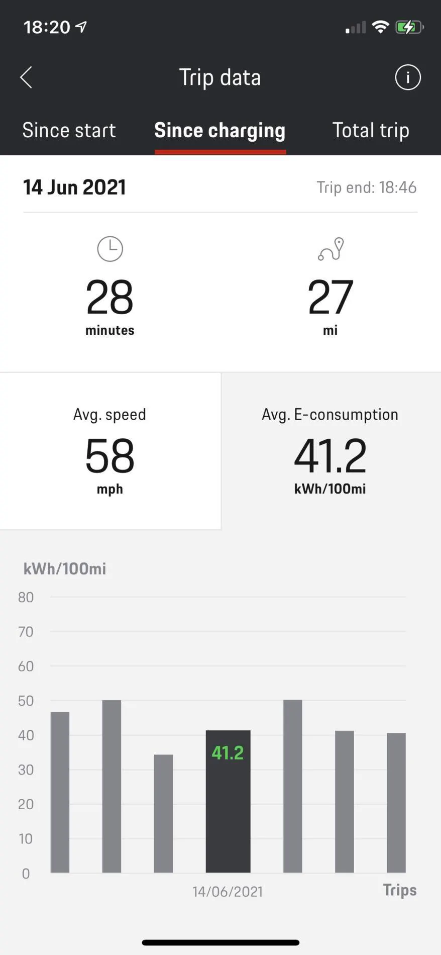

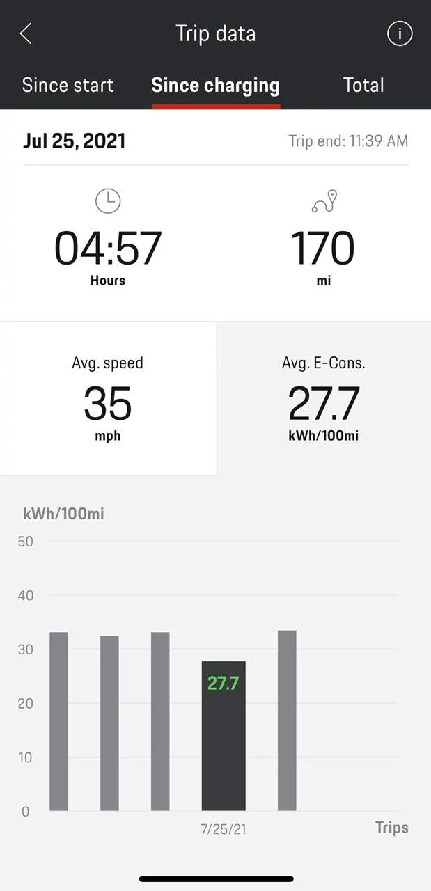

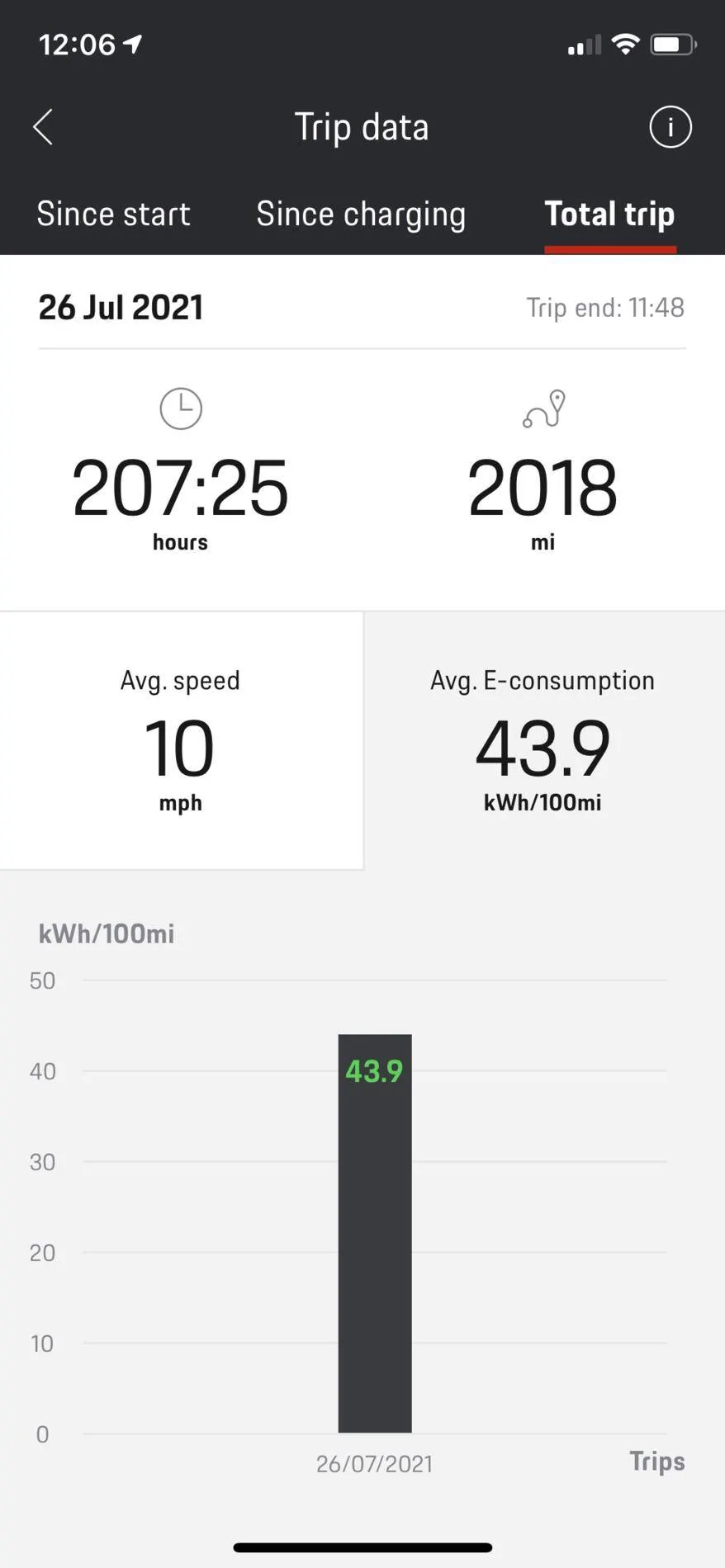

Average speed too low. Car was switched on using power, but actually didn't go anywhere... 200 h for just 2k miles???
The car is rarely switched on but not moving (outside of the few moments it takes to put my seatbelt on and put into drive).

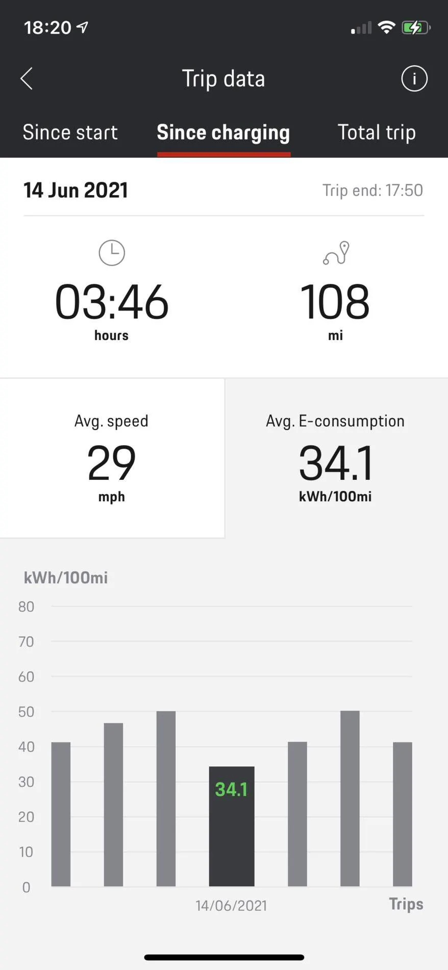

100% battery range is estimated at 170 miles
The very best consumption I’ve ever had was 34.1 kWh/100mi.
Here are some examples of trips:

You must be a very dynamic driver: 52.6 kWh/100 mi over 39 miles...
legataycan
Sep 29, 2020
117
Taycan 4S, 981 Boxster
Yep, that’s the kind of response I get from Porsche. No matter how serenely I drive I can’t get this consumption down.

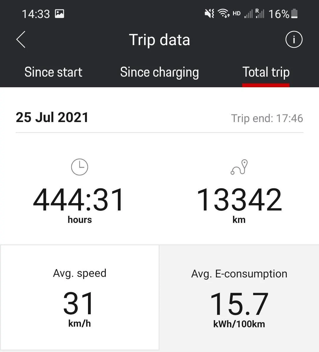

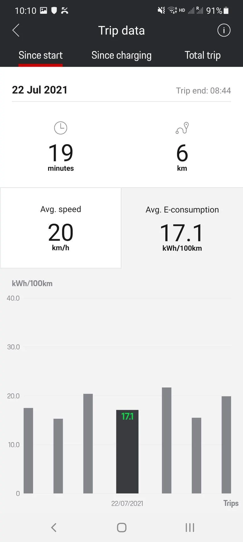

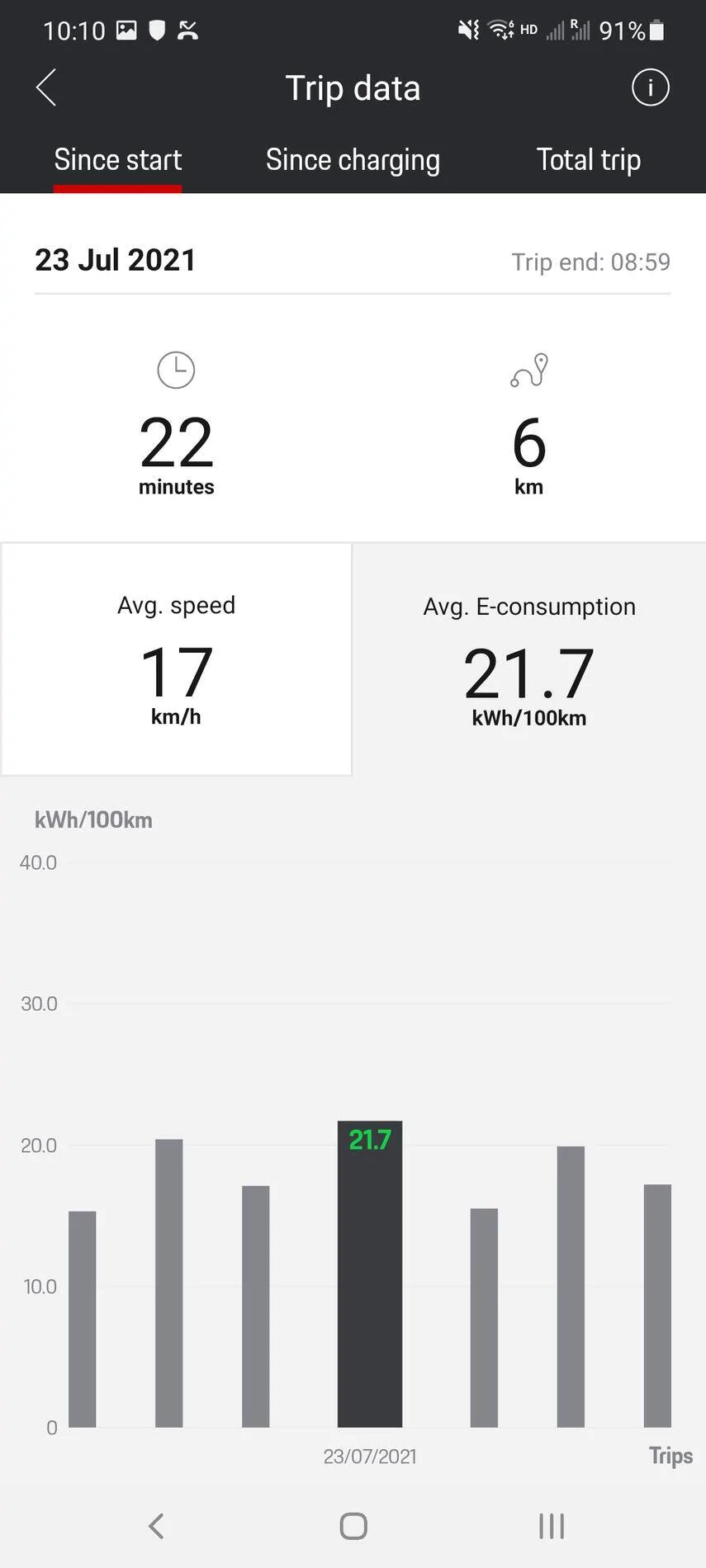

I really don't understand how your consumption can be so high. Do you have any recup? Do you see the green bar when you break?
Here are short trips where I have higher consumption with lower average speed than you. It's super hot here and my AC runs on 25°C Eco mode with outside temp over 30°C.
Porsche Taycan Taycan 4S gets 323 mile real world range in Edmunds EV range test! Screenshot_20210727-101000
Porsche Taycan Taycan 4S gets 323 mile real world range in Edmunds EV range test! Screenshot_20210727-101015
Exactly the same drive. But with different consumption due to driving style.
