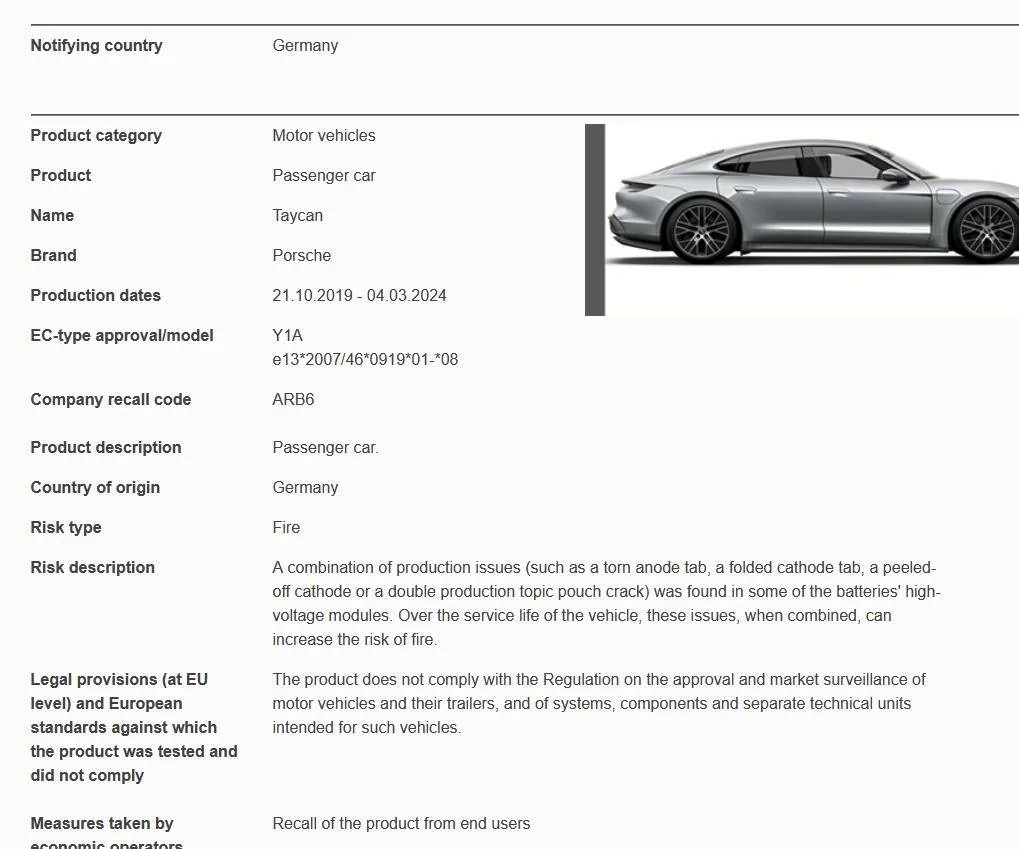

Even this image states that the problem “was found in SOME OF THE BATTERIES’ HIGH VOLTAGE MODULE.”
You may interpret that the problem is in SOME module in EVERY vehicle, but it will be a personal interpretarion. Specifically, YOURS.
