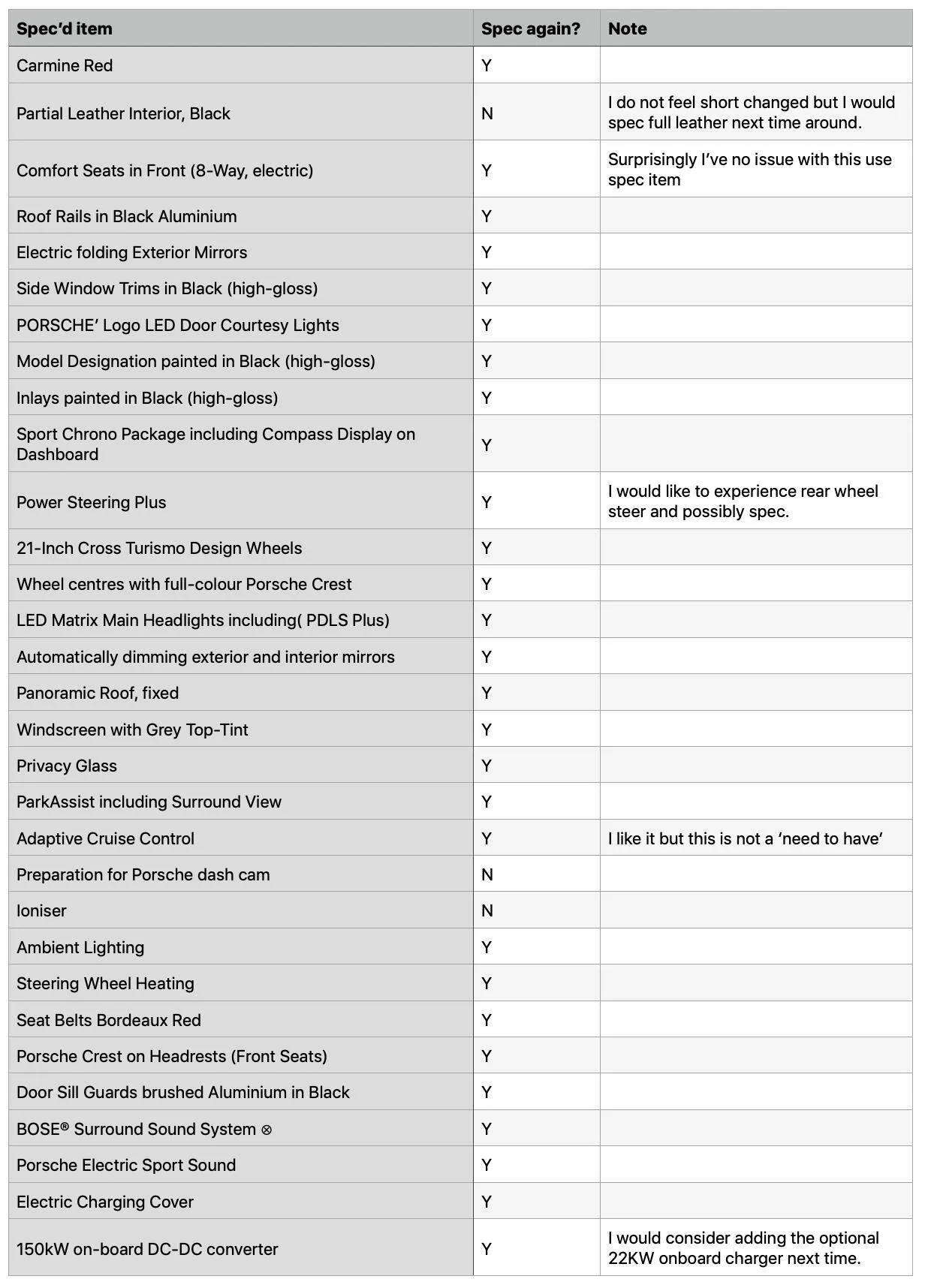

My Spec:
  • I've included each individual item i added to this car below. I've highlighting whether or not i would include in the spec once more as well as some additional notes for that line item.
Porsche Taycan Taycan CT4S | First 5000Km Screenshot 2023-03-11 at 23.44.11
