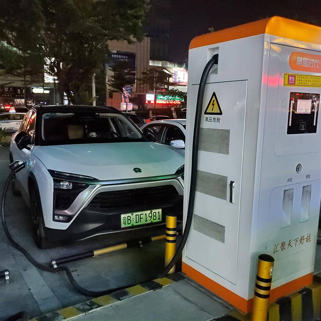

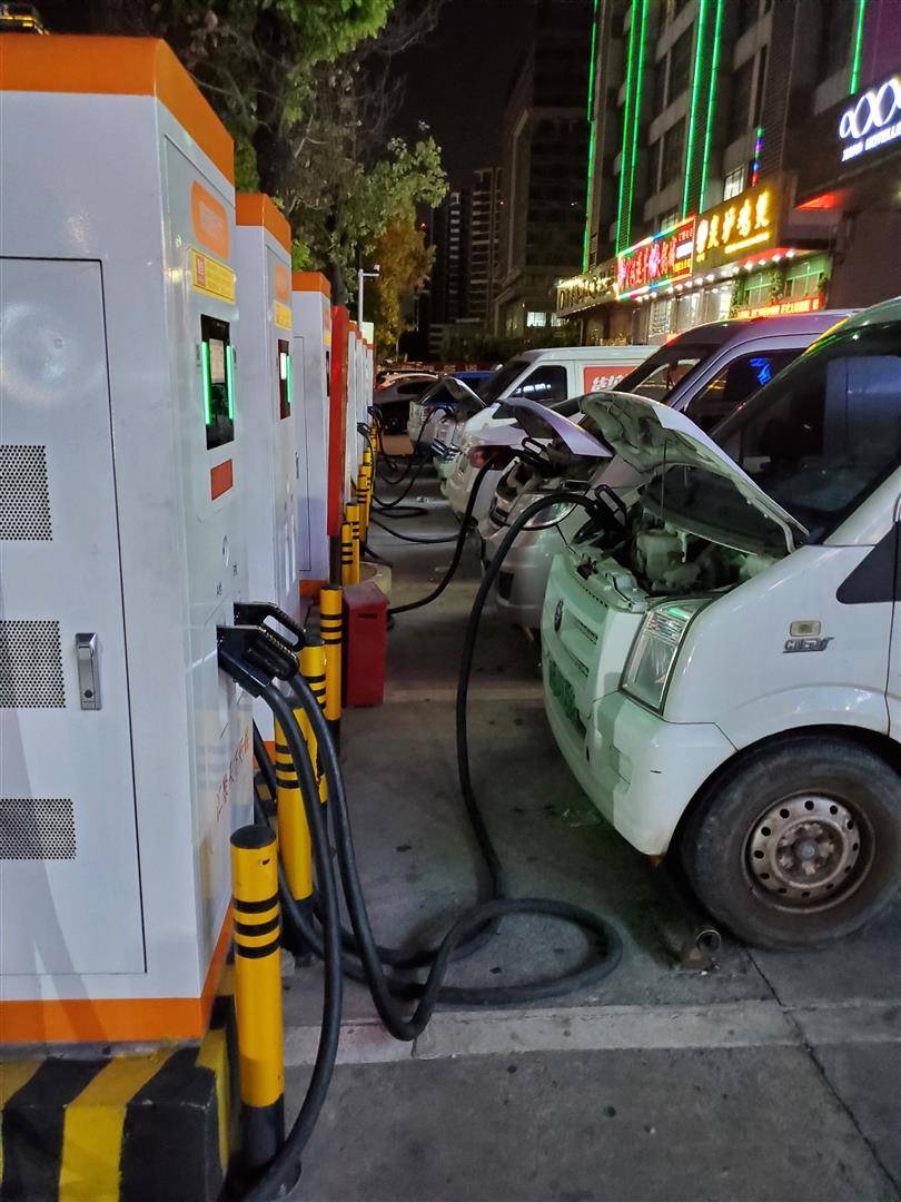

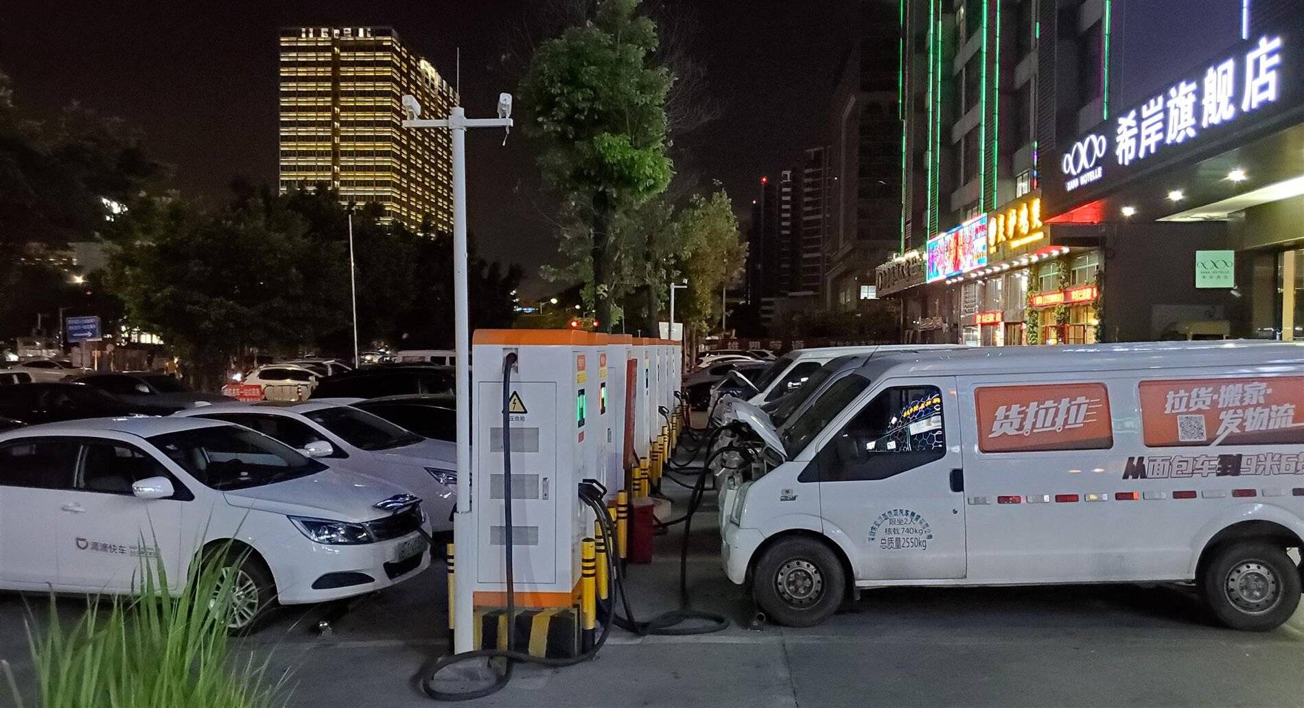

I am curious, if I get any deal from Porsche, otherwise I join these guys Sunday night in the suburbs on 160kW for USD 0.16/kWh...
