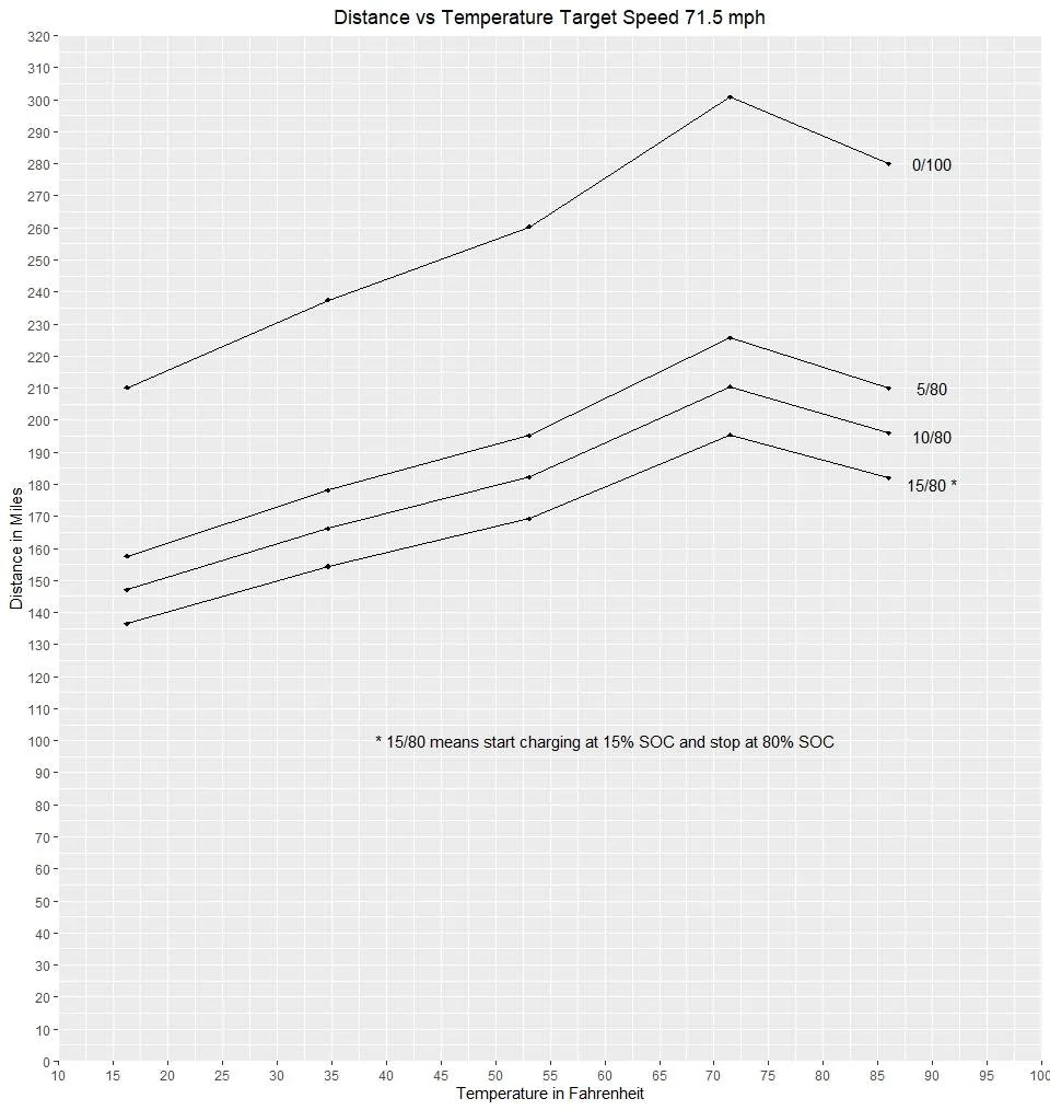

Is this test with Range, Normal or Sport mode? I assume it’s not sport.Range tests from 0-100% SOC are fine but they don't really show how far you can practically go before needing to charge when on a trip.
I had some data that when plotted out might be useful in visualizing the effective range of the Taycan and how much range is left on the table. By effective range I mean charging to 80% where the charging curve drops off and running the battery as low as 5-15%. With some planning the driver has some control over how low to run the battery down.
