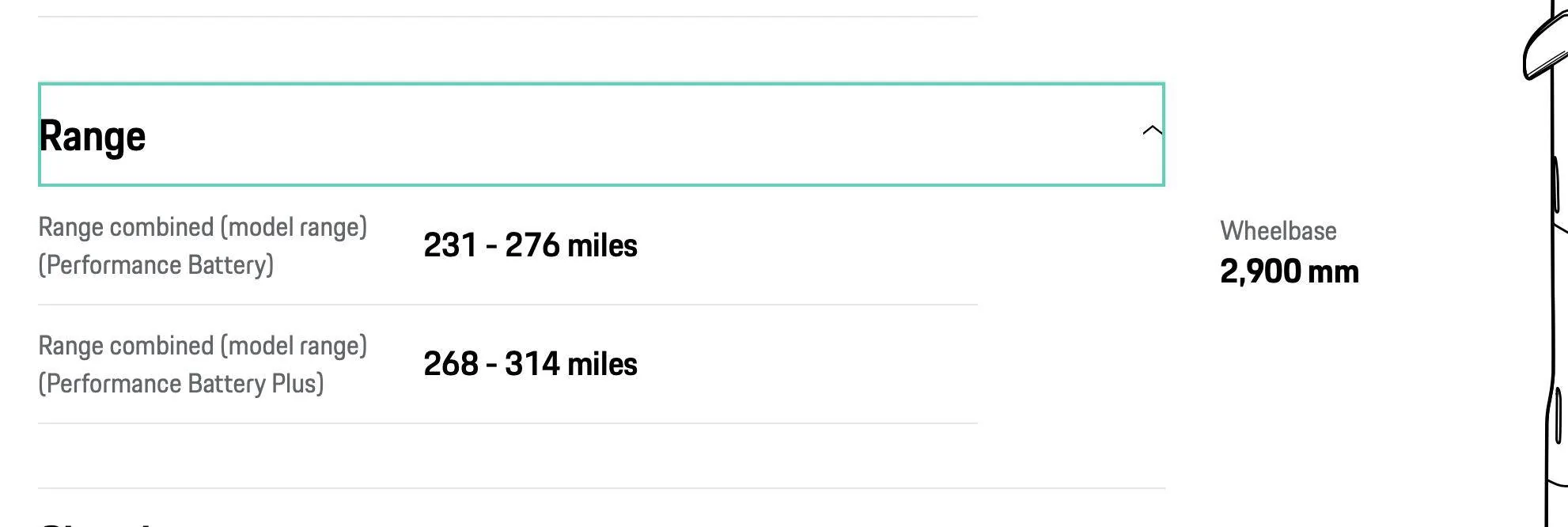

Even Porsche only claims a max of 246 miles using the very lax WLTP standard.
No they don't. Porsche claim 276 miles for the Taycan according to WLTP (314 miles with Performance Battery Plus).
Hah. Please post a link to where the quote that.
See below, 314 miles according to WLTP.
https://www.porsche.com/uk/models/taycan/taycan-models/taycan/
Porsche Taycan Taycan Range Screenshot 2023-01-22 at 15.22.08
Whether you could get those figures in the real world is a different question. I'm simply pointing out that your statement about Porsche claiming 246 miles WLTP is WRONG.

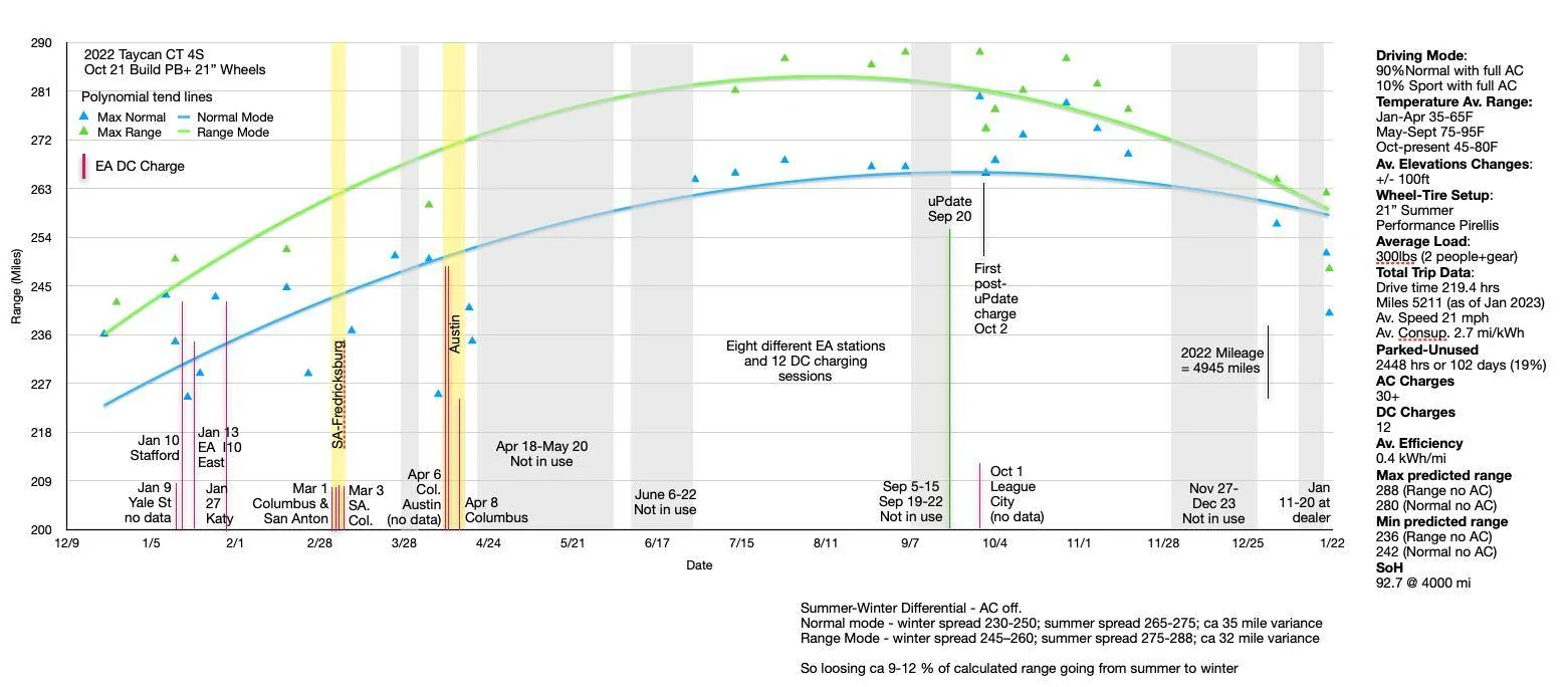

Here is some data from my car for all to compare against - for ref I basically have not changed my driving style one bit in the transition from ICE to EV and in general, have def a bit of a lead foot :) Also the vast majority of my driving to date short city runs - started out 2021 with some good long distance trips in TX but have fallen way behind in that aspect i.e. a more balanced trip history might yield even better max ranges.
Some of the text stats. on RHS of this chart are a couple months old (only updated the total mileage which is embarrassingly low but have been abroad more than a third of last year).
Note that these data are simply the 'calculated' ranges post 85% at-home charging sessions for Normal and Range mode with AC completely off. As we all know 'real world consumptive' ranges will vary typically as a function of multiple variables incl car spec (wheel-tire), driving style, terrain, climate etc. Overall I am seeing a ca. 9-12% decrease in ranges for both modes from summer to winter but overall very happy TBH with the range I am getting, esp considering the spec of the car (wheels etc).
Curves need another year plus to 'settle' but using a polynomial vs logarithmic to better represent annual high lows of summer winter etc.
PS: had been mucking with the graph annotation so may need to QC all my adds but think its pretty much up to date.
