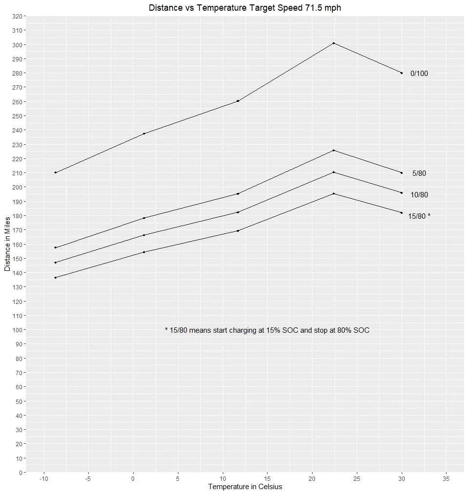

Should I read those bottom lines as “charged to 80% and then driven down to X%“? I ask because your note implies to me that was a starting soc taken to 80 and not an end soc.
Stop charging at 80% and start charging somewhere below 15%. Direction depends on whether you are starting with a low SOC or high state of charge.

From my tests. Results are very similar to those from InsideEV but done through a range temperatures.
Would be amazing to see the data split between consumption for engine and consumption for AC/heating. I know the car does not provide this info.
The dip you get over 22°C might only be because of AC usage. Does the battery get actively cooled by the BMS if it reaches 30°C?

I would like to see a graph in Celsius and miles ? .. because that's what I use as an immigrant.
Same here. After all these years (decades actually), it is still harder for me to get an intuitive feel for how hot or cold a temperature is when expressed in degrees Fahrenheit (vs. Celsius) than it is to get a feel for distance in miles (vs kilometers).
Here you are.
Porsche Taycan Taycan Effective Range Effective Range Mixed

My opinion is that the word "calculated" is the problem.
It could be. I know that the car read 56% SoC when I got back home, and I know the total distance traveled was 61.2 miles. But I didn't look before departing to see what my initial SoC was. It should've been 80%, but I have observed that the car sometimes over-charges by a point or two.
If I left at 82.49% and got home at 55.50%, that would mean I used 26.99% instead of the 24% I'd been assuming. That would lower my calculated range to 227 miles. Which is close enough to your number that any difference could be explained by driving style, whether it was sunny, etc.
