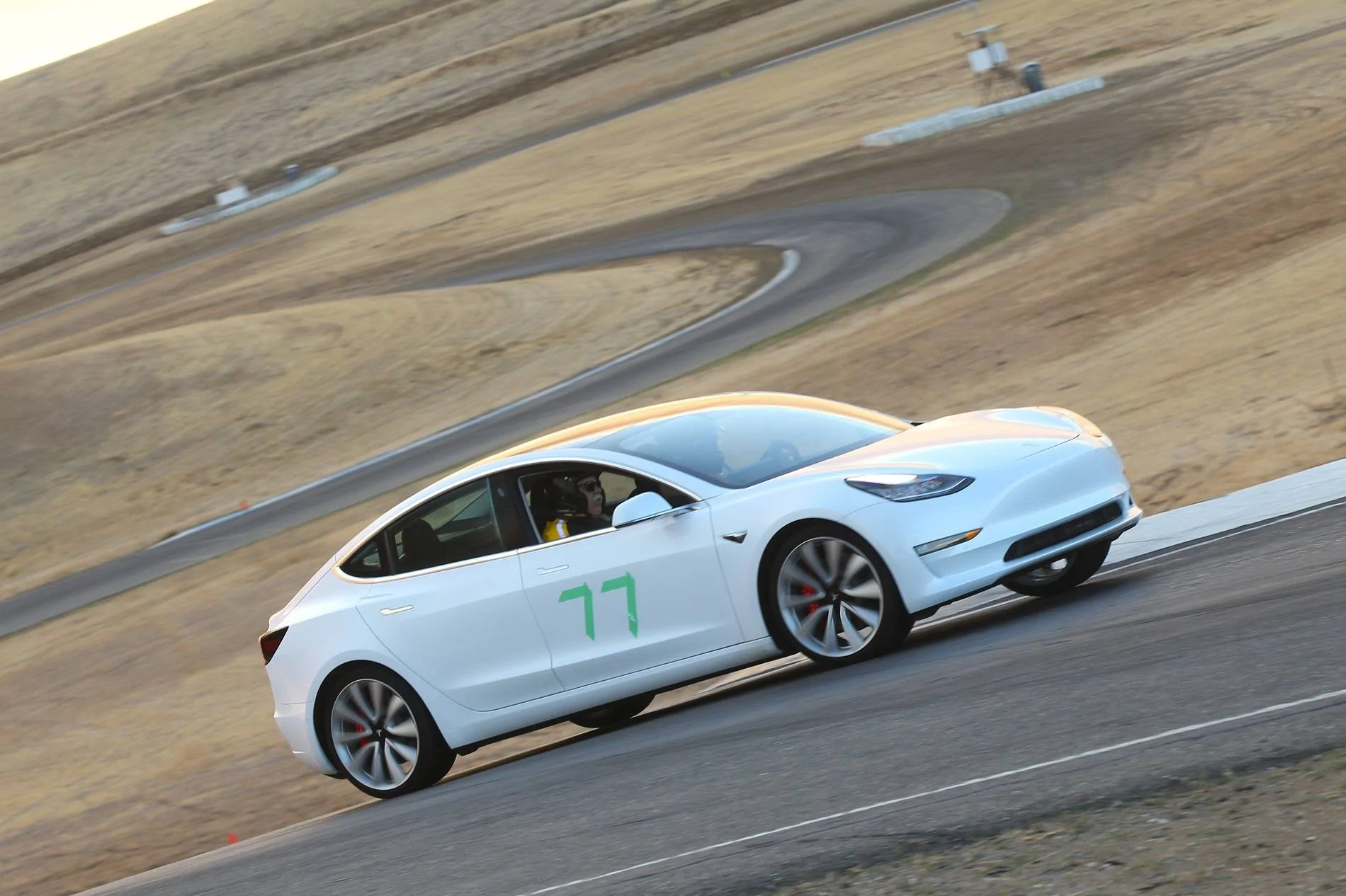

when I drove my Model 3 performance on track - I found it very very difficult to predict the amount of weight transfer when lifting off the throttle due to a very very variable amount of regen from lap to lap…with the Taycan it's very predictable…
I agree porsche shoudl support one pedal driving for street use, but there does need to be an option to defeat it - they have chosen to optimize for no regen via accelerator pedal for the predictability of it…
there is always weight transfer agree - for any change in vehicle momentum - but the amount and magnitude should be predictable and I found it very very unpredictable and highly variable in my Model 3 performance - but as with all things YMMV…
