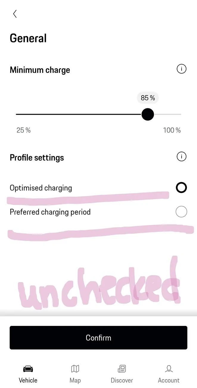

I am not sure if it is different in your country, but I setup a charging profile for home. I put the bar at 85%. I believe in the car I had to unselected an option and these are unselected on my app, but I know I had the times set at one point. I just know with these selected I was blasting the battery to 100% every time by mistake. Hopefully, this works for you.

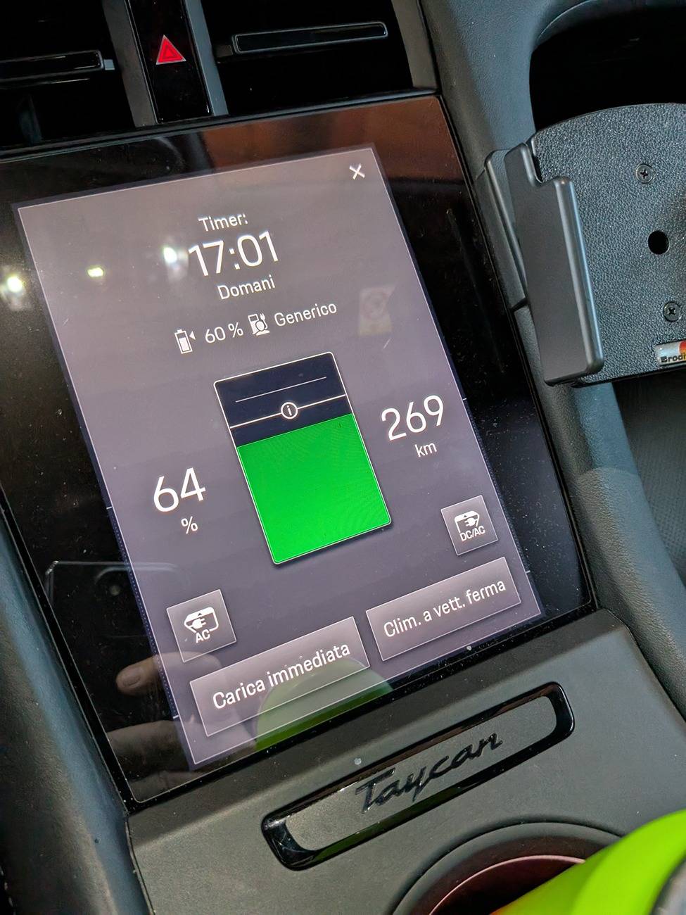

While watching some videos on YouTube, I came across a Swiss user with a Taycan J1.1. At one point, while sitting in the car and talking about its features, the battery screen appeared, showing the option to adjust the charging limit using a slider, just like in the new model.
Did I see it wrong? Does this function actually exist? Is it part of a software update?

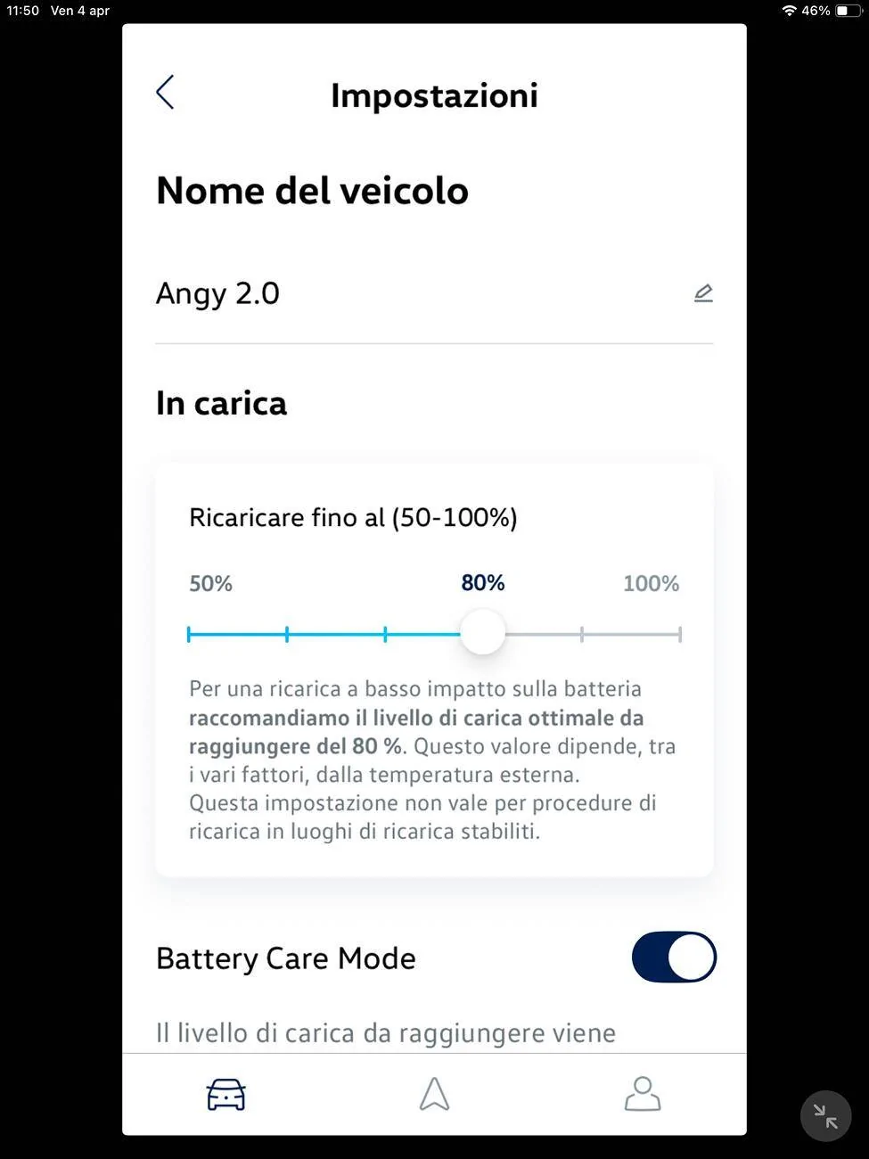

But of course, this feature — the slider to quickly set the maximum charge percentage — is also available in the app. Coming from two previous Teslas, it’s something very, very intuitive. It’s even present in our other car from the group, an ID.3.
You eventually get used to the profile system, but trust me, there are many people who don’t even know what it is and always charge to 100%.
“I don’t think it’s a technical limitation, but a deliberate choice.”

No, the slider are directly connected with PCM of the car , no to the charger equipment.

we don't have that screen on iPhone...
Sure, not at the moment, of course, but if the feature does become available, this is how it should work — even on the app.
Let’s hope it comes soon.
