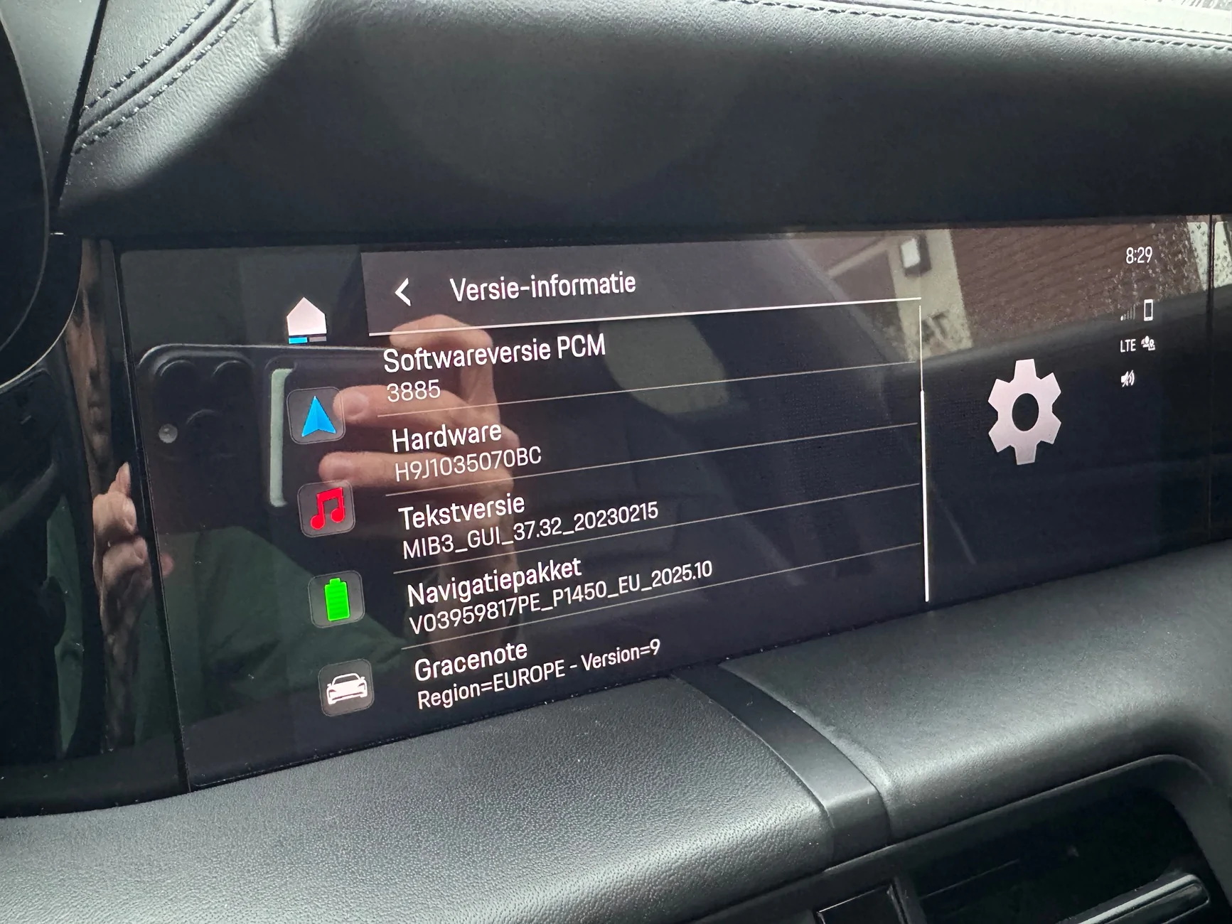

3885 is the latest, 3882 is also acceptable. So 38 is the version to look for
Thanks Jasper, can you please tell me (if it's not too much trouble) the exact full version you read on your PCM screen, is it e.g. 6.xx.3885 ?
And I see you have a 4S MY23, so it means you have also the Android Auto icon, but are they all grey ? or in color ?
Sorry for all the questions, it's just so I can add one more documented fact to the Porsche guys.
Jasper4S
Jasper
Oct 5, 2022
1,488
2,181
Netherlands
note the 3885 and the color icons

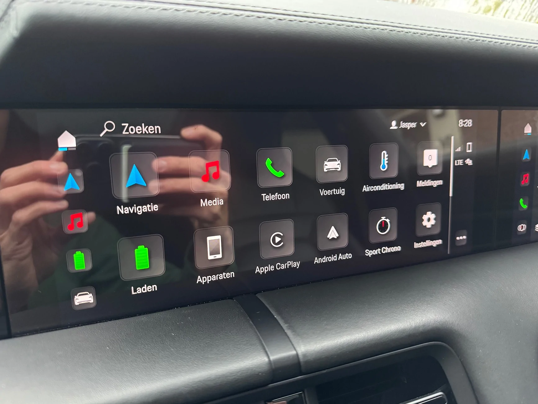

many thanks Jasper, may I ask if you have a picture of how the "icons" look like on your main screen too please ? (where the Apple carplay & Android auto icons sit)
GUI 3 points to grey icons, but I could have gotten that wrong.
Sorry to bug you all :-/
I could be wrong, but Android Auto and Carplay apps have color when a phone is connected. I never use those apps
Porsche Taycan PCM updates on the J1.1 IMG_0728
