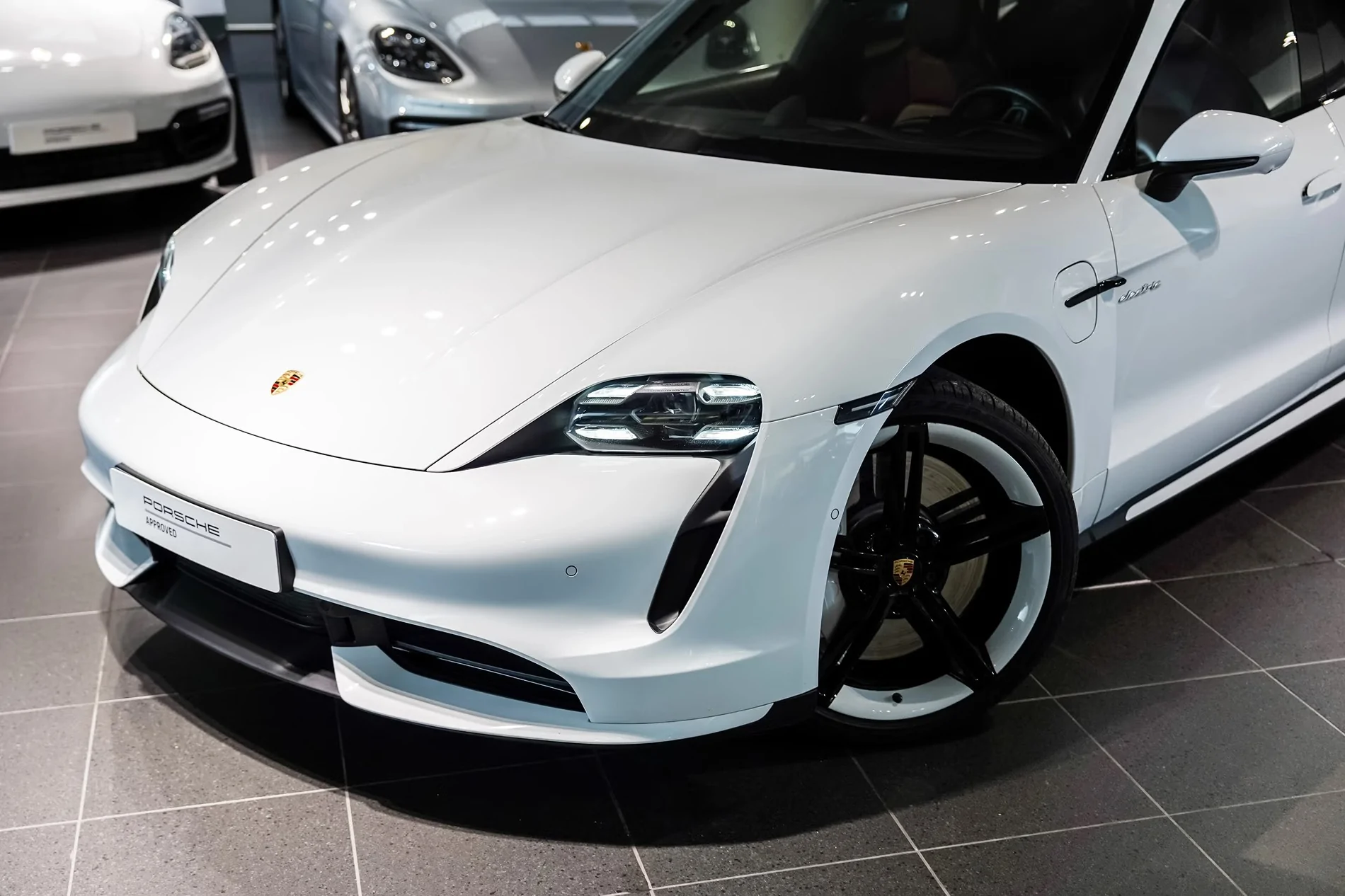

Show us the headlights and we know if you have j1.1 or j1.2. 38xx is j1.1 and j1.2 is in 4xxx. Looking at the age yours is def. A j1.1. J1.2 is from 2024 and later.

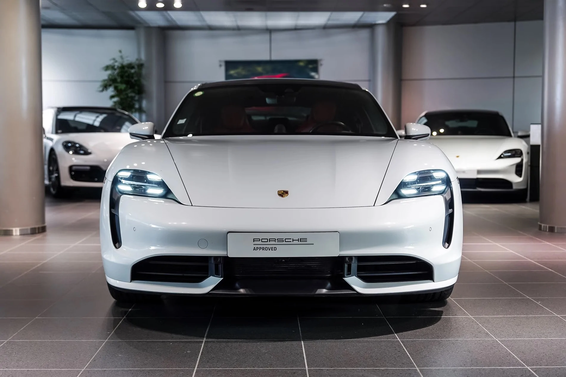

Yep! I can't open the rar on iphone. Can you share a photo here? Also good for other readers with the same question. Photo doesn't need to be big. It should be an easy spot to see the acc option and generation of taycan

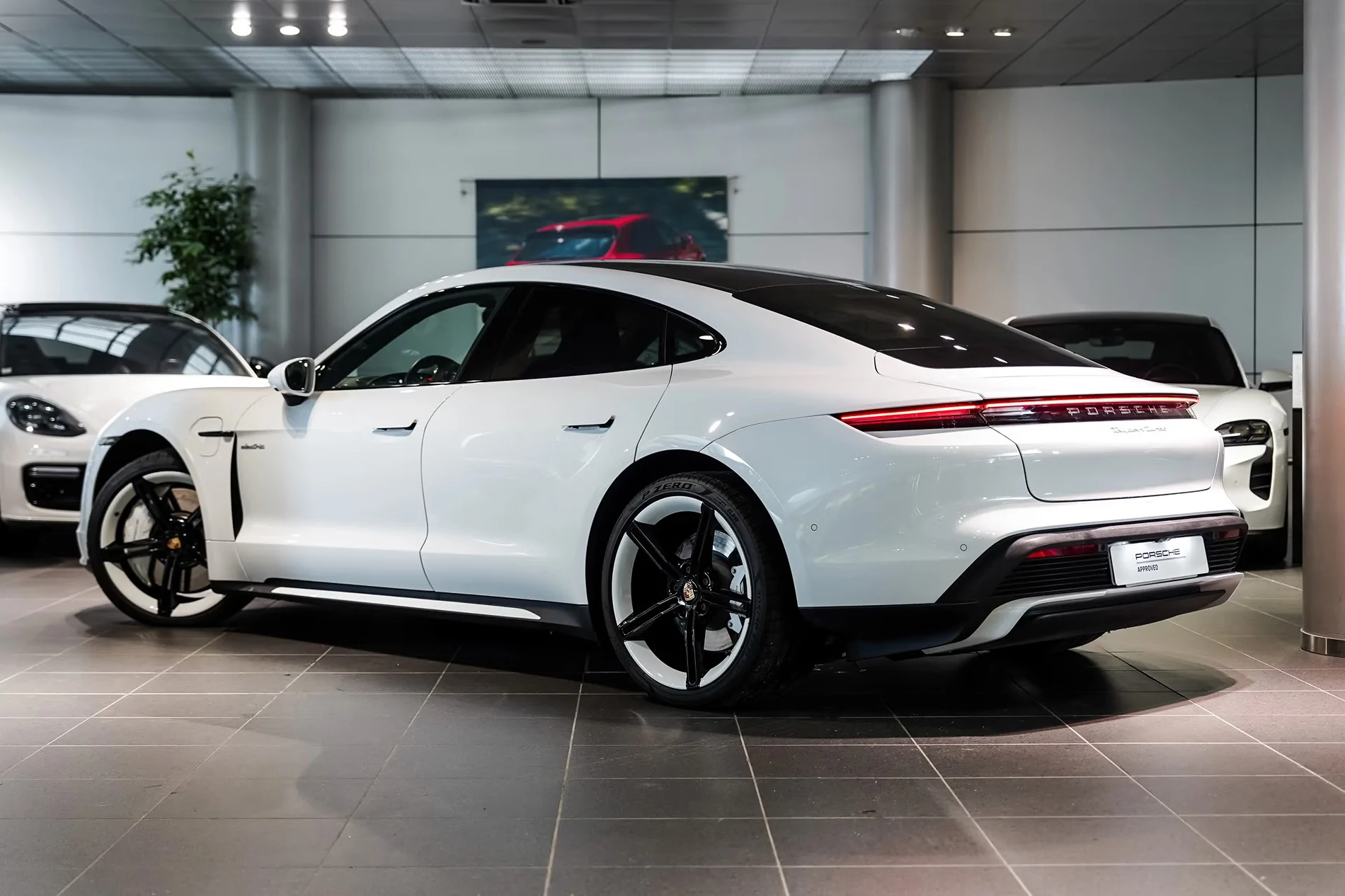

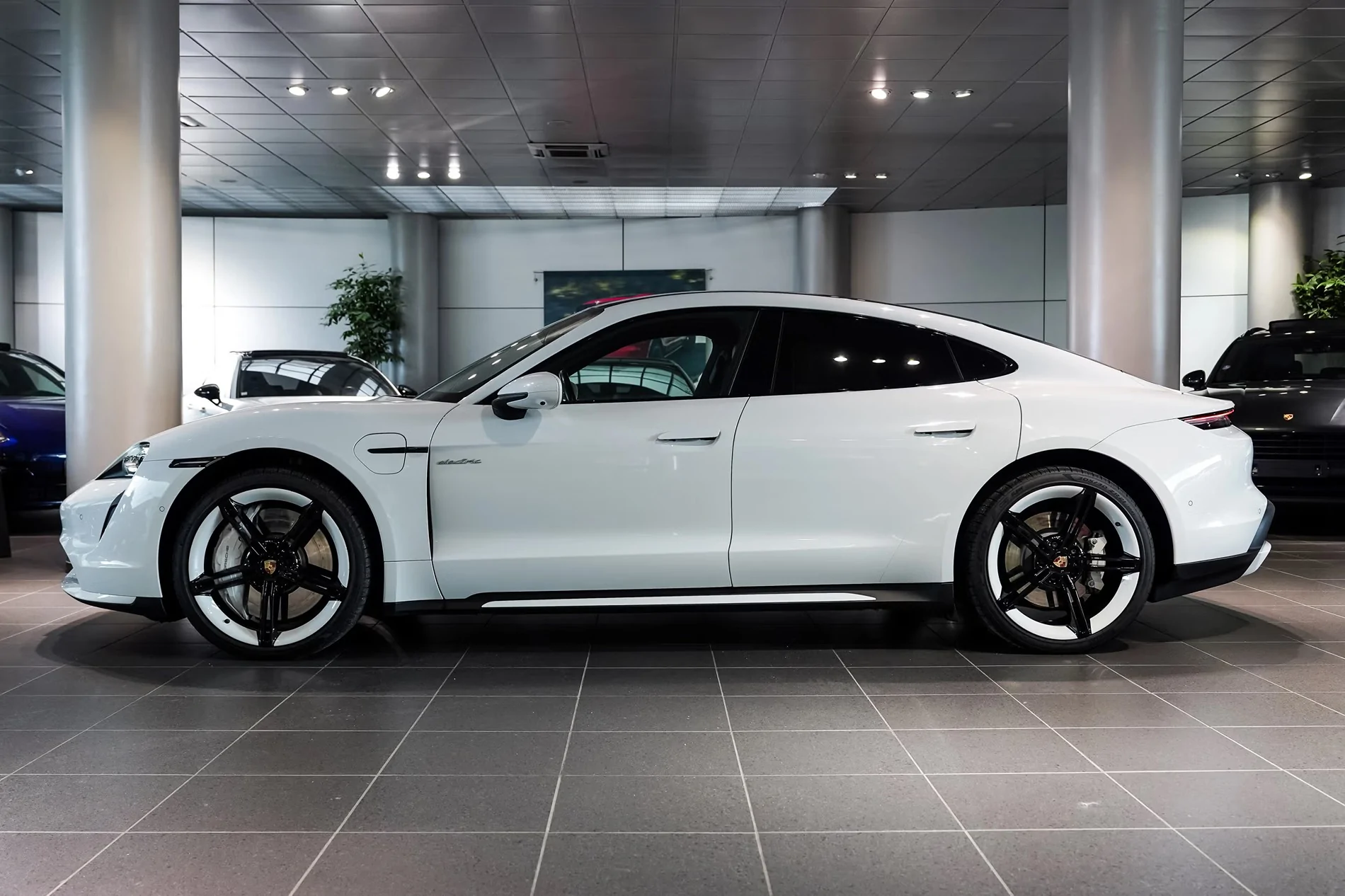

Pictures : yes sure, I'm not sure which bumper you mean (front or rear) so I'm putting all pictures I have right now

You have a 1.1 WITHOUT Acc. I don't see the Acc dome in the area beneath the license plate. Stunning car, congrats!

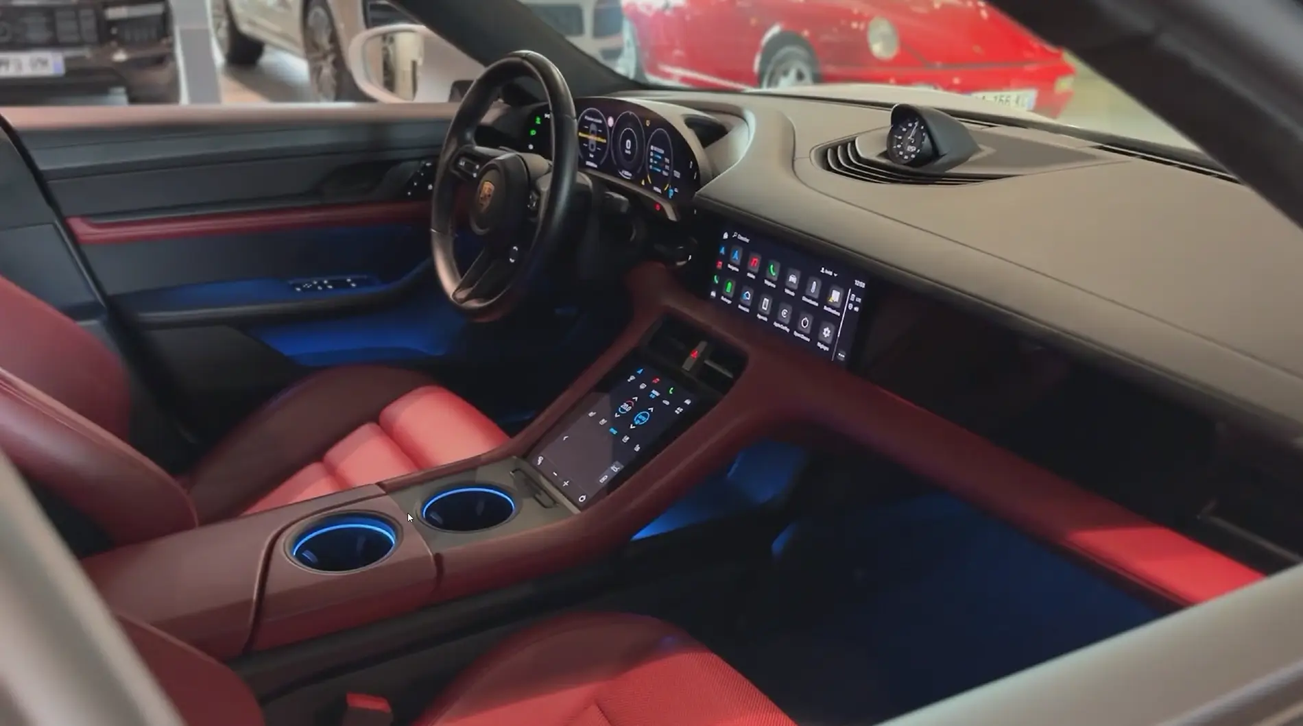

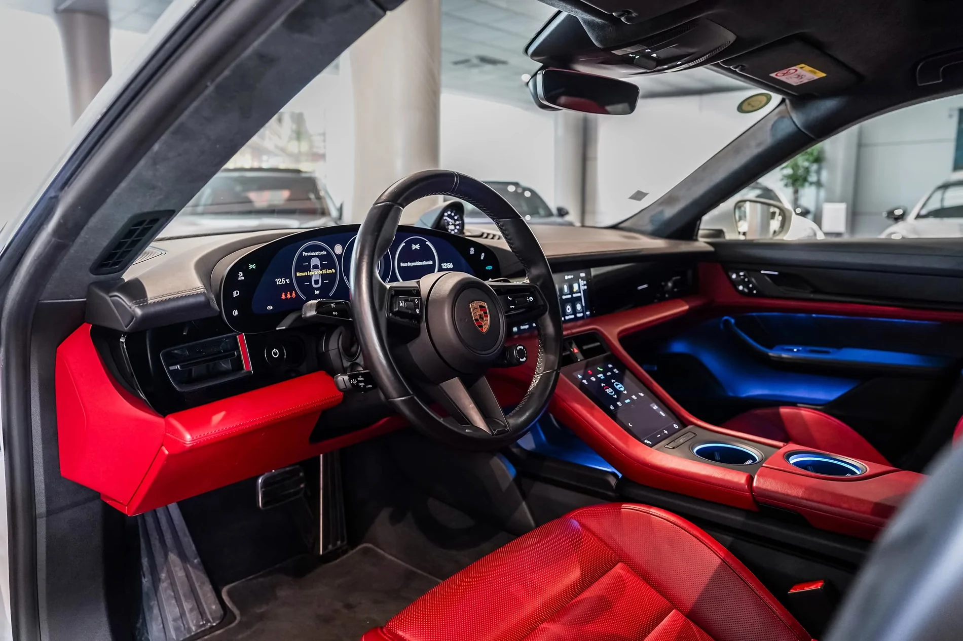

Coloured icons is the obvious one. Do you have sale pictures of the inside? Maybe we can spot the update on the screens already and you can relax
I have only this one right now, not sure if it's sufficient to be sure
