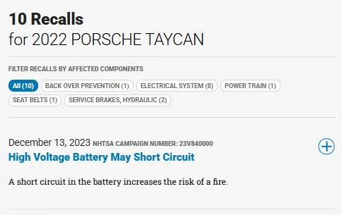

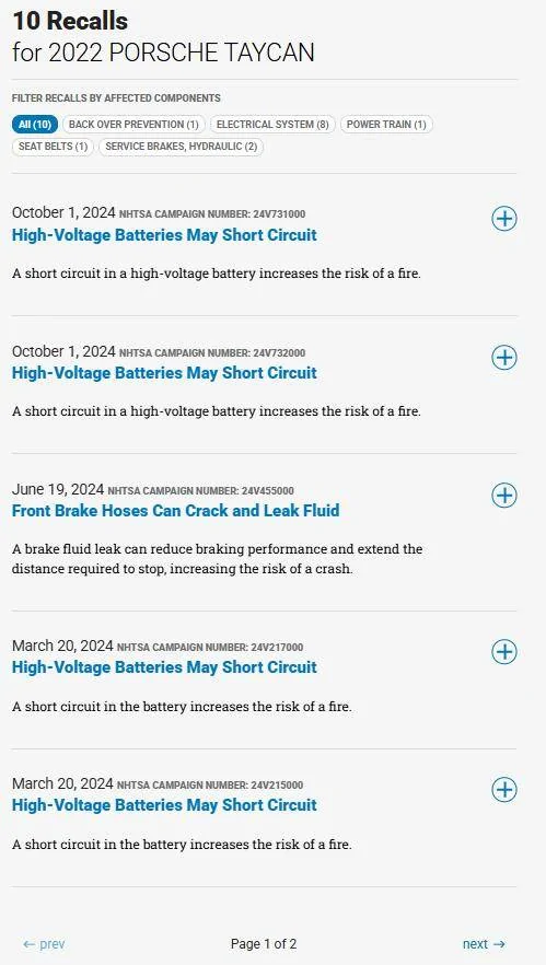

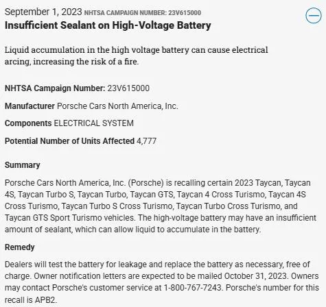

Given the service and test "recalls" there is evidently a problem with some battery seals. I seem to remember a whole series of cars from certain production dates needing to have their battery seals checked - mine may even have been one of them.
I can imagine cars imported to Thailand from England from thet series may/will have missed out on those checks and if the sealant or application of it is compromised this sort of problem may happen driving through puddles or floods.
Difficult to imagine rainwater getting into the battery through that lid seal whilst parked on a rainy day even if compromised.

I've no doubt he's had to repair some number of batteries, but the recall Tooney linked makes me think what this person is seeing is likely that defect and not a pervasive problem. . I do think his tone makes it sound way worse than it likely is.

He did some repairs on '23 Taycans which did have the recall about failing sealant so no surprises there.
