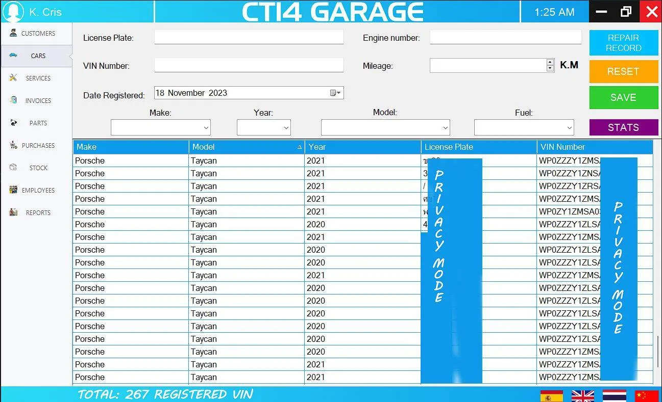

First of all, we've repaired way more than 5 batteries
Porsche Taycan "Taycan lets you drive with shorted out battery modules" 1744950904651-3j
This is the number of Taycan VINs registered in my company's ERP. 267 of them. Most of those 267 have had a battery repair. Last year (2024) alone we repaired 183 batteries. And sold 1567 individual modules. At my shop 2 lifts are exclusively dedicated to Porsche Taycan battery repairs ONLY! (I have another 3 lifts for any other car):
Porsche Taycan "Taycan lets you drive with shorted out battery modules" 1744951127980-qm

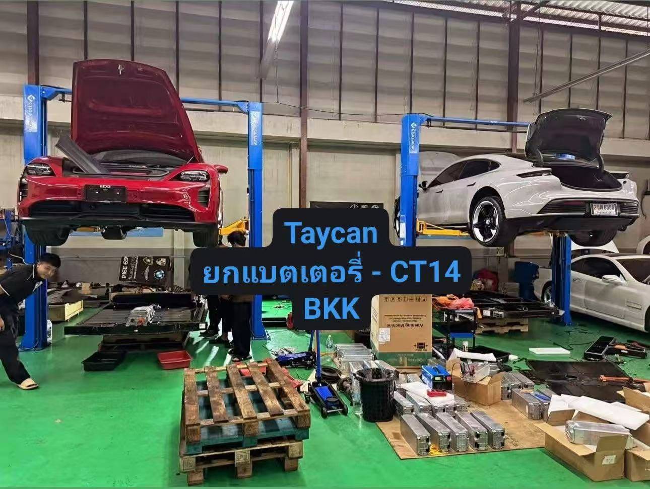

Taycan is an EXTREMELY popular and well selling model in Thailand. With over 6,000 units sold in the country most of them are unofficial imports, imported by private person and unofficial dealers here in Thailand which also import from Porsche dealers in the UK or Cyprus. These cars have no official Porsche warranty and are thus instead repaired at my shop.
Every week we repair on average 3 batteries, every single week. Not counting those that we help repair remotely.
Almost everyday I have Porsche HVE certified dealer technicians who work at the dealer asking me questions through Facebook Messenger. Because when they encounter a problem repairing a Taycan I reply faster, better than Porsche engineers and for free. Same way I have made many posts on the other forum showing how to repair many things for free.

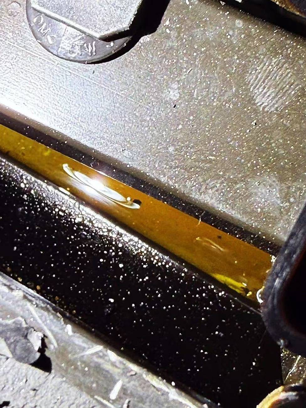

Hence, discussing why the battery has water inside is a f'ing waste of time and irrelevant to the post(read the post title again, it's not about water inside the battery).

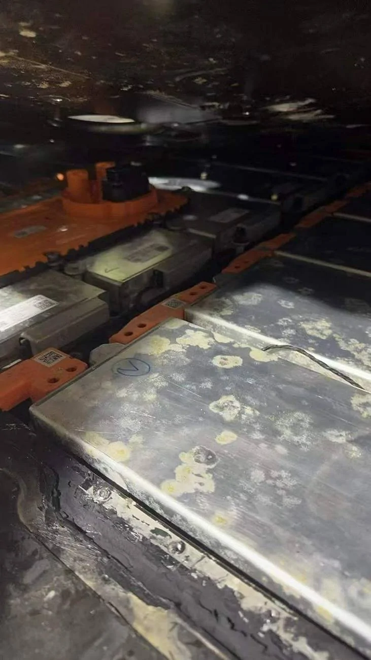

Most of them have water inside because they have been improperly repaired before by someone else. I have also seen batteries never opened before with a failed factory seal. But those cars could well belong to the recall campaign for the defective seal. So I'm not here to argue about this.
It is beyond the point, the POINT is that: ANY TAYCAN FROM THE FIRST UNIT SOLD TO THE LAST ONE WILL ALLOW YOU TO DRIVE WITH SHORTED OUT MODULES.

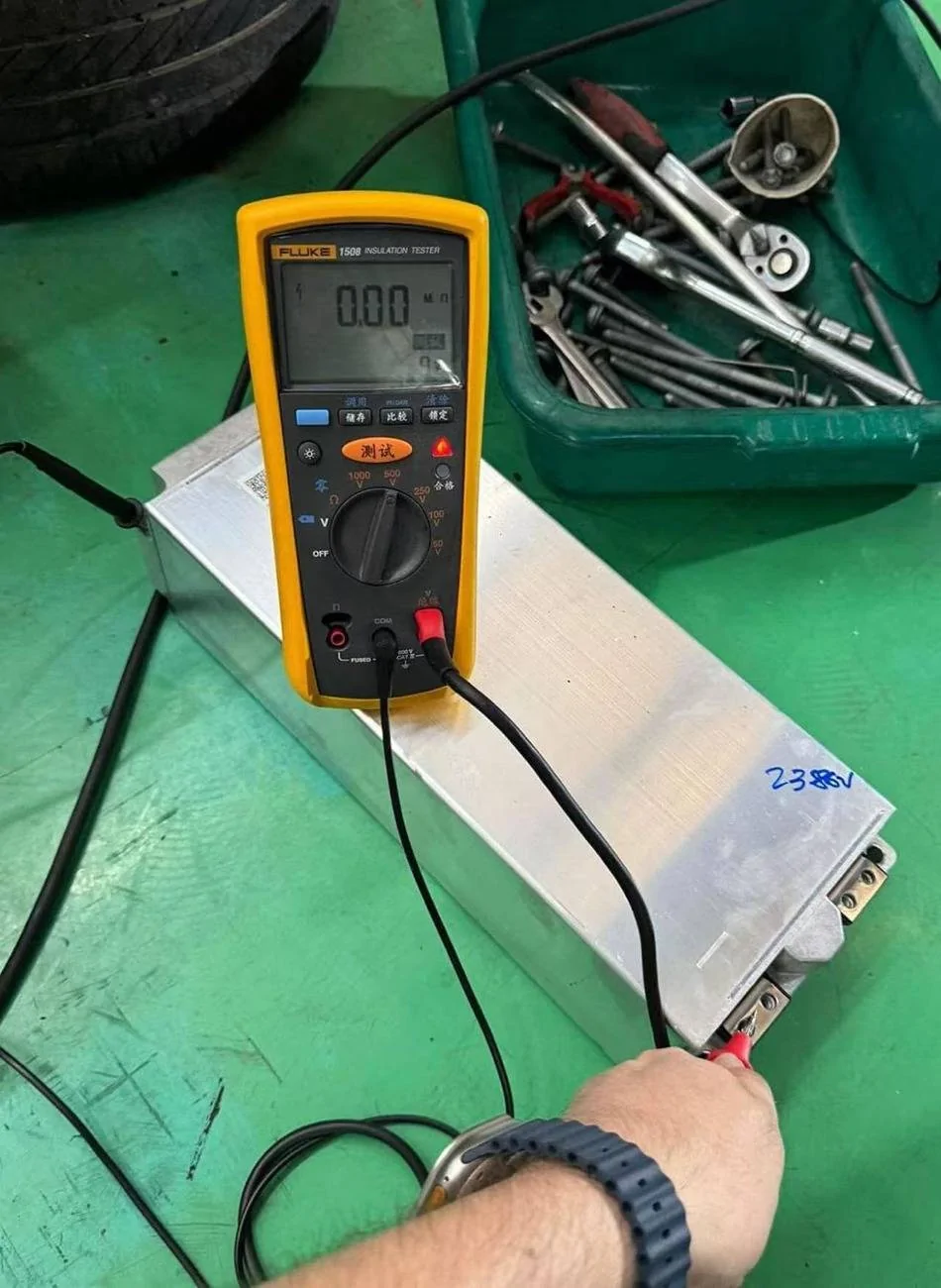

The car on the original post, came to the shop DRIVING, CHARGING BOTH DC AND DC. And the battery frame was LIVE while driving. BMS only showed a Yellow Electrical System Fault which sometimes turned RED but nevertheless you could still DRIVE.
Porsche Taycan "Taycan lets you drive with shorted out battery modules" f753d66e8c5e3b8ebb03d93e91a8d55
Porsche Taycan "Taycan lets you drive with shorted out battery modules" ff128bd111277bf22bd35a55d1623a1
Porsche Taycan "Taycan lets you drive with shorted out battery modules" c6fab344afa443a88c164a091271925
As you can see this a FULLY SHORTED removed module from that battery. The BMS allowed you to DRIVE and CHARGE the car in this condition. This problem is still not fixed.
Somebody said that EVSE standard wouldn't allow you to charge if there was iso fault. In Thailand there is only 1 type of DC chargers that will refuse to charge when there is an iso problem. That is the DC chargers by PTT Gas stations. (And this is the charger itself not allowing the charge to go on due to iso, rather than the car itself refusing the charge)
Any other DC charger and AC charger (including Porsche mobile charger). That I have tried will charge as normal EVEN when the battery frame is LIVE.
Now to be honest, I have no idea what the theory behind EVSE charging is as somebody else said. But frankly I don't need to know the theory because I know the reality very well as I have done my own experiments and the car charges as normal with LIVE voltage on the battery frame.
This is DANGEROUS, and Chinese EVs as shit as they are and as shit as they drive. Electrically they are far far superior, and their BMS is extremely good and extremely rapid at detecting iso problems.
Hope this post clears it all up for you guys. Stop focusing on why there was water inside the battery, that is irrelevant to this issue.
