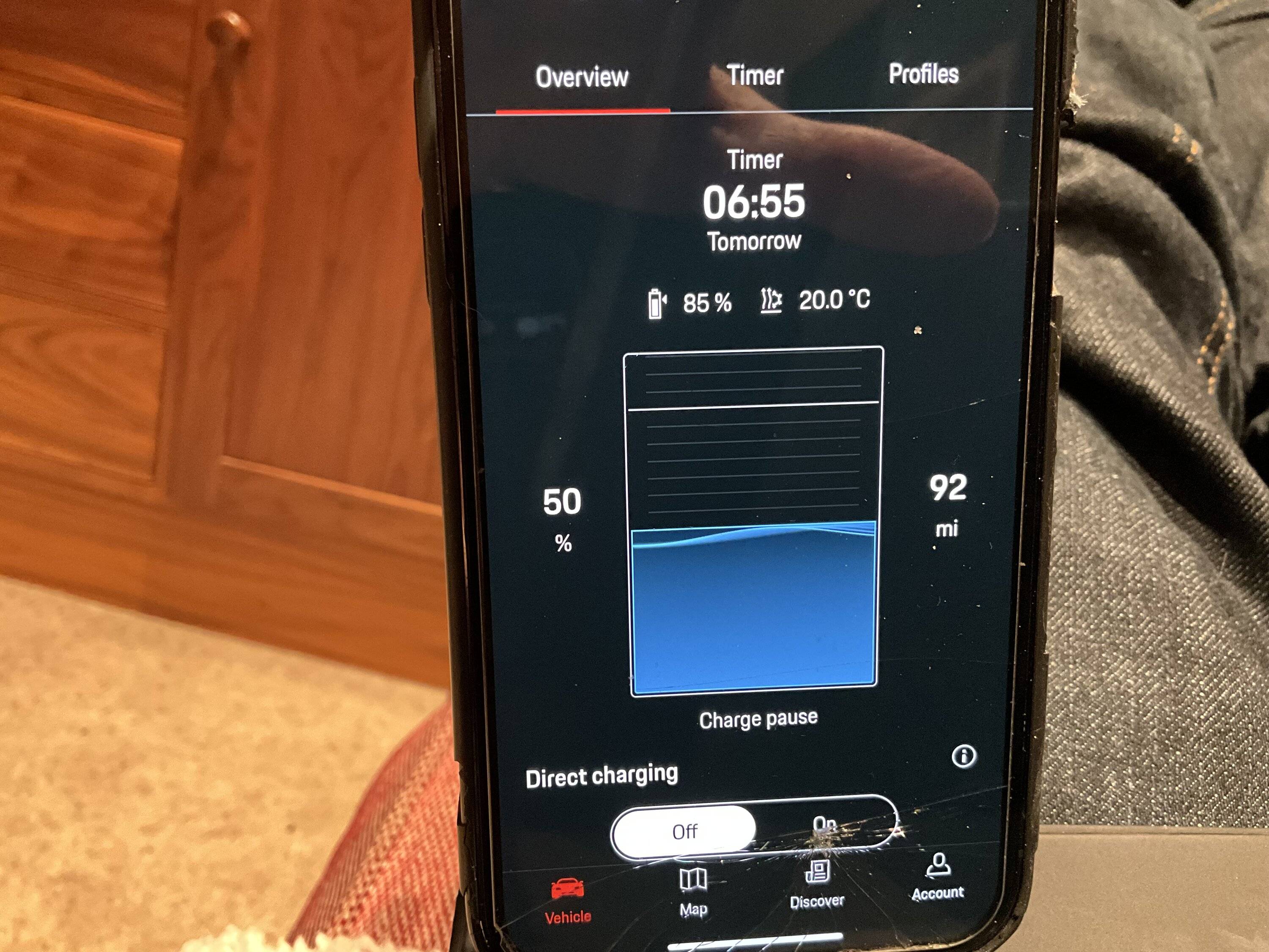

Well I have the Timer set to 85% battery for 06:55 tomorrow morning - The car is currently at 50% charge. Charging is currently ‘paused’, direct charging is ‘off’. No profiles are active.
Does the car know that it can get 22kw and is therefore waiting until 05:00 to start charging (at the max rate) or have I just set something up incorrectly?

@Sidicks, yes that is correct behavior when you use a Timer and the car knows it has plenty of time to get you to the target, so it goes into Pause (Blue), and then gently charges it in short sprints. I really like that functionality. I only have 11kW and I plug in 9 hours before the Timer target time and 85% setting and it goes into Pause mode after detecting and calculating what is connected. Never failed me yet to be at 85% by the departure time.
