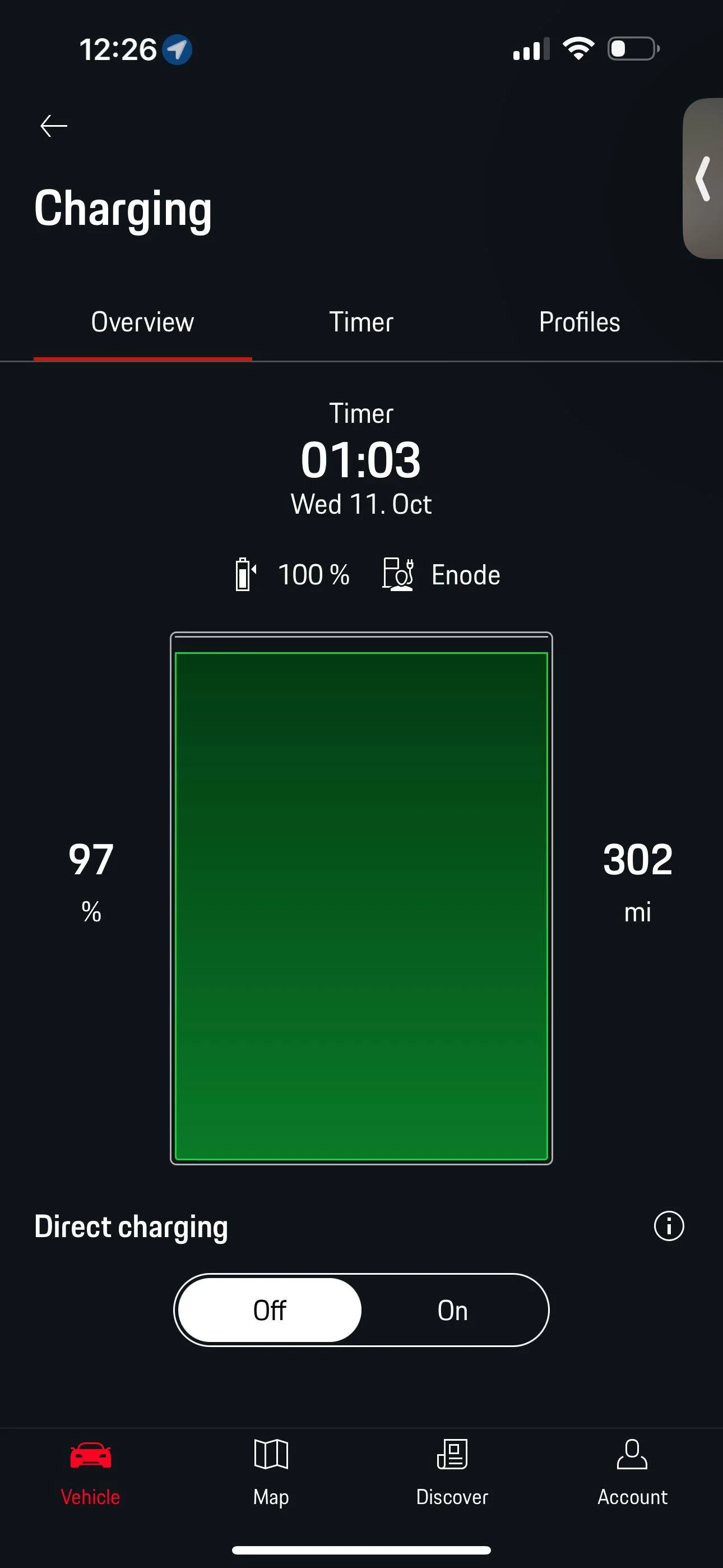

Has anyone ever seen a range of 313 miles?
There have been a few people on this forum reporting that kind of range but it is extremely rare. Most people seem to get somewhere around 220-270.

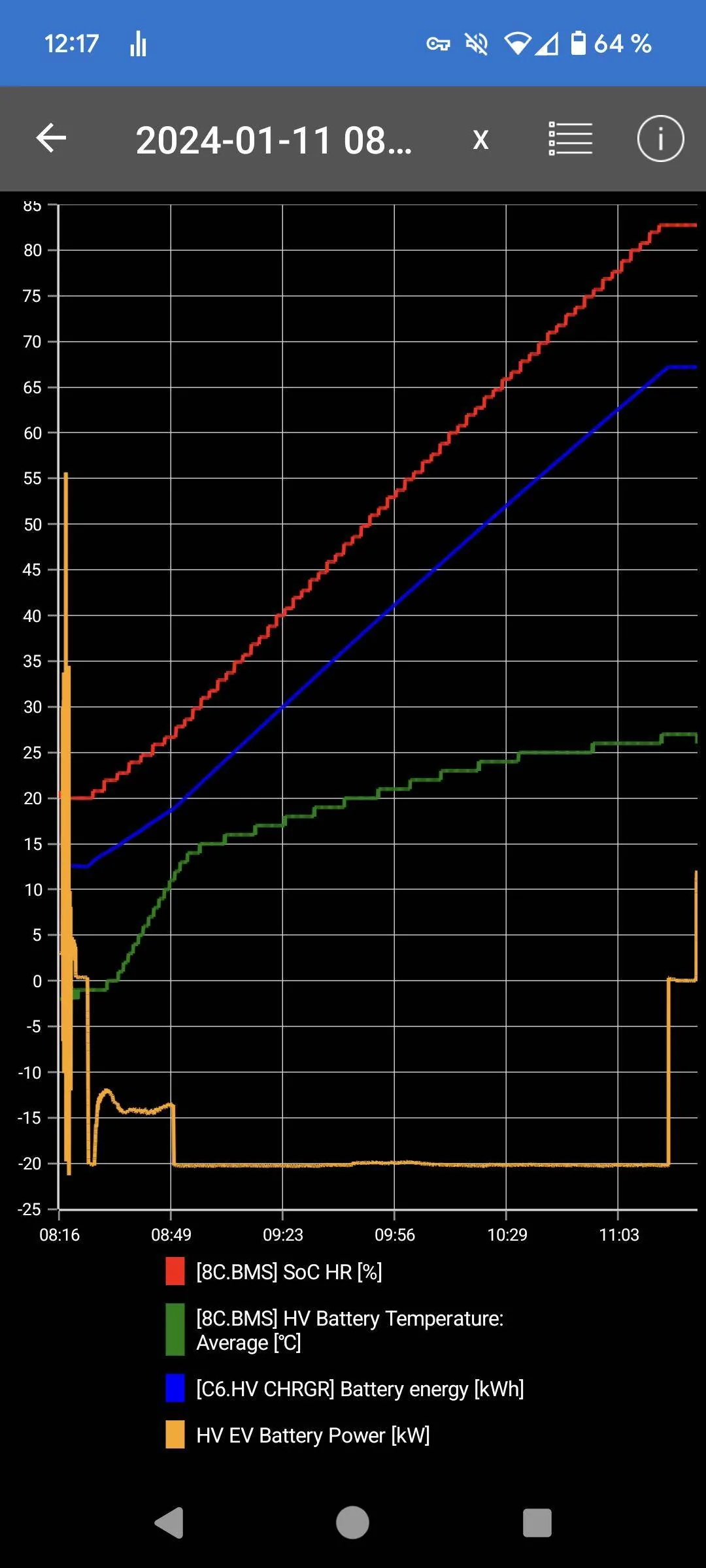

just monitored a charge from 18 to 85% on a AC 22kW.
needed 62.4 kWh, only 54.5 according to Car Scanner: that’s about 12.5% loss
one point however: it was really cold and batt. temp. was below 0C/30F when started.
