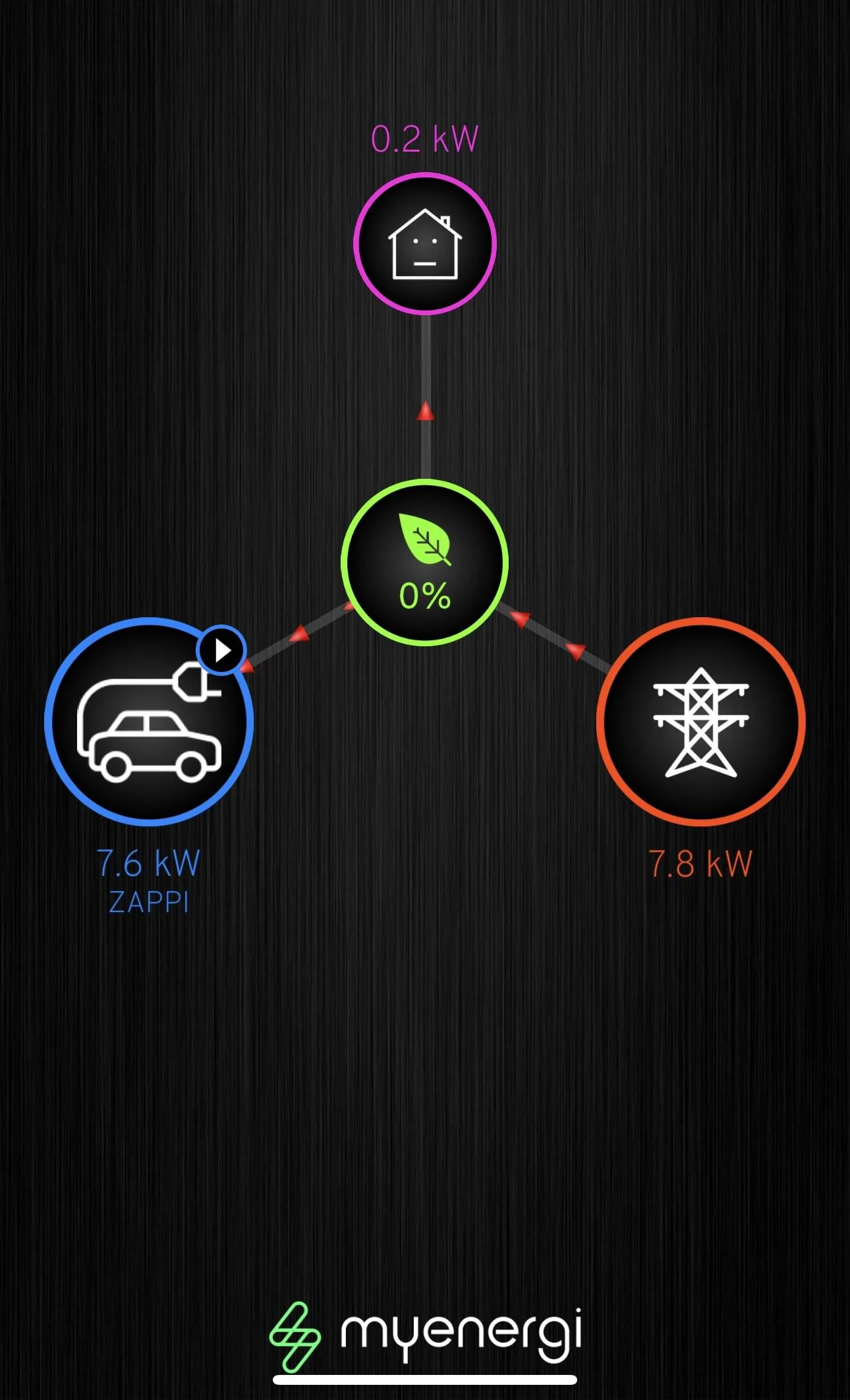

I had a new Zappi 7kW EVSE installed today and I’m seeing a 9.2% charging loss.
Charger output …

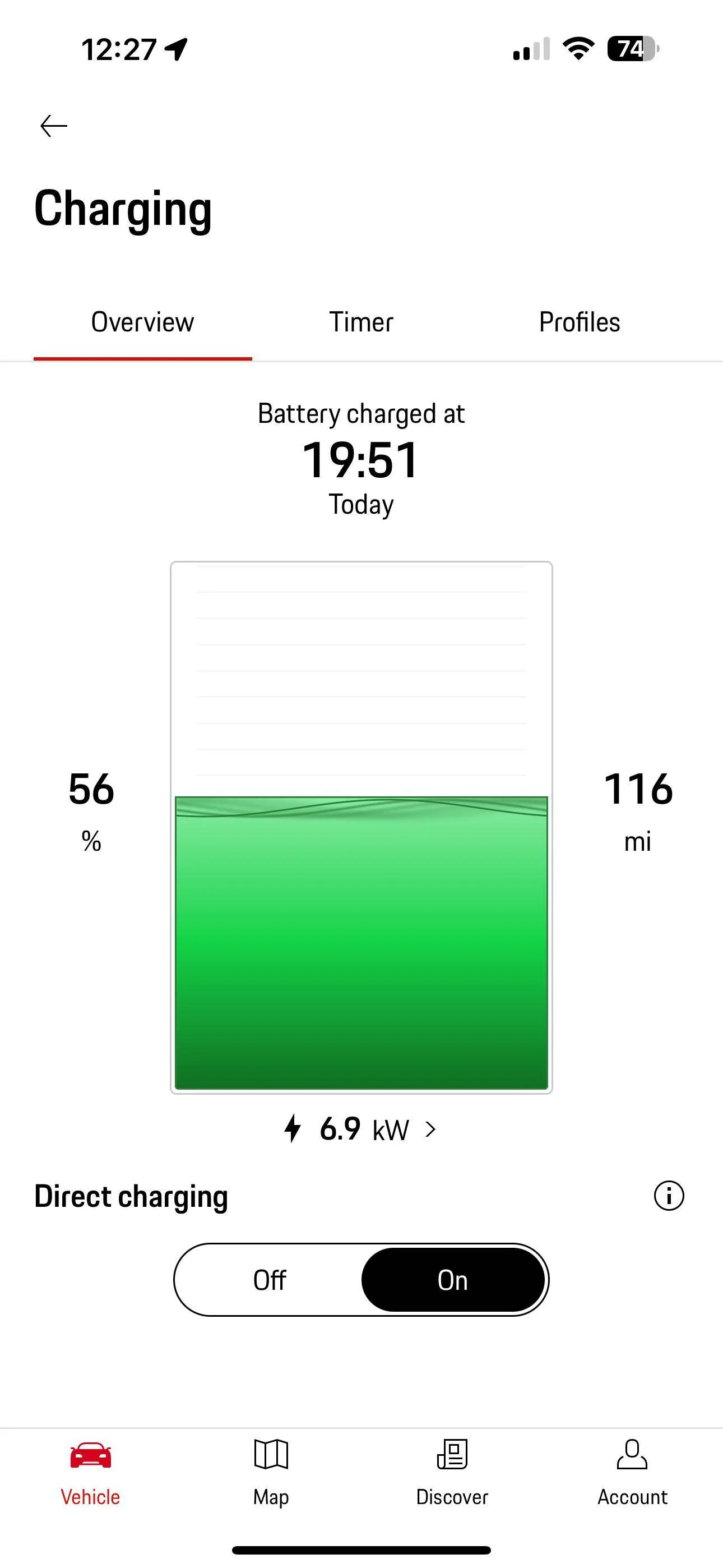

… then at the Taycan battery …

Then look at Polestar 17.7% loss!
