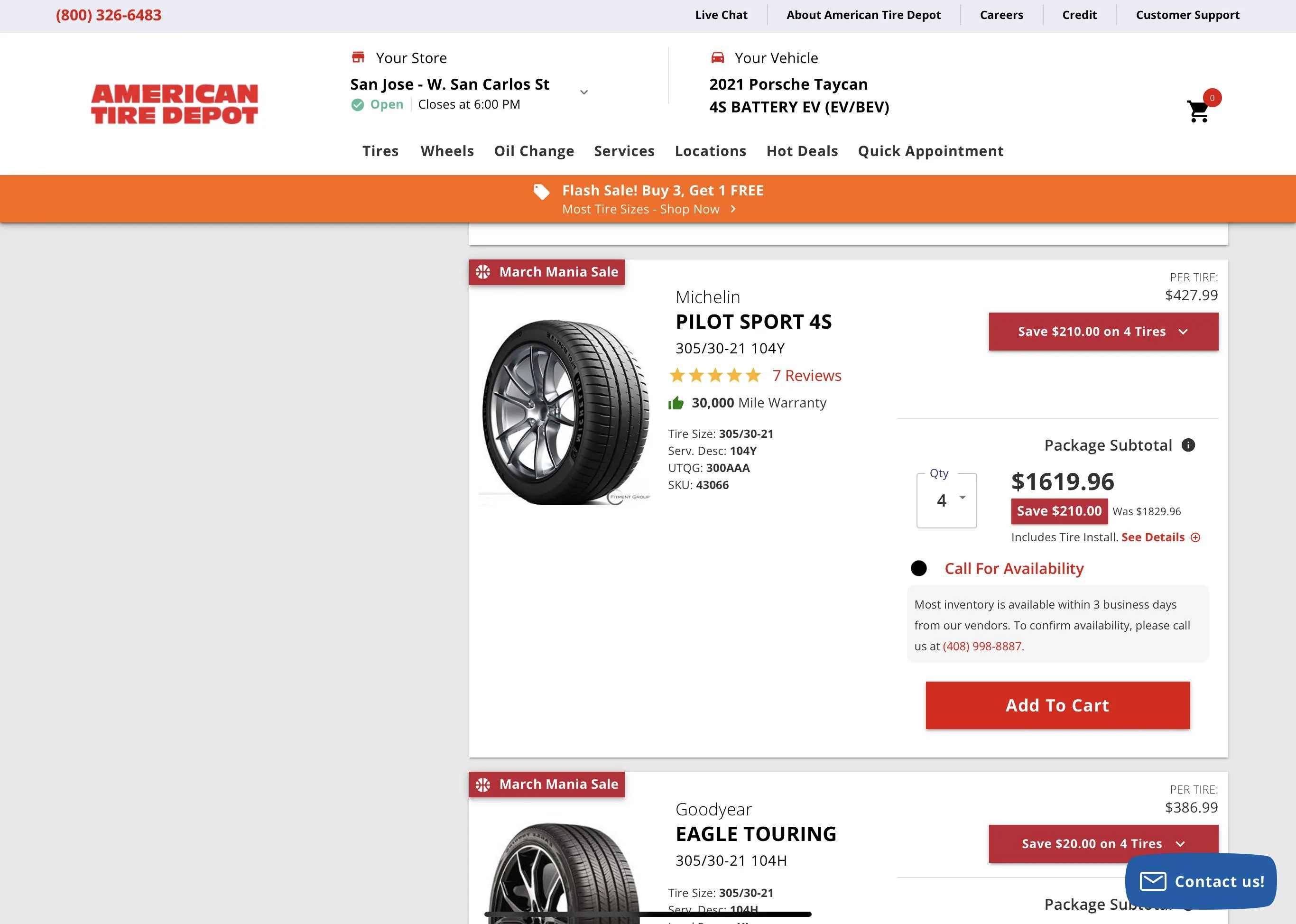

I'm on the Michelin website, and there are only two variants of the Pilot Sport 4S that come in 305/30/ZR21. One for the 911, and one for which I believe is a tire made for the Mercedes AMG GT.
I guess if it is good for an AMG, it would work just fine for a Taycan as long as the load rating is ok. But they might also be for one of the Mercedes SUV and that is heavy.

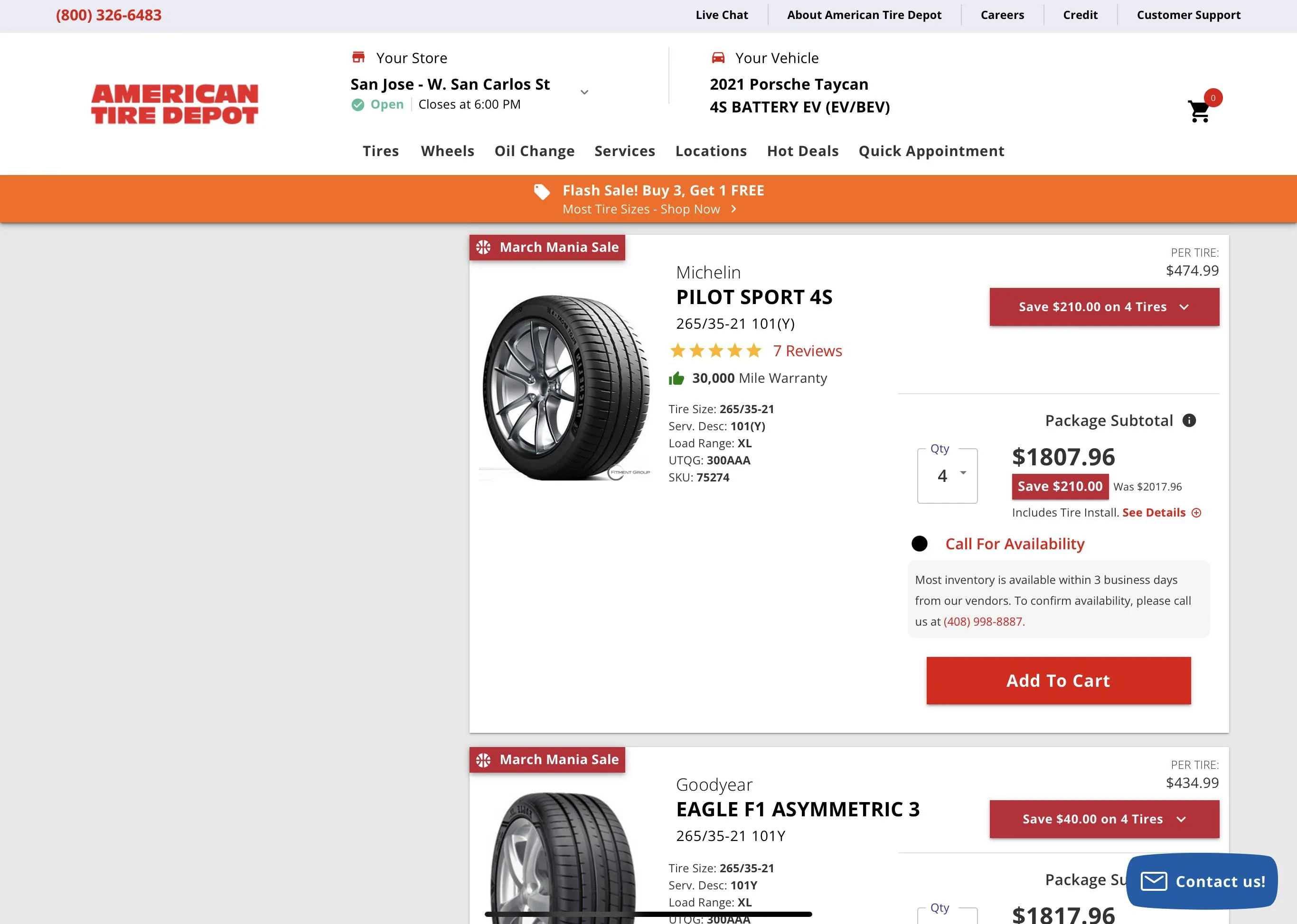

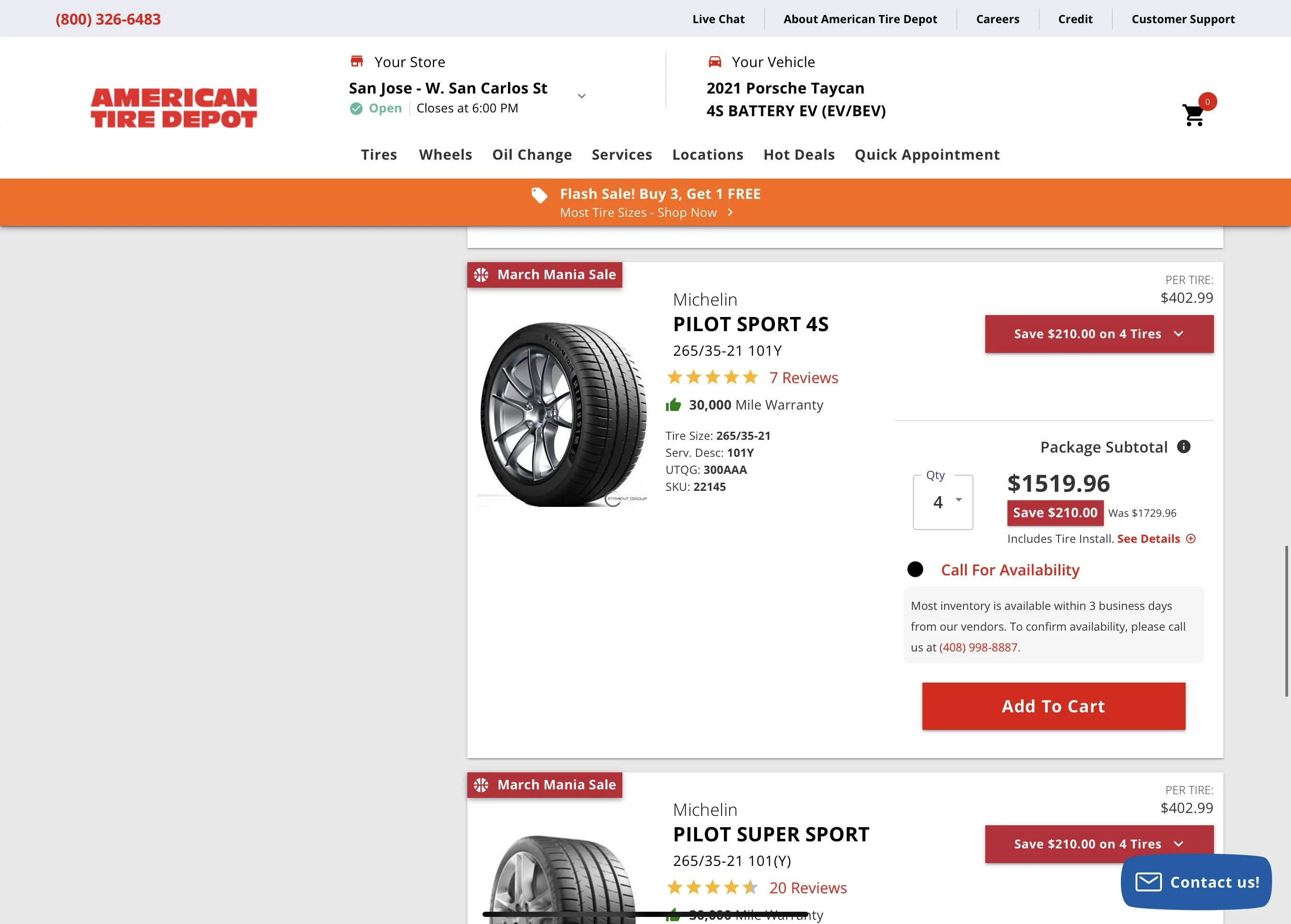

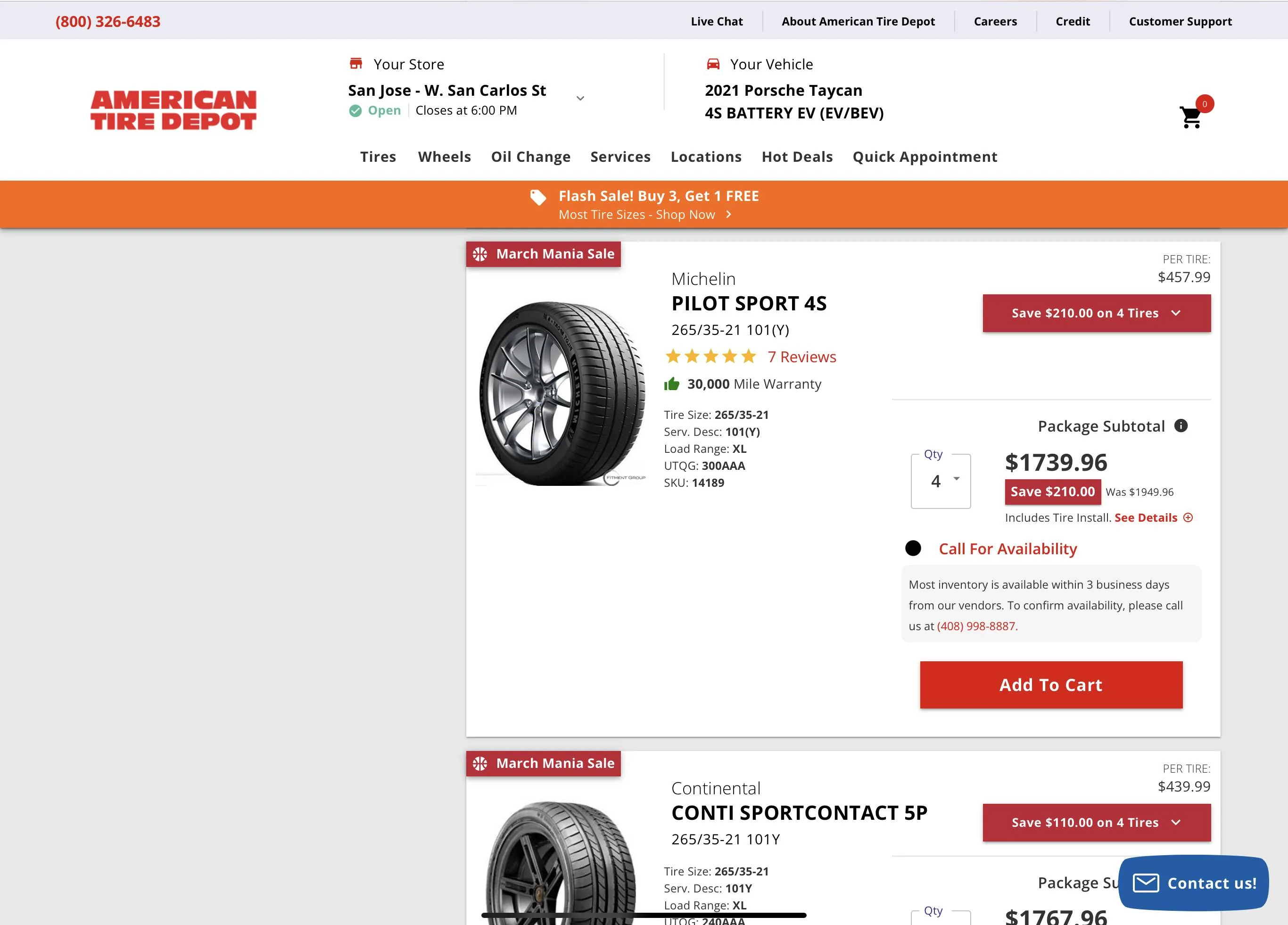

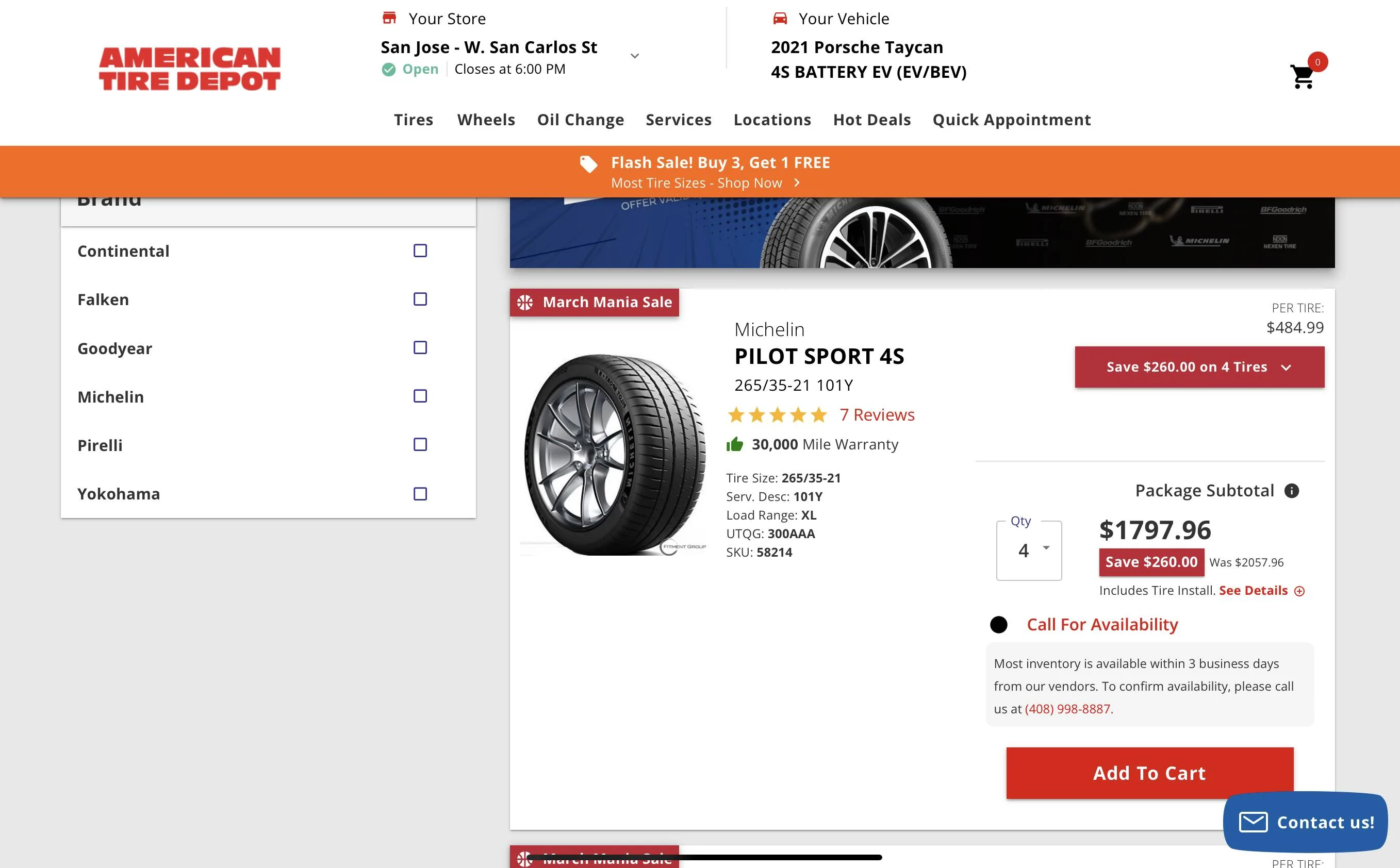

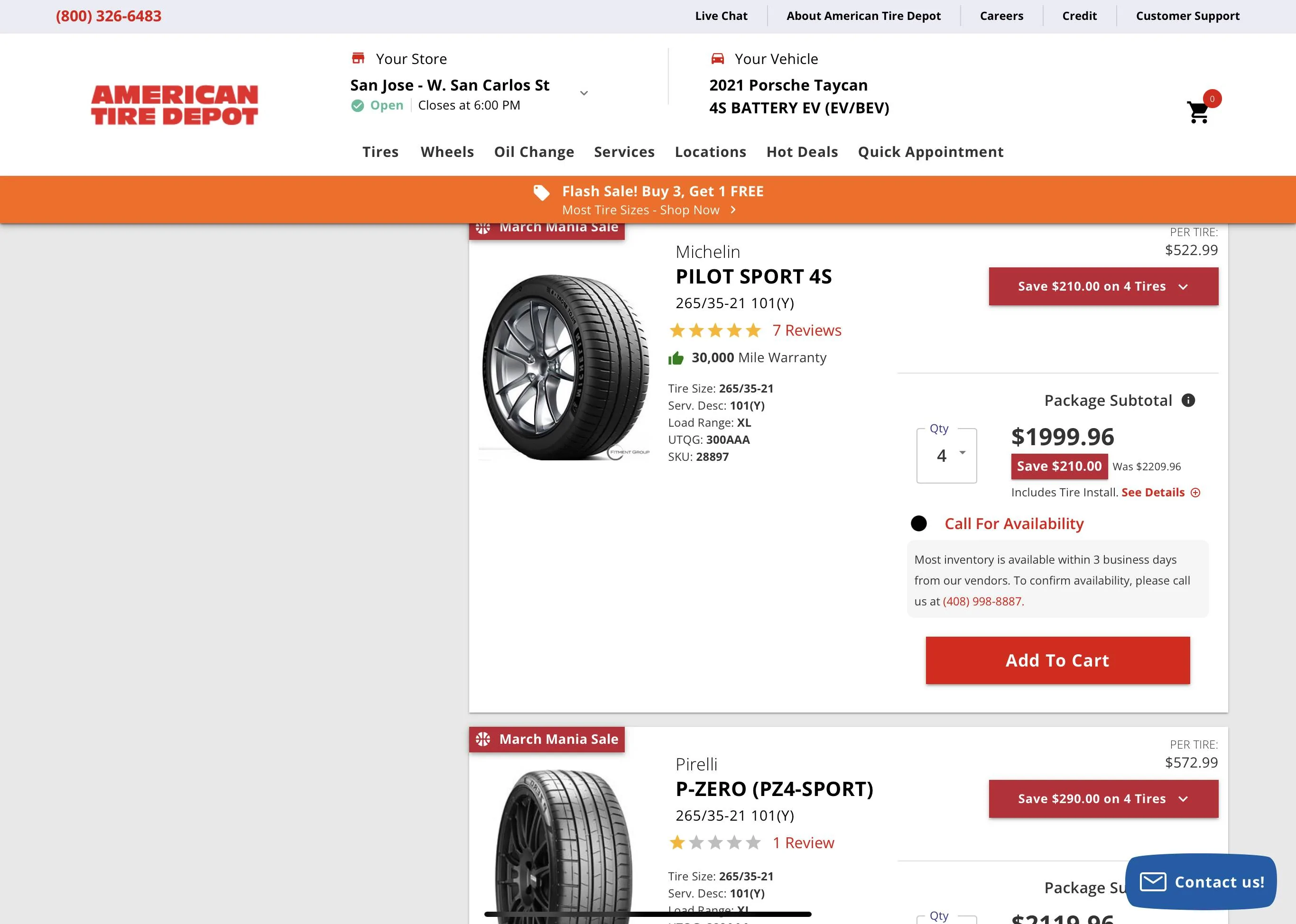

It won't outright void your warranty, but Porsche will have to prove it and they probably have the means to fight you to deny warranty work if they wanted to go that far. Why give them an excuse?
It's not just load rating, but an NF tire was tweaked by Porsche in conjunction with the tire manufacturer specifically for the Taycan, to find the best balance between noise, performance, rolling resistance etc. Sure, you can run any tire you want and have zero issues. Is it the optimal tire for this car? Probably not.
With that said, I've had Michelin PS4S tires on all my previous cars and it was a difficult decision to not go with them two weeks ago when I needed new tires on my Mission Es. But maybe not since the only available PS4S in 305/30/21 is a Mercedes spec tire...

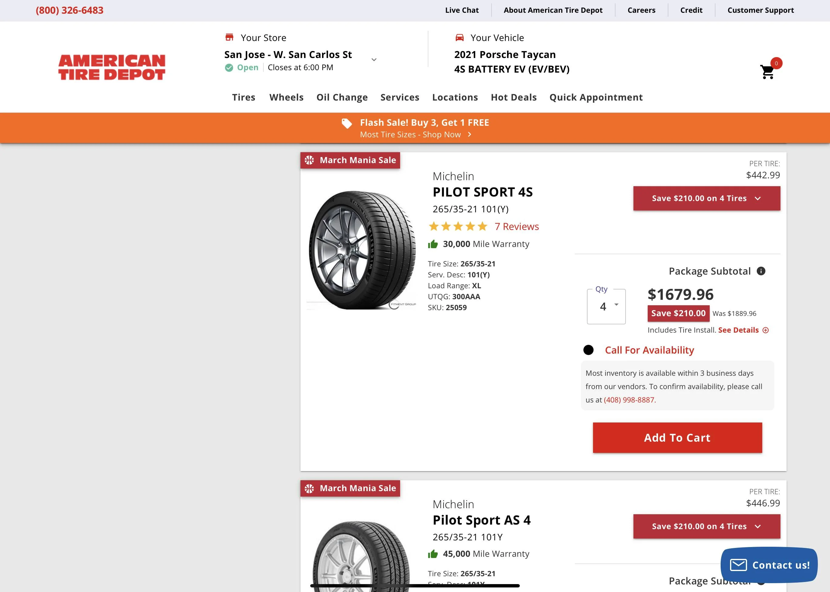

Multiple skus at this place. I have no idea what the differences are:
Might not notice a difference for normal driving, but I'll have that nagging feeling I mounted a tire that was made to the specifications of a Mercedes SUV on my Taycan. :p
