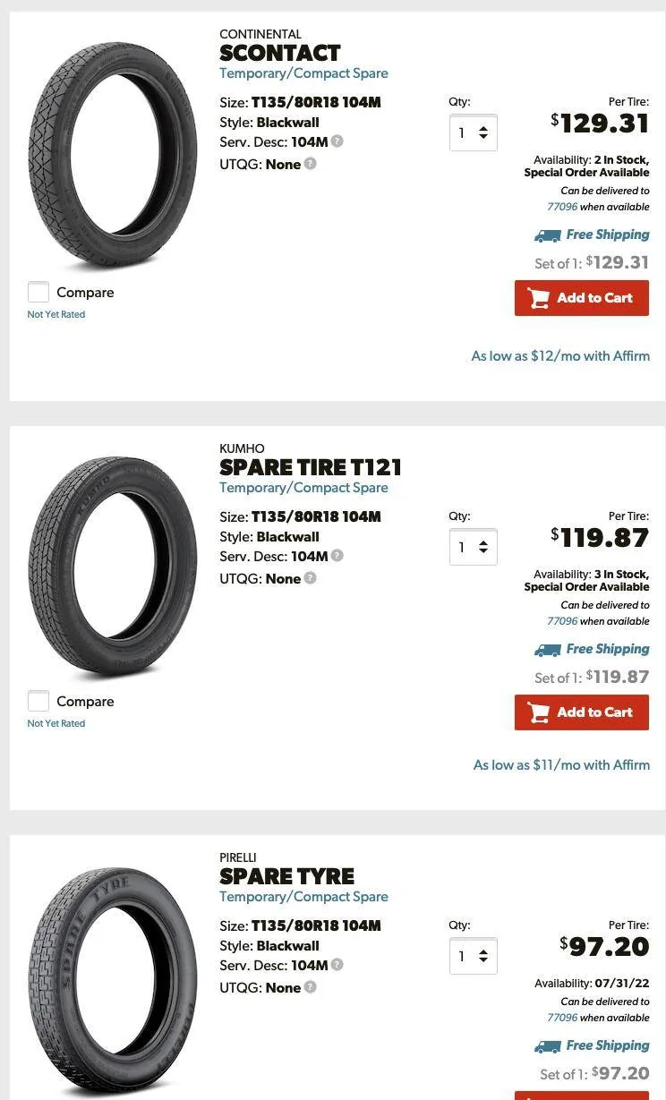

Have you managed to find any information about what spare tires fit it? I’ve come up empty-handed so far…
For the BMW wheels it was a Pirelli 135/80-18 or similar - need to research for the Porsche. The load index per tire for these tires is ca 2000lbs - so prob sufficient for one corner of our 5600lb Taycan's!
e.g.
https://www.tirerack.com/tires/Tire...&rearRatio=40&rearDiameter=17&performance=ALL
But honestly have not really looked too hard yet as I know I'll lad on one or another good enough to take the load etc. and again no plans to travel any further than absolutely necessary to get to a service station.

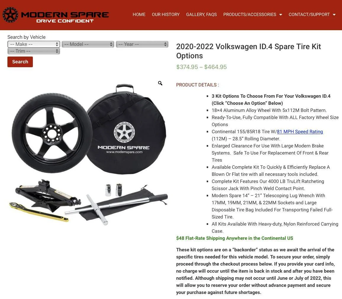

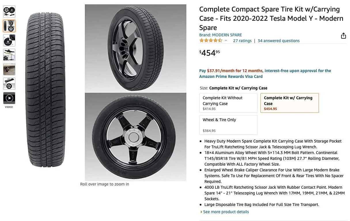

Here is a non-Porsche possibility for a donut or compact emergency spare kit (and as yet not verified as compatible NOR if the bolt pattern etc etc is correct - plan to enquire of them soon):
- note that you can buy just the tire and wheel if thats all you need:
https://www.amazon.com/Complete-Compact-Spare-Tire-Carrying/dp/B08FCXGVW8/ref=sr_1_16?crid=1D23PZIUZWOG2&keywords=compact+spare+tire+tote&qid=1651165360&s=automotive&sprefix=compact+spare+tire+tote,automotive,90&sr=1-16
Again have not researched these fully yet re compatibility with Taycan's but this seems to be an excellent deal if transferable - this is designed for a Tesla Model Y
Here is their shop on Amazon - have a ton of options however whilst VW ID4 listed Porsche is not as yet:
https://www.amazon.com/s?k=MODERN+SPARE
Porsche Taycan Taycan Compact Spare Tire options Screen Shot 2022-04-28 at 12.05.01 PM
The above mentioned ID4 kit (tires area backordered):
https://modernspare.com/product/2020-2022-volkswagen-id-4-spare-tire-kit-options/
Porsche Taycan Taycan Compact Spare Tire options Screen Shot 2022-04-28 at 12.14.19 PM
