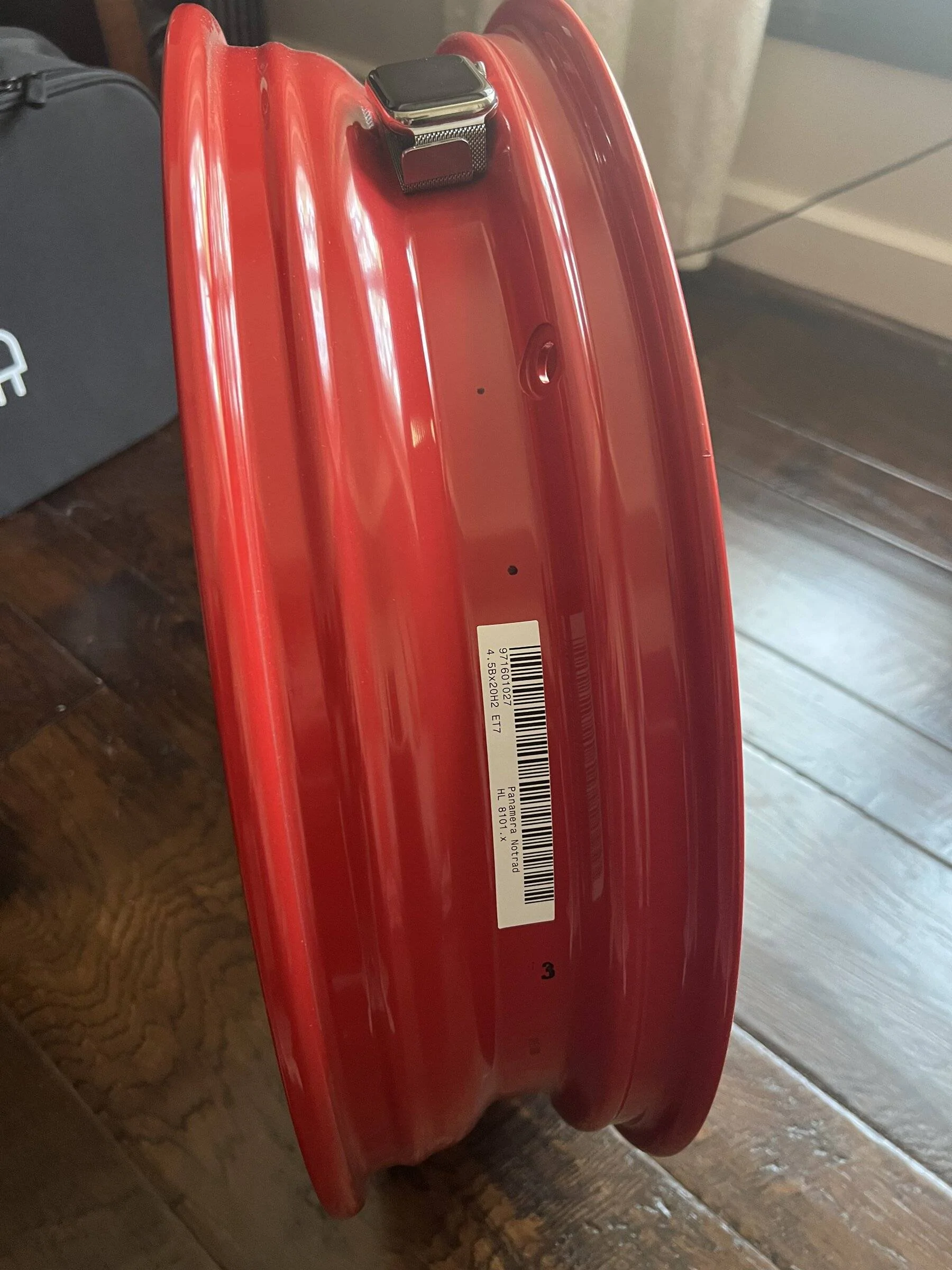

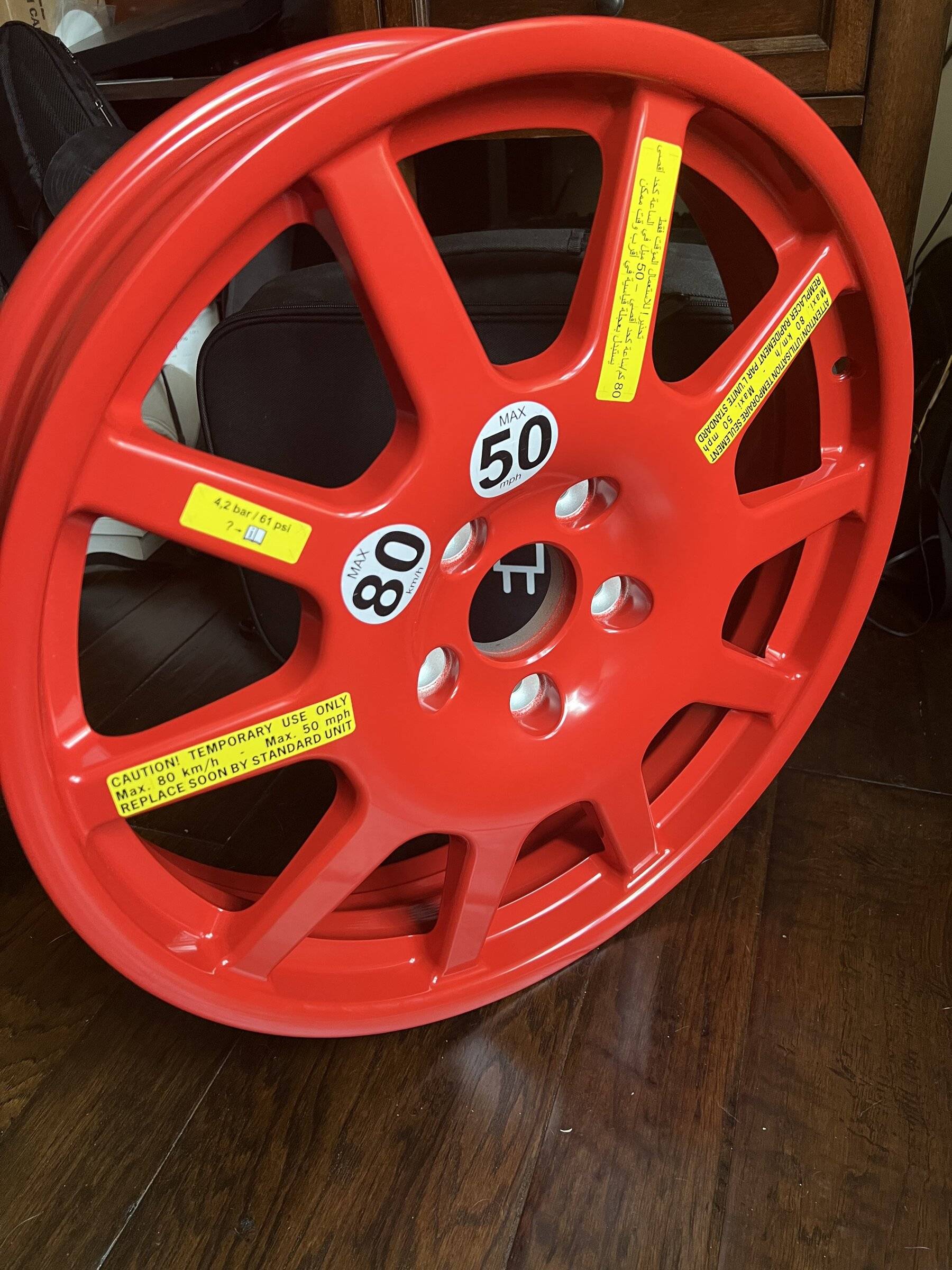

Spare wheel aka 'clown wheel' arrived and as noted in the Spare Tire thread, from a Panamera Emergency kit but verified for use with the Taycan (as described above and here #13 ) - 20" wheel weighs about 20lbs and 4.58" wide (so quite a lot thinner than the Cayenne spare shared above and whole wheel nice and light). Actual measured max dimensions appear to be 21.25" outside diameter and 5.25" edge width. Air pressure to be 61 psi - basically like a mountain bike tire!! Definitely won't forget to take this puppy off after use :)
Tire ordered from separate source (SilverSpring) to arrive hopefully next week but car still in shop all next week and no issue there.
My Apple watch for scale :)

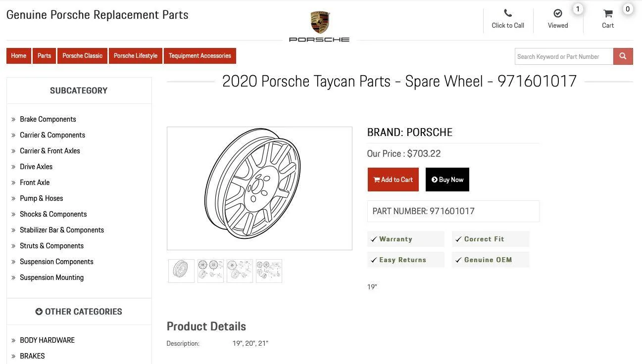

Has anyone actually purchased this supposed Taycan compatible compact spare and is it like my OEM BMW spare in that it can fit either front or rear (using supplied spacers etc) to get you safely to a dealer/service center?
IMO I'd have zero issue paying for it if this thing works however I do not see in the related diagrams any spacers etc if needed to use for both front and rear applications i.e. might be front only? ALSO despite screenshot showing for 19", 20, 21" there is just a 19" by the wheel pic... ?
Currently waiting on response from my dealership and others re applicability.
HOWEVER - despite listed in the page title and listed as fitting the 2020 Taycan model lineup on their respective page descriptions, when you check to see it fits your model car via say Sunset's linked car checker it says it does not - brilliant!
Suncoast (have a query in to them pending) does not list this with the Taycan and suspect they are more accurate vs others here but again waiting to verify.

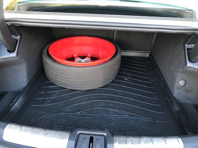

I went ahead and posted a few pics for those interested with the tire mounted on my Porsche spare wheel in my Mods thread in the rear of my Cross Turismo - link here : #212
Works really well and plenty of luggage space to spare.
Using the above link as want to avoid duplication of loaded images.

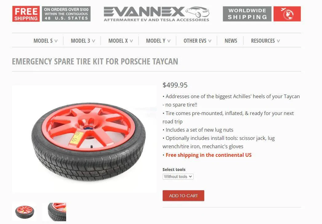

I saw this today, and wonder if it's the same wheel you put together (selecting the "tools" adds $100 to the price) :
https://evannex.com/products/emergency-spare-tire-kit-for-porsche-taycan
Different wheel but presumably if compatible should work fine - mine is the wheel from the Porsche OEM Panamera Emergency Spare kit they sell in Europe - wheel made in Italy and a different design to the one you are showing here - this one looks very like a red painted version of the generic Tesla spare I posted earlier to mimic Porsche's OEM spares - see post #14

Ya, looks a little different than yours on closer inspection. Yours has 10 spokes, the one I posted is only 8 spokes. The Telsa one looks very different and is only 5 spokes.
They are sure marketing it as compatible to the Taycan, as that's what they are showing its specifically for.
Ha, was just looking at the wheel lugs/nuts, didn’t even count the spokes :)!!
But again if a good quality product no reason not to use this at all - nice addl find.
