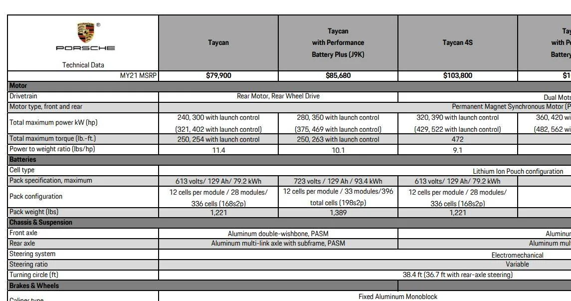

out of interest, did you know that base and 4S Taycan without the "plus" 94 kWh battery do not have a 800V batterypack?
The cell configuration is 168s2p which add up to 168*4.2V = 705V fully charged and 613V nominal.
Only the big battery is at 198s2p and reaches ~831V at 100% SoC.

705 Volts is a lot closer to 800 Volts than 400 Volts.
