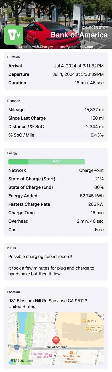

I had what I think is a record for me today.
Porsche Taycan Taycan slower than other 800V IMG_2797

@DerekS that is amazing charging speed. A record on this forum possibly as well? That sort of performance appears to be a distant dream in Australia, outside of the Tesla network (which is still mostly locked for Tesla).
