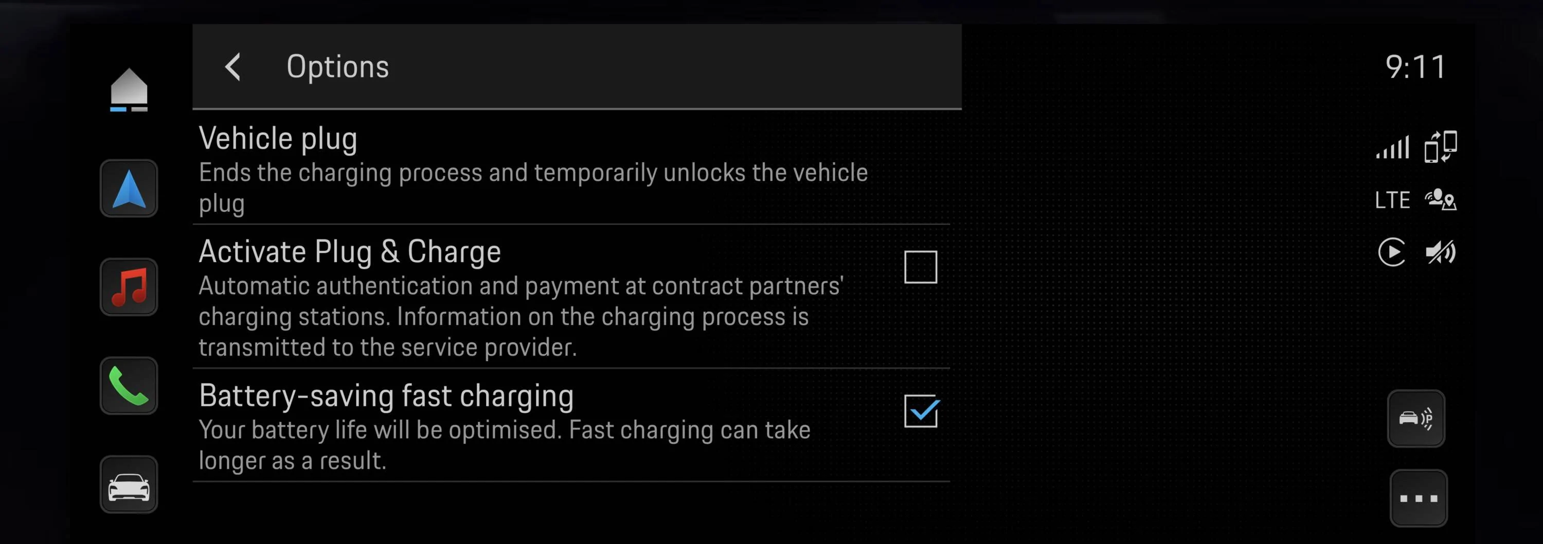

Check this setting: Battery Saving slows the charging speed to increase battery life.
Check PnC feature as well.
Another problem that can happen at EA stations lately is some dispensers are running at reduced power/speed.
Try navigating to a high speed charger next time.
That's a great thought! Wish it had of been this, as it would be a quick fix. I looked and this was not turned on :-(
That option would’ve capped the peak at 200 kW, so it wouldn’t have been that either.
This Bjorn video explains the Battery-saving fast charging option well…
