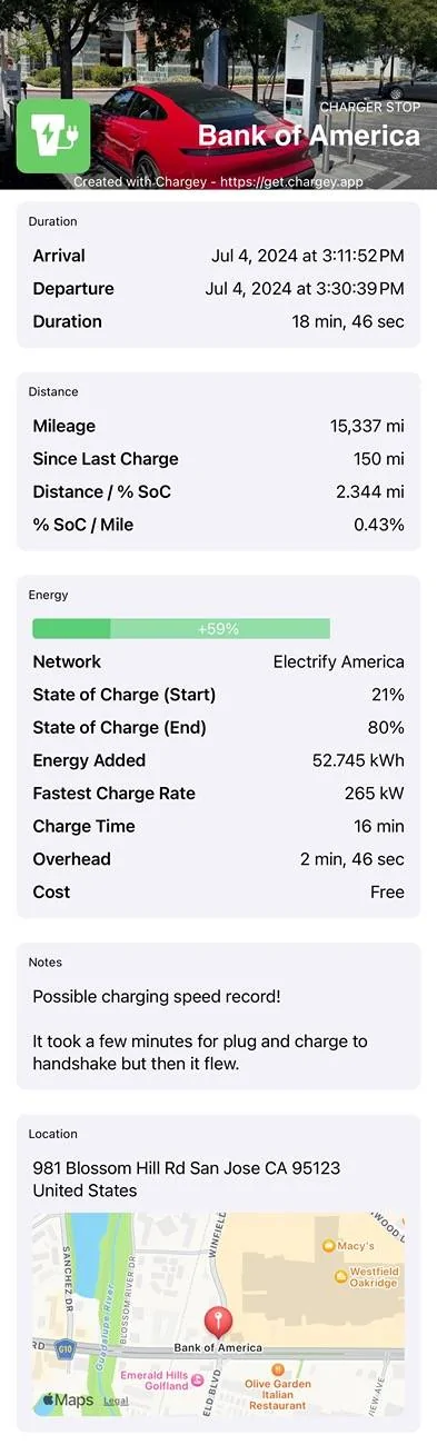

I don’t actually know if I’ve topped 265. I need to review the data.
I should add achievements to the app.

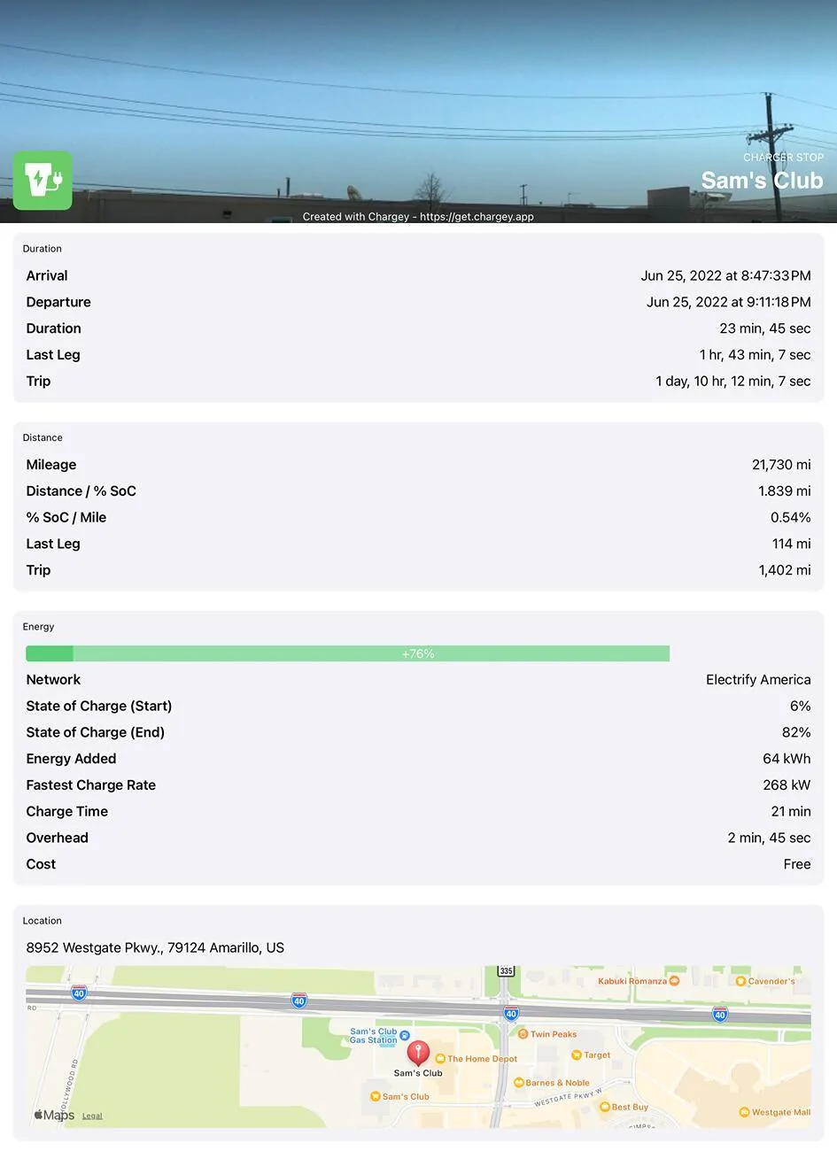

I found a faster one from my first Taycan.
Porsche Taycan Taycan slower than other 800V 1720149698231-54

I had what I think is a record for me today.
This shows the charging session was free at a ChargePoint charger. This was not through the Porsche App since I think the Porsche App can only be used at EA right? If the charging was free was it at a location which the site owner offers free charging to its customers? If yes, then I could see the incentive this business owner has to insure the highest charging speeds to get cars in & out as quickly as possible.
Some large semiconductor manufacturing facilities which offer free charging to their employees use huge amounts of energy which they buy at very low bulk rates (5-7 cents/kwh) so they want their chargers to charge at the max rate so their employees and company EVs charge very quickly.
The business model for charging locations which are free to customers usually charge nothing for the charge but to keep customers from tying up chargers by parking long after they finish charging they charge fees for every minute past full charge completion. Still some very inconsiderate people will stay plugged into a charger for hours like a Bentley I noticed in Beverly Hills and a Mercedes in Las Vegas where the car owner left the car for 3+ hours plugged into the charger while there was a line of people waiting to charge.
I think to stop these inconsiderate EV drivers the charging station should begin draining the EV battery of its charge at the highest rate back to the grid after 15 minutes past the charge hitting 100%. The owner would surely get back to his/her car quickly if they would eventually come back to their vehicle with 20% SOC because they just parked went to dinner…
I would at least enjoy seeing the reverse drain rate on a vehicle that parked at a charger for 3 hours…
It likely would never happen since the person with the Bentley would probably raise holy hell with the establishment offering free charging and that she should be able to park anywhere she wants as long as she wants since this was a high end fashion mall.
I have to say mostly people are very considerate when waiting to charge their EVs but there is always the one here and there that everyone is blown away at how inconsiderate someone can be…

Ack. No this was Electrify America. I mis logged the charge.
That's an interesting screencap.
Oakridge Mall sits between Winfield Blvd. on the west and the remains of the Guadalupe Parkway on the east. There's an EA charger in the SW corner of the mall next to a car wash and "behind" the BofA if you're looking north from Blossom Hill Road. I think I see an EA logo on the charger in your photo, and the BofA is arguably the closest building to it. However, the address of that branch is 971 Blossom Hill Road. 981 is the IHOP on the other side of Winfield. The network field in the app says ChargePoint, but the closest ChargePoint charger seems to be at a Chevron station across the street from the east side of the mall, at 875.
EDIT: I guess most of that was mooted while I was writing it, but left in case any of it helps you improve Chargey's locationing.
