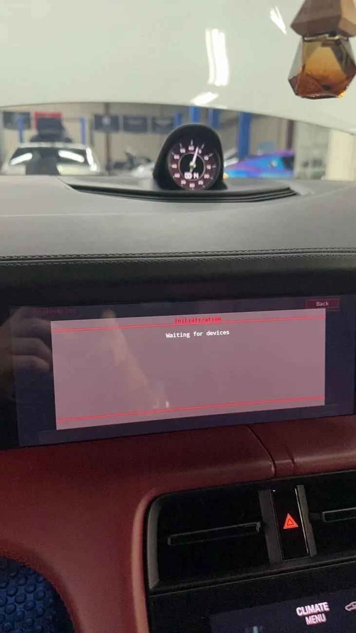

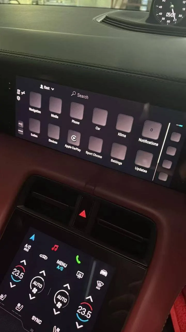

Can you link directly the posts that showcase a Macan EV PCM which does not boot up, like this taycan:
Porsche Taycan Technical changes with MY26 1751284584856-pl
Can you link directly the posts from the Macan EV forum that shows the PCM of a Macan EV being completely dead and requiring new hardware, like this taycan:
Porsche Taycan Technical changes with MY26 1751284634046-2m
Because all you posted so far is a thread of small glitches in following OTA updates, in which the owners report no more issues after a reboot or no issues at all?
