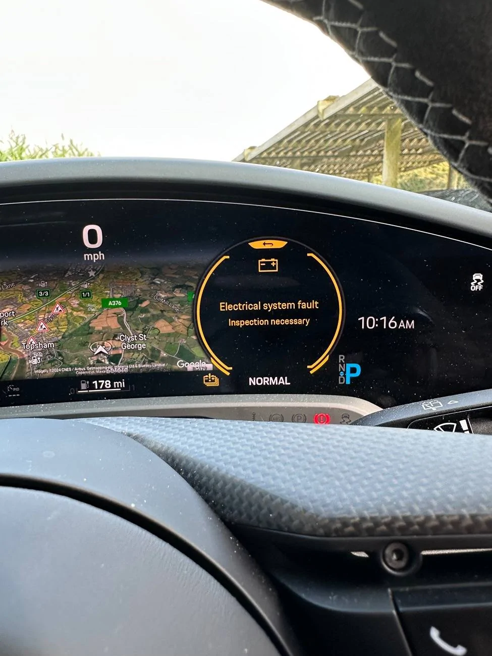

I had the same issue last weekend and it sorted itself after around 20 mins.
The car was in for the brake recall on Friday and I mentioned it to the technician, it was dismissed as “sometimes this happens at high voltage chargers” when I asked if I now need to plan an extra 15 mins for it to reset the tech replied “yes” - not the response I was expecting.
Never had a problem with IONITY so will make more of a fuss if it happens again.

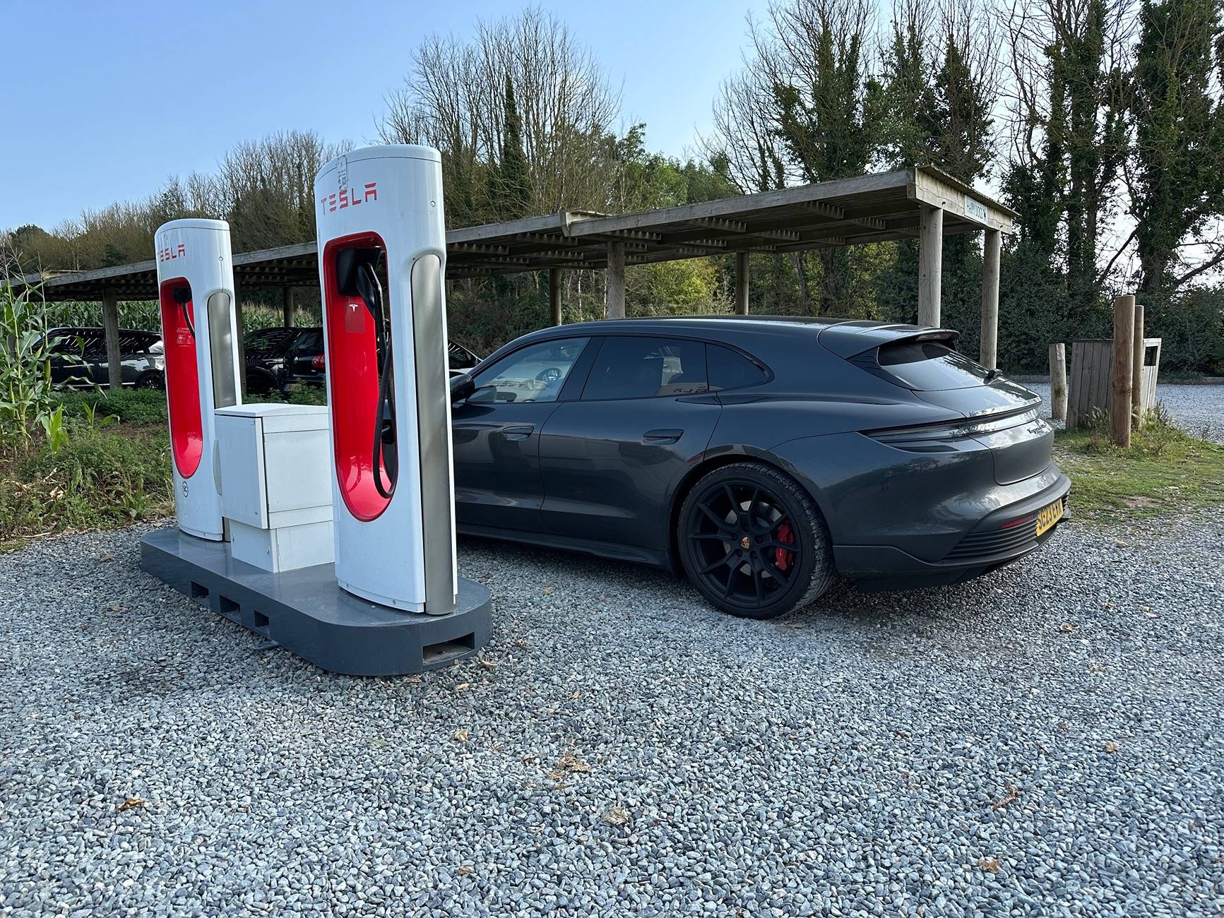

Location was Darts Farm in Devon:
Porsche Taycan Tesla Supercharger (250kw) resulting in electrical system error. IMG_6157
Porsche Taycan Tesla Supercharger (250kw) resulting in electrical system error. IMG_6162

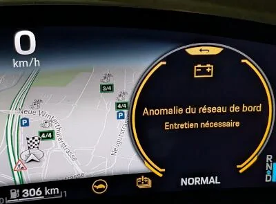

I am using from time to time the Tesla Supercharger in Landquart (250kW). If I leave the car for a full charge up to 100% I will get the same message every time "Electrical System Error". I have to switch off the car for a few seconds and then the message disappears.
The maximum charging is not higher than 140kWh (with the 150kWh charger 400V option)
Intresting mention with the 100% . I also got the error at the same location once; don't remember if the car reached 100%. Will keep a look on it, maybe even avoid 100% charging on tesla.

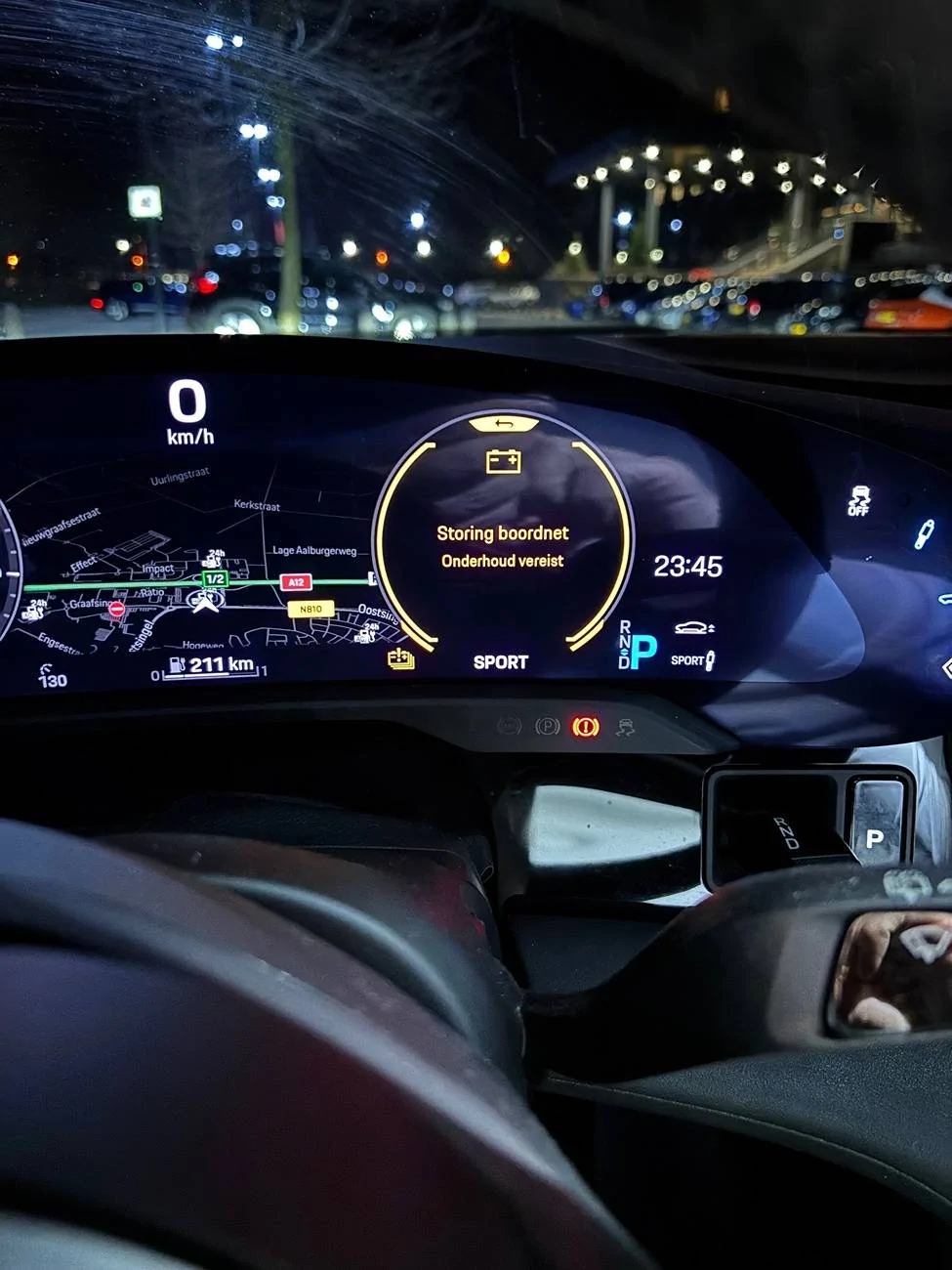

I had the same issue last Friday at a Tesla Supercharger in Duiven (The Netherlands). The car displayed the same message, and I couldn’t shift into drive or reverse—only neutral. I called Porsche Assistance, and they advised me to lock the car for 30 minutes and try again, but that didn’t work.
The car was towed to a Porsche dealer, but when it arrived there on Monday, the message had disappeared.
The Porsche dealer showed me a notice on the PC screen stating that first-generation Taycans can experience issues with Tesla V3 chargers. Duiven is indeed a V3 charger.
