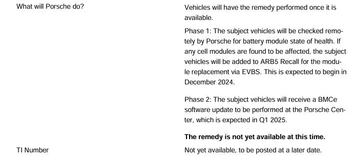

ARB7 - not in scope for now but limit charging to 80% is the remedy at the moment.
For cars under ARB7 there is no limitation on the charging ceiling. Porsche has OTA data and there is currently no indication of a battery fault. For ARB6, where no OTA data is available Porsche is recommending 80% "as an interim remedy". I'm referencing my ARB7 recall letter and Safety Recall Report 24V-732. Might differ outside the U.S.

So can we translate ARB7 as:
- We will check the battery remotely. If it sucks we will add you to one of the prior battery recalls.
- Next year we will install new battery management software.
If I’m right then I guess this recall is neither cause for alarm (yet) nor actionable.
Unfortunately that is exactly how I read it. "Right now we don't think your battery will catch fire but if things change and it looks like it might we will let you know." Considering the delay in sending out the 3 ARB recalls any notification from Porsche about my possible pending battery fire might just arrive a little to late to save my house.

I thought the letter we all just got in the mail is old news per @Tooney, as he posted a newer letter that we should be getting in the mail next that was scrambled but showed ARB7 and 80% limit as remedy. I was wrong since the scrambled recall is ARB5 with 80% limit as remedy. My understanding is that if you are under ARB7 and Porsche determines via OTA that any module is faulty, then it automatically goes into ARB5 at which time the instruction is to limit charge to 80%. How safe is it to charge over 80% if you are in ARB7?

I guess you are safe to charge over 80% until you aren't. Porsche will see the deterioration via OTA monitoring and then notify you in 3 or 4 months that you have a problem? Certainly took their time getting the ARB recalls sent out so I'm skeptical that being notified that your car has just qualified for ARB5 will be fast.
