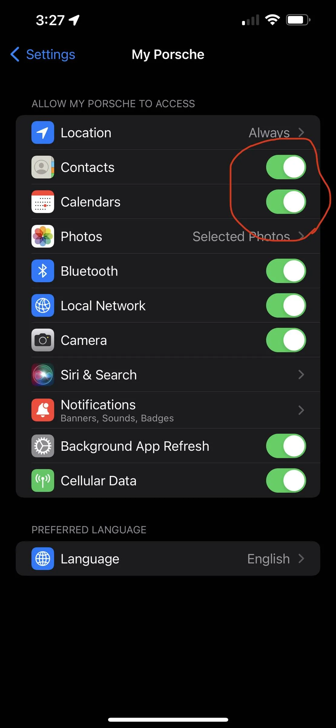

Perhaps go to settings in iPhone—> scroll down to my Porsche app -> turn on calendar and contacts

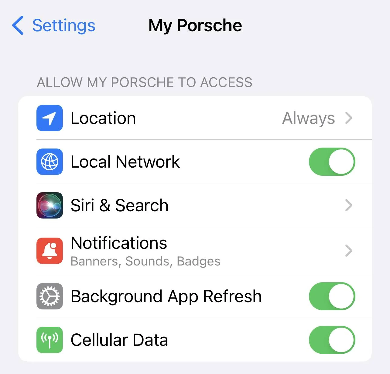

I don't have those settings. Perhaps it's different for older model years (mine is 2020).

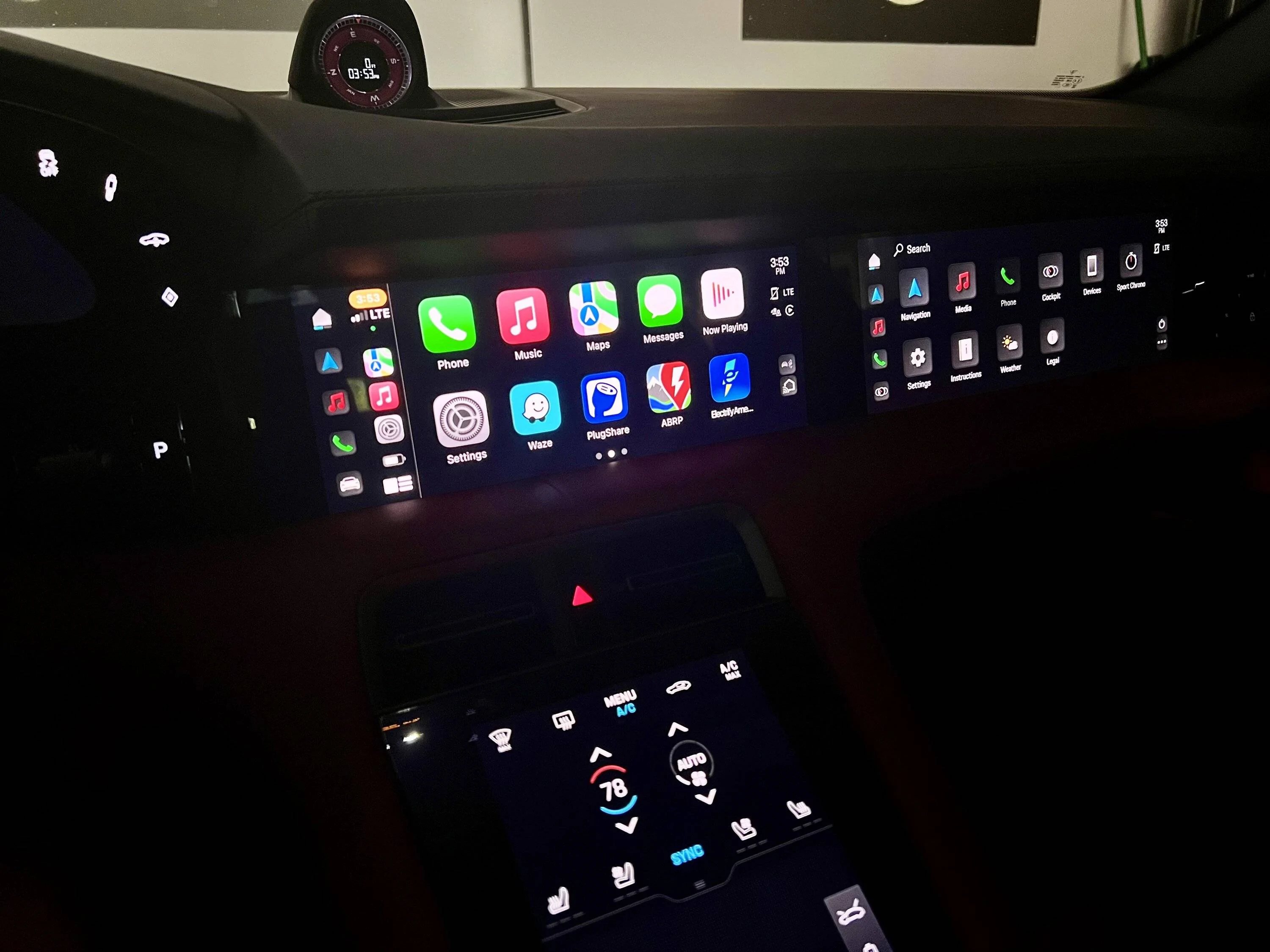

I noticed the PCM needed to reconnect with password to the Taycan WiFI network today for my Calendar to work - possibly related to recent OTA updates but I thought I was previously able to see my iCloud calendar entires in the PCM but def not visible now (could be mistaken re iCloud calendar visibility).
Unrelated, but man I wish Apple would let you chose or set the app icon size in CarPlay - always feels like you're using a tablet setup for a 2 year old with massive can't miss hitting icons (and yes I understand the rationale but much prefer the PCM default size) :)!

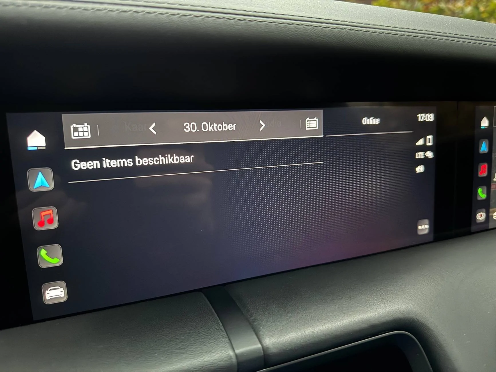

I know this is a slightly older thread but it’s relevant to me so I’m going to add on here. I am trying to link it to my Apple calendar as well but I do not see the same screen that is shown in one of the original posts here. When I go to settings I don’t see a calendar option. Has this changed?

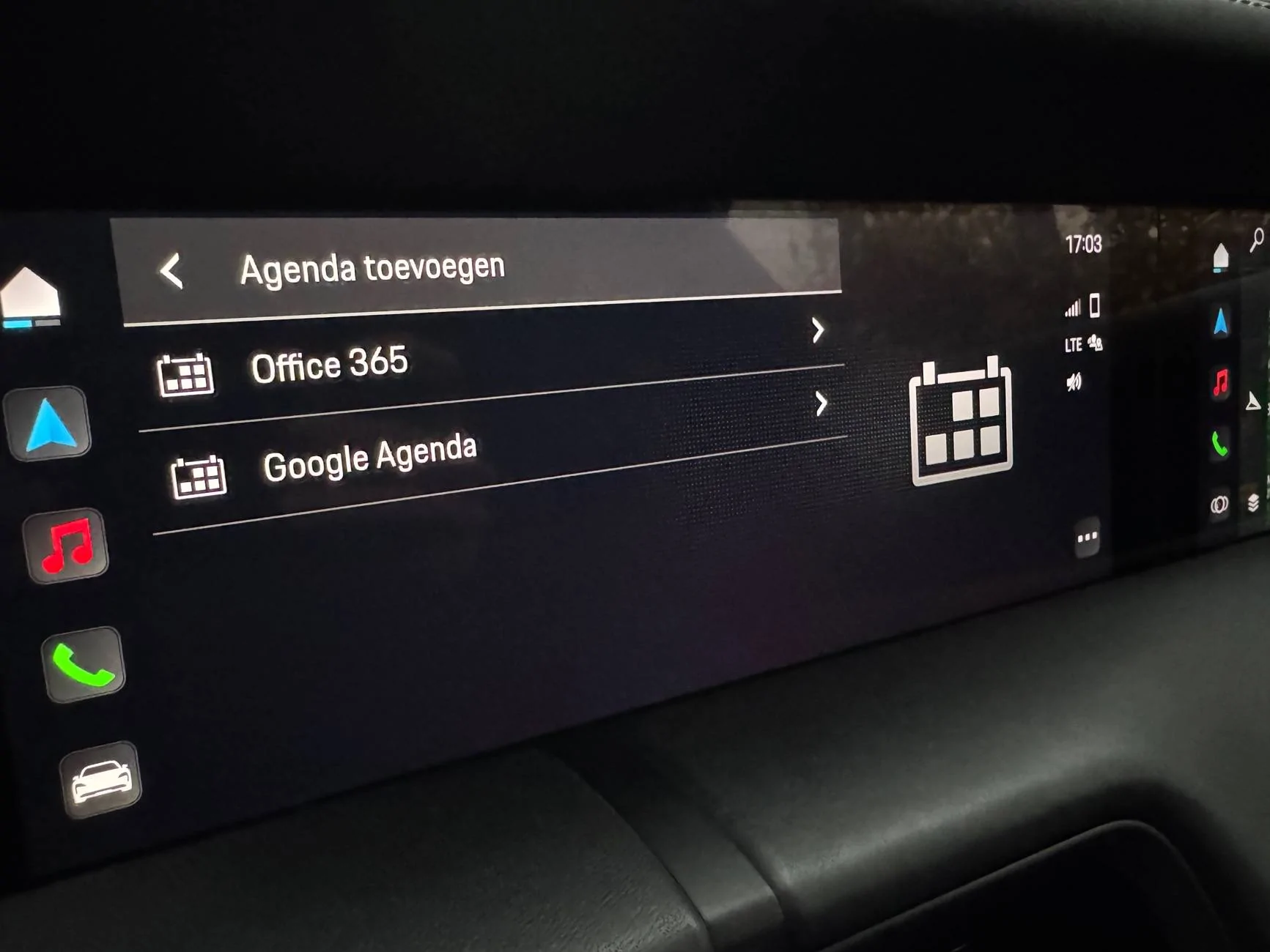

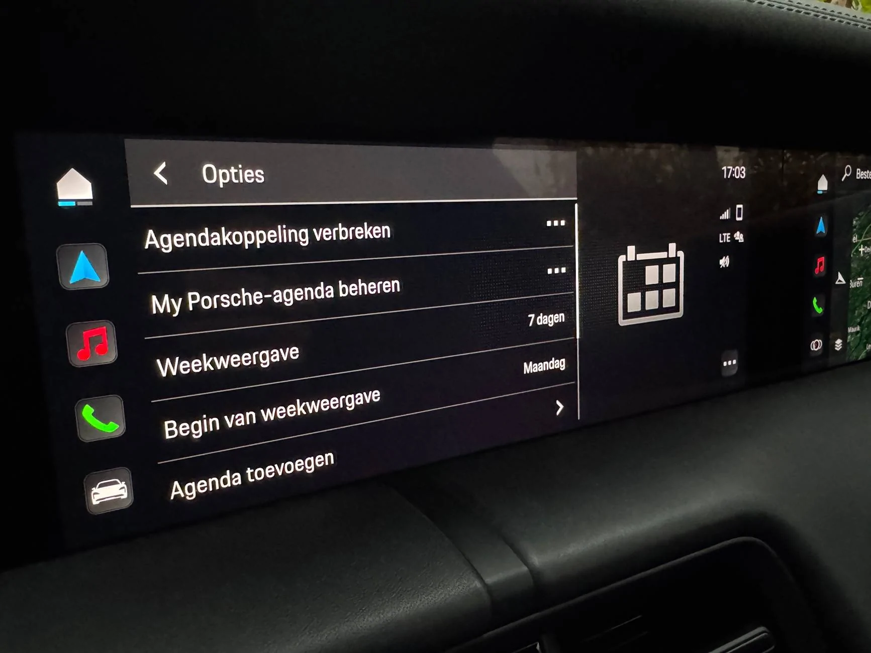

I only have options for Google and Microsoft accounts. Go to calendar app in PCM, open the settings menu with the … icon (bottom right of the screen) and tick “add account”
