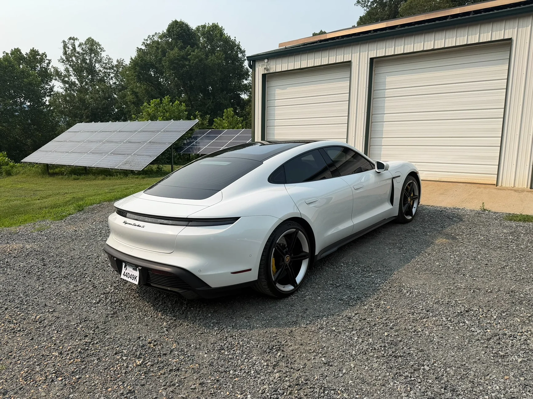

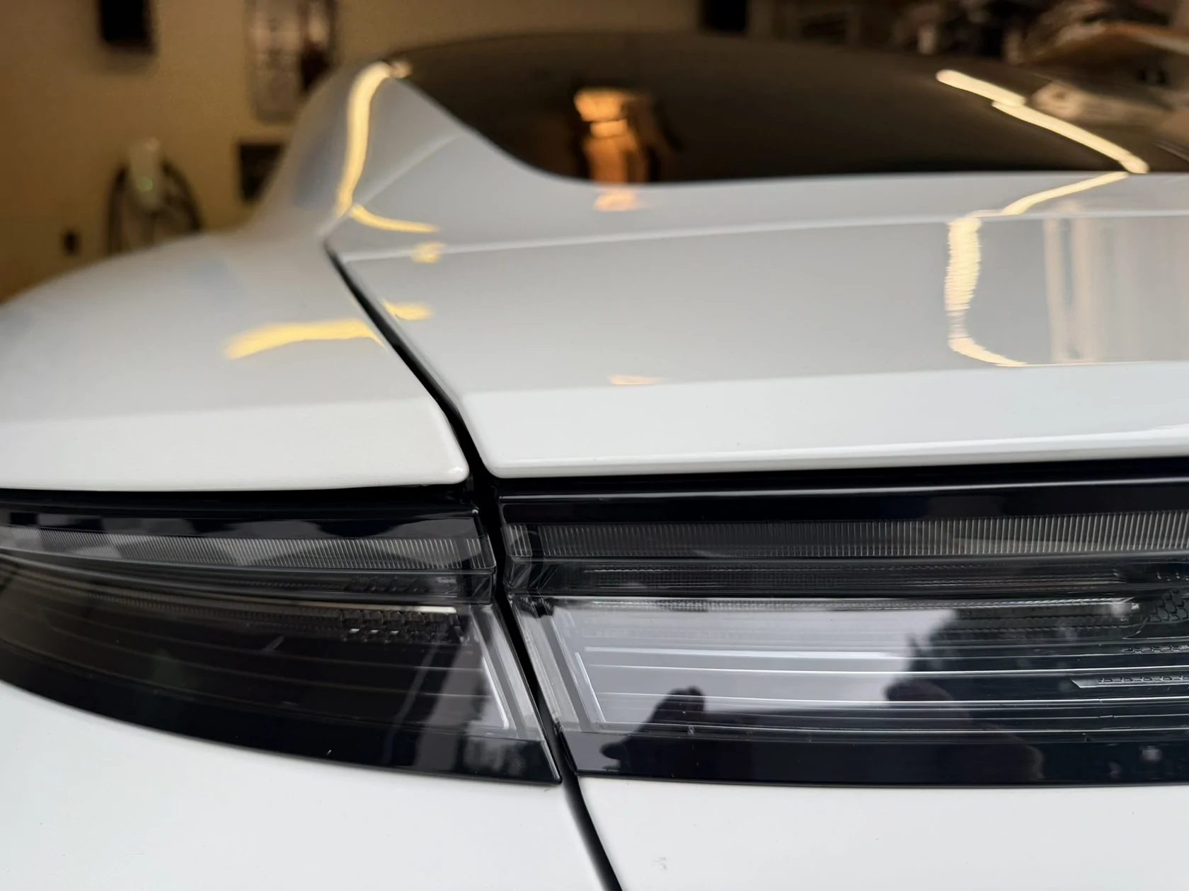

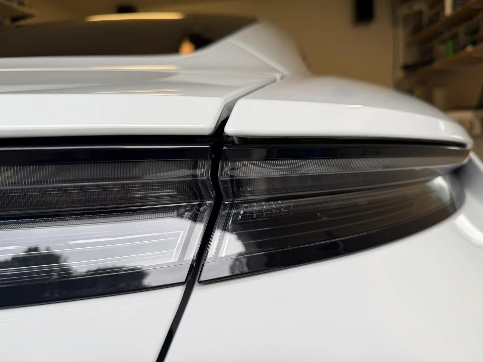

I picked up a low mileage '24 Turbo S a few weeks ago. Per the Carfax report, it had minor repair work done to the left rear quarter. It looks good overall, but the trunk / taillights don't quite line up.
Here's the right side which looks good:
Porsche Taycan Trunk / Tail Lights (mis) alignment - how to adjust IMG_2263

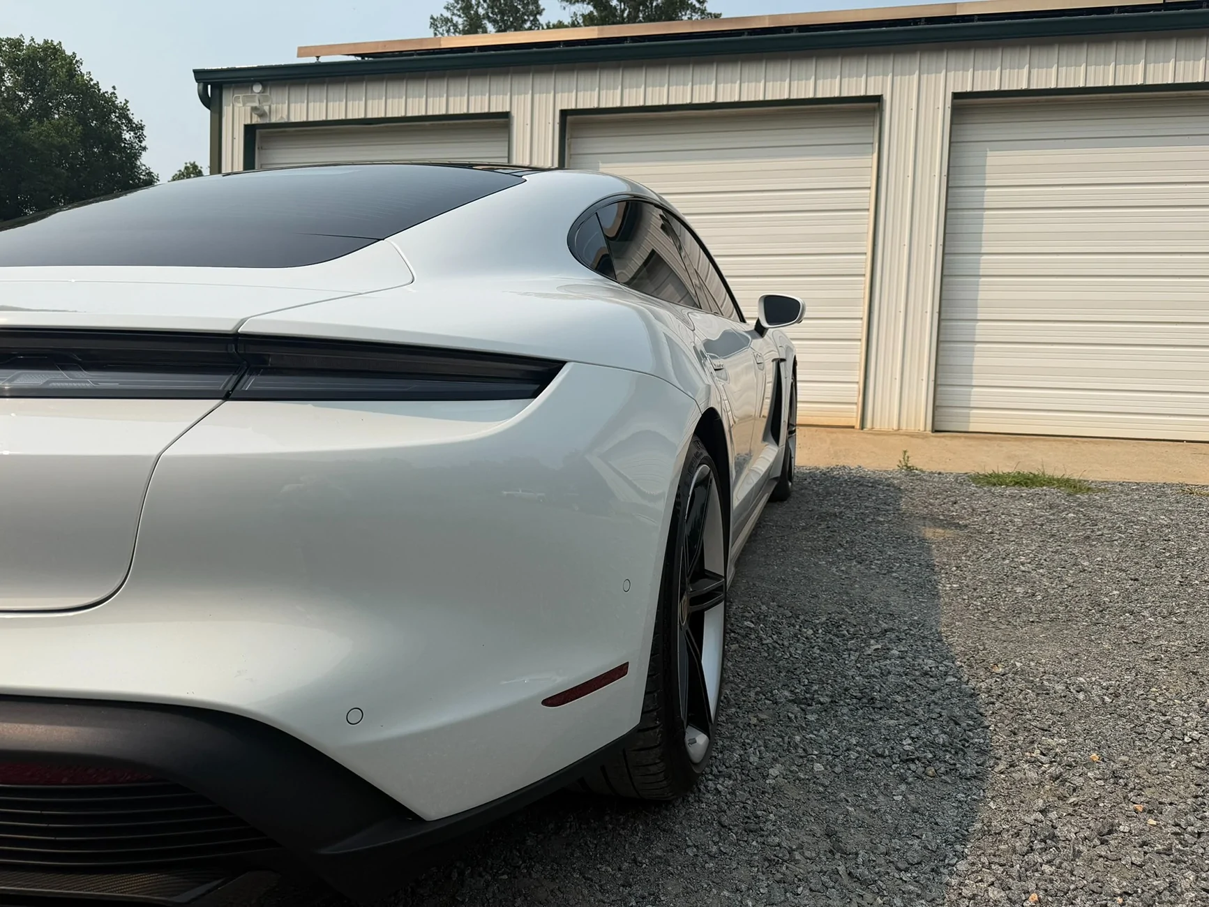

The left side, no to much:
Porsche Taycan Trunk / Tail Lights (mis) alignment - how to adjust IMG_2264
The trunk has a single center motorized pull down to close, so I don't think there's anything to be done there. I guess the left trunk hinge is what needs to be adjusted? Anyone done something like that?

The right side trunk is slightly high and left side is a little more off. If you post a pic of the entire trunk lid closed you'll probably see that's off too.
My Taycan is in the shop so can't test this, but there are adjusting spacers along the lid of the trunk, correct (one on the left side and one on the right)? Try spinning those.

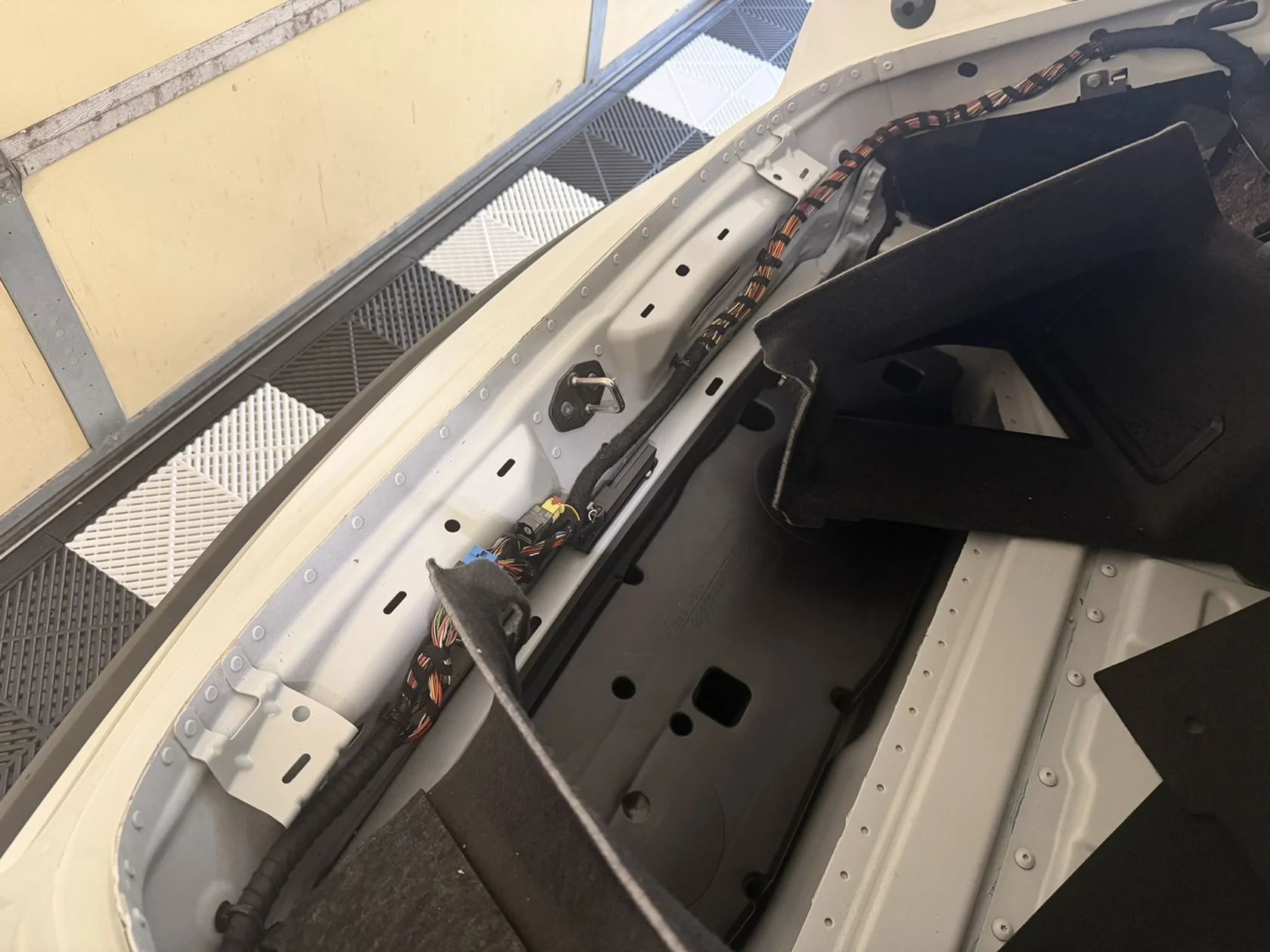

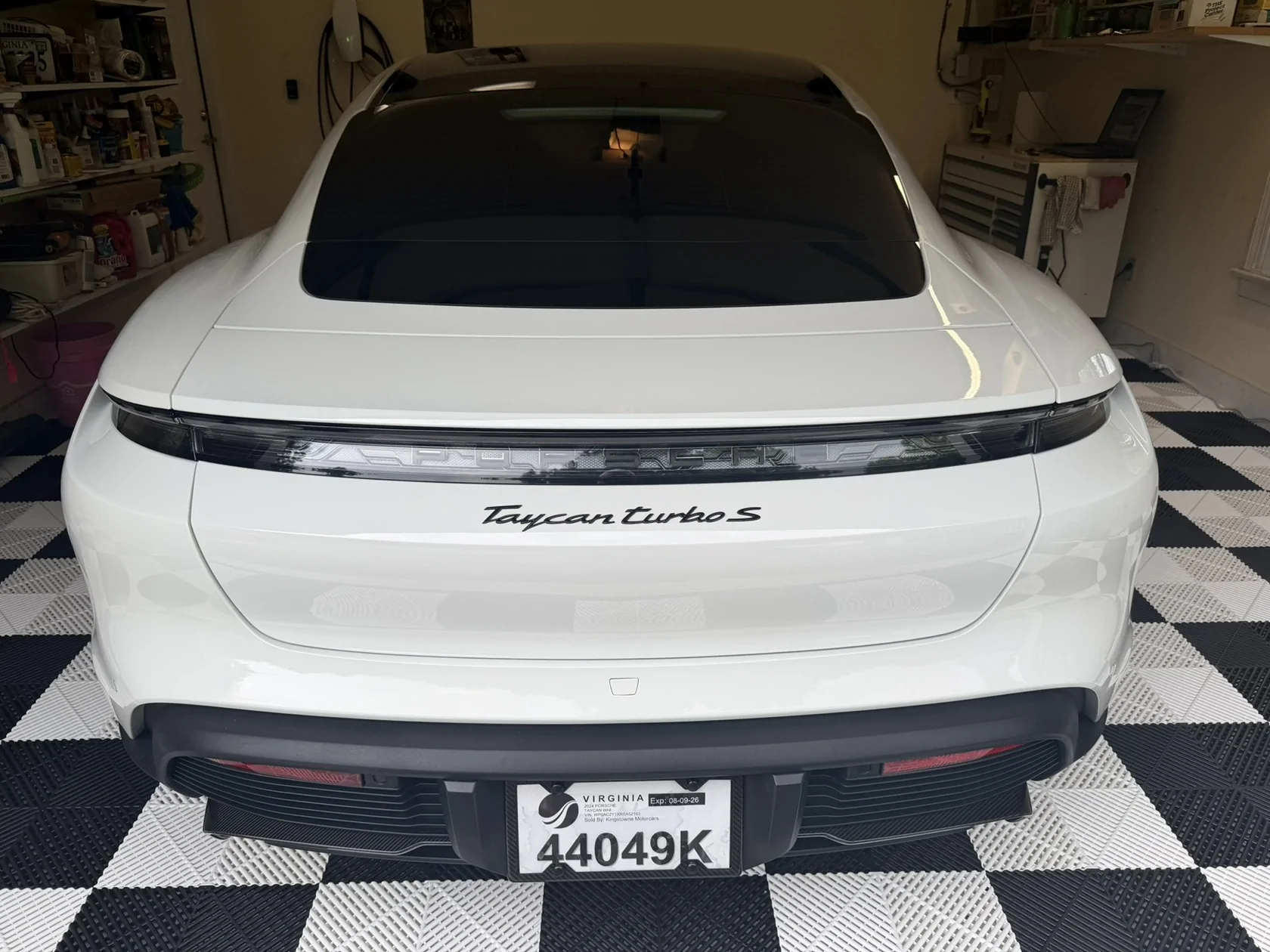

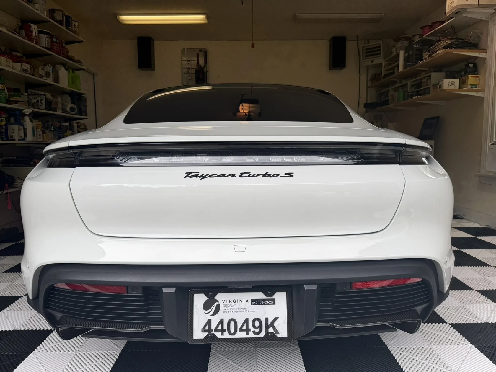

Here's the entire trunk lid closed:
Porsche Taycan Trunk / Tail Lights (mis) alignment - how to adjust IMG_2270

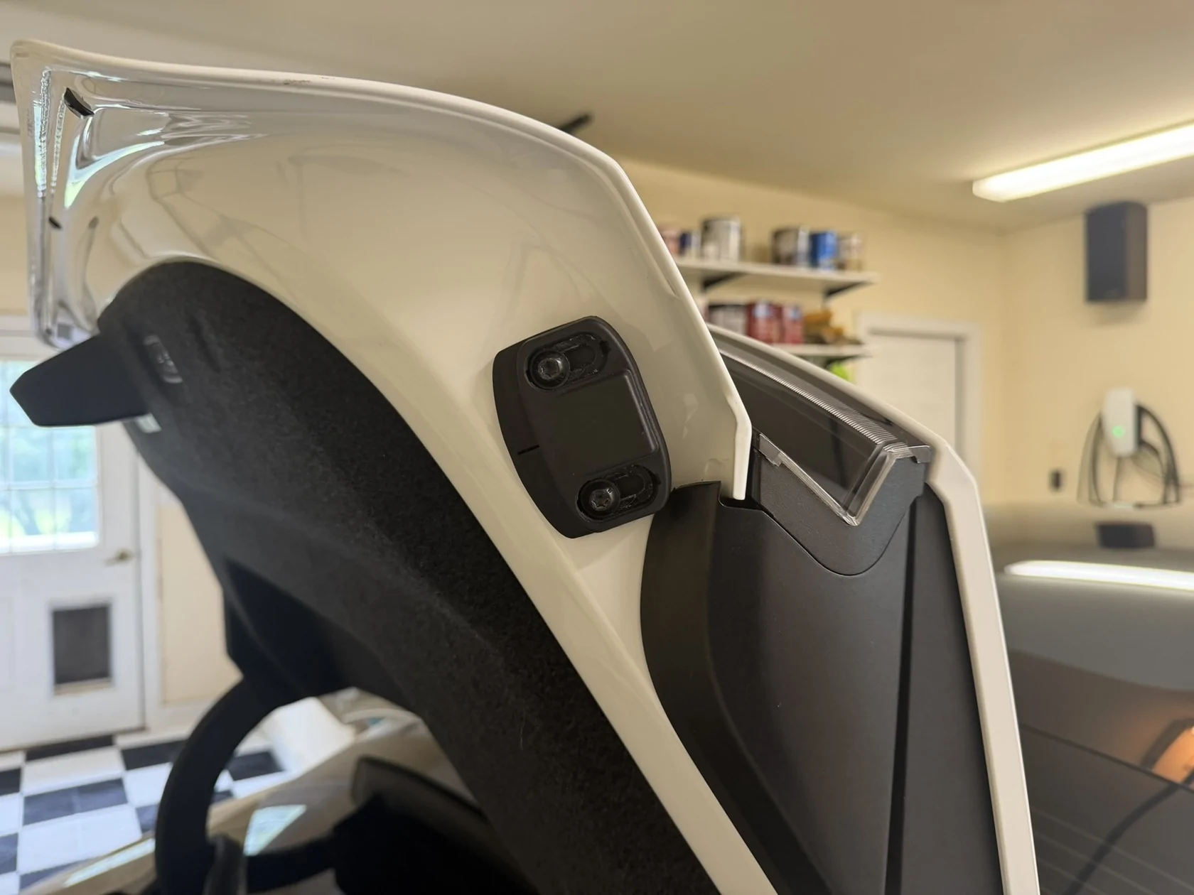

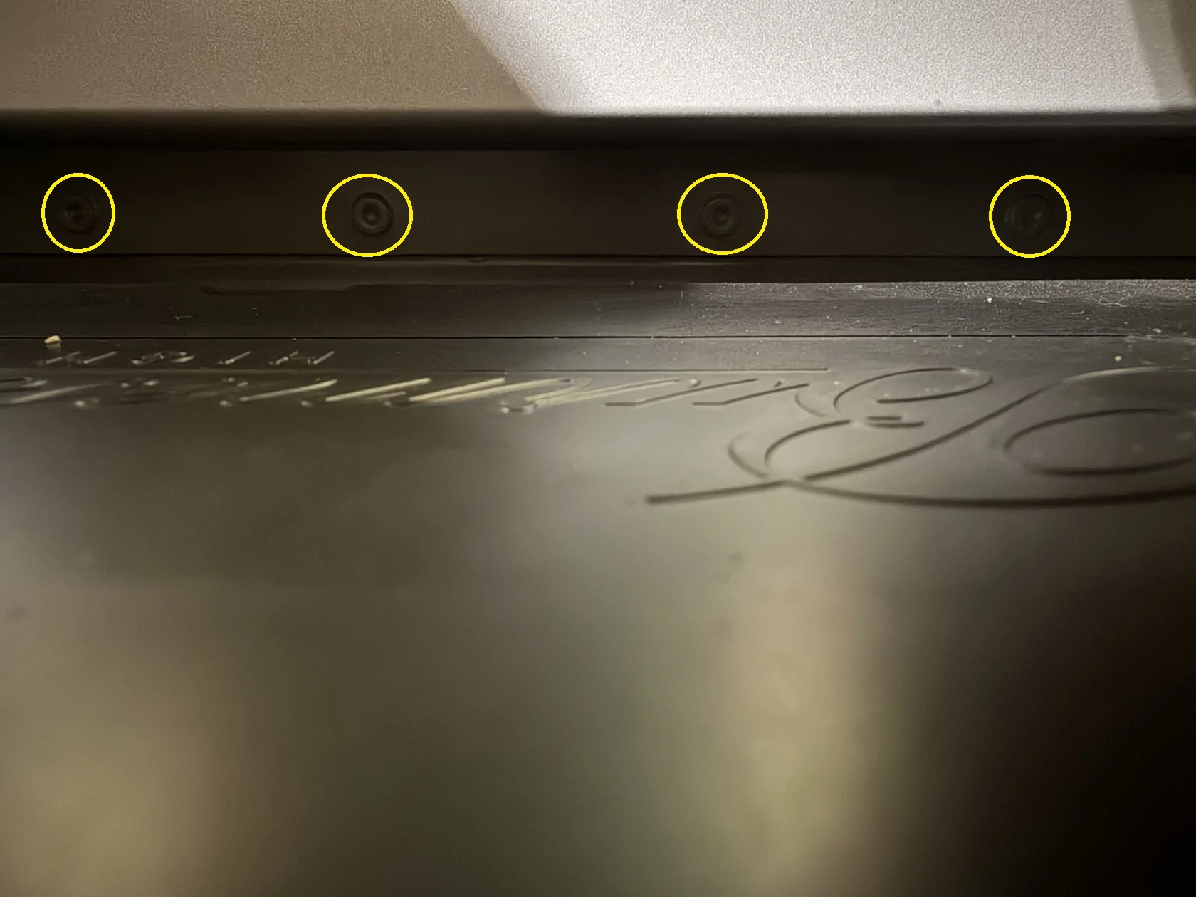

And here are the adjusters I believe you're talking about:
Porsche Taycan Trunk / Tail Lights (mis) alignment - how to adjust IMG_2271
Looks one of the 2 snap on covers is missing on the right side one. So just pop those covers, loosen the torx screws and then slide the stop up or down until I get both sides perfectly aligned, right?

The entire trunk lid is sitting high, more on the left than the right. It looks like the trunk is also pushed in a bit but it's hard to tell due to the photo and the other misalignment.
It could be that the entire back bumper was changed and it's not sitting correctly. If you look at the top of the trunk to the panel above (below the window), it looks aligned. However to the right and left of the back window it looks similarly off so probably just need trunk dropped a bit.
Never done it but I'd try the screw there until things look flush (and the latch closes correctly... not sure if the latch needs adjustment too) and check all of other gaps.

Snap covers have an issue from factory for not staying on and I replaced all of mine under warranty. Yes, it looks like that is how you adjust the trunk level as it looks high on both sides.

I adjusted both sides all the way down like this:
Porsche Taycan Trunk / Tail Lights (mis) alignment - how to adjust IMG_2275
The passenger side was in the middle before and the driver side was all the way up.

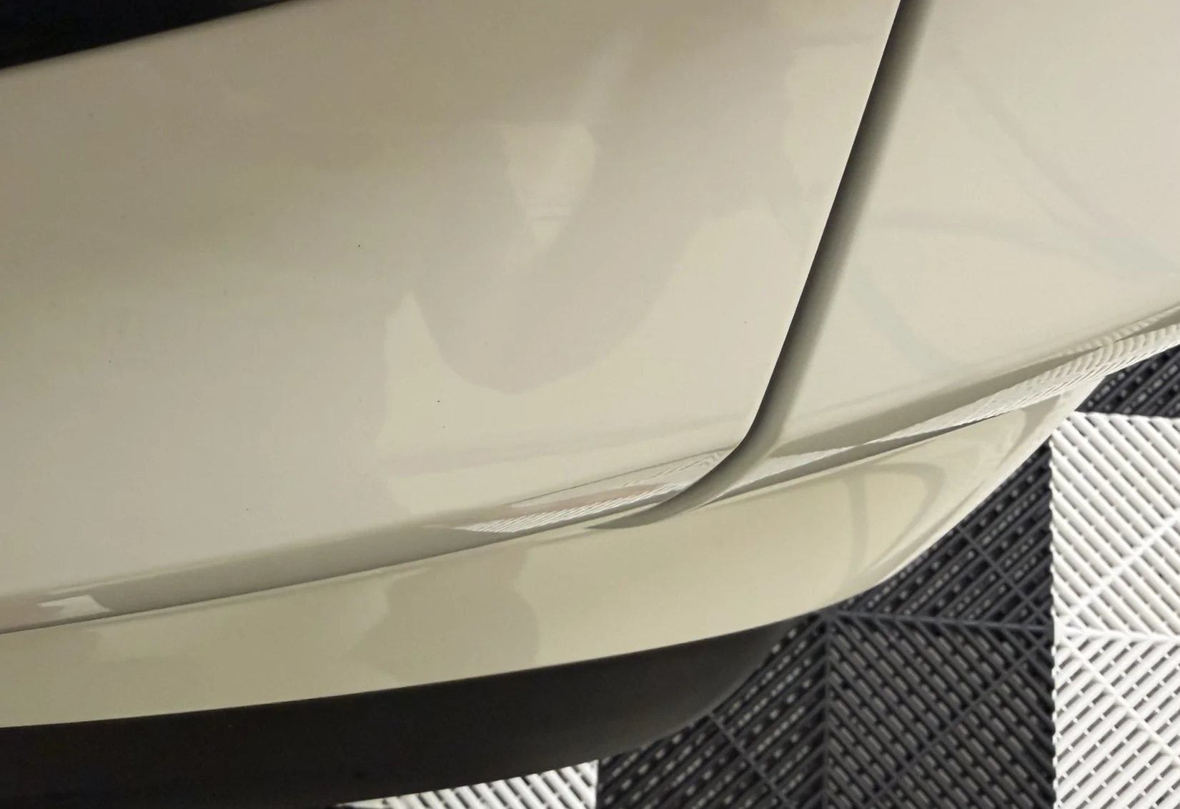

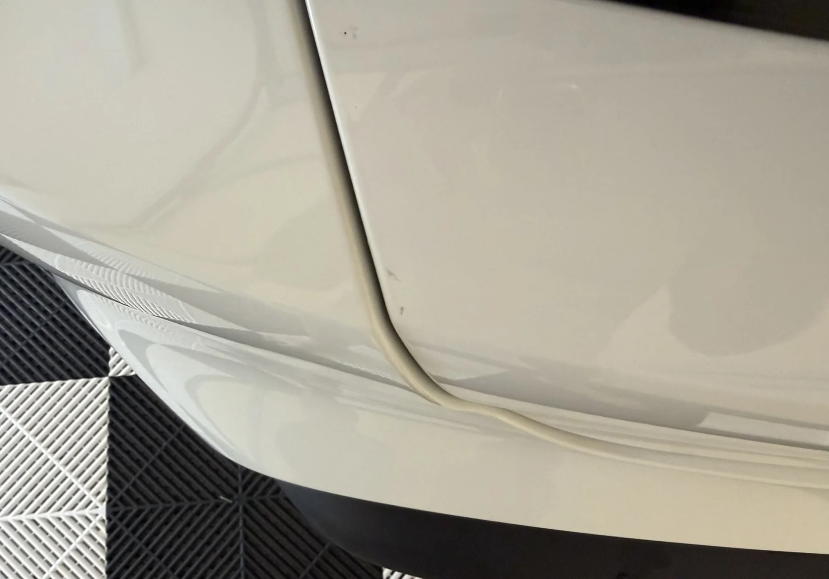

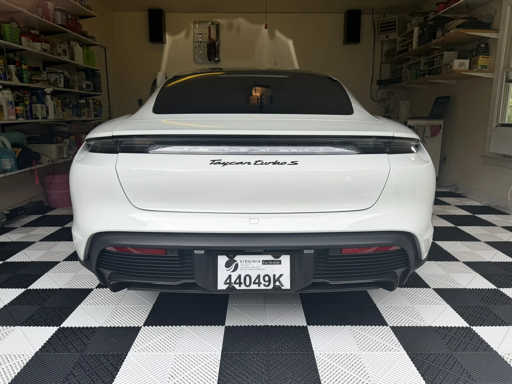

Trunk now sits like this:
Porsche Taycan Trunk / Tail Lights (mis) alignment - how to adjust IMG_2276
Porsche Taycan Trunk / Tail Lights (mis) alignment - how to adjust IMG_2277
The top deck of the trunk is now flush with the rear quarters but I agree that the rear bumper is not 100% right, but at least is symmetrical now.

I agree, rear bumper now needs to be aligned.
It doesn't look like too bad a job. I basically just need to pull the trim from inside the trunk like I had when swapping out the factory ASG with the MapEV tuned one.
