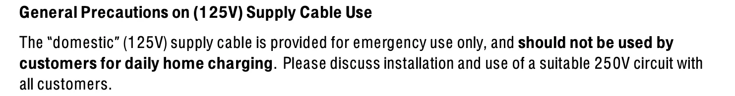

https://www.taycanforum.com/forum/t...-related-porsche-ntsb-article-analysis.13902/
official Porsche charging document…
https://static.nhtsa.gov/odi/tsbs/2022/MC-10222530-0001.pdf
Porsche Taycan Two Years of Level 1 Charging Screenshot 2026-02-16 at 3.24.30 PM
this is Porsche's official advice for residential EV charging and the Taycan…
Porsche has never explained their rational behind this recommendation/advise - but it is their official position on the matter.

I asked PNA if I am able to use the 120V charger for extended periods as I was told I could do when the vehicle was originally purchased or is there a reason I must follow the after the fact advice from the Porsche Service Bulletin released in early 2022 more than a year after my Taycan was delivered.
I was told the wiring or outlet in my garage could heat up and fail with continuous use. I told them that defies logic since a certified electrician insured both the wiring and outlet in my garage can supply up to 18A continuous with zero fear of overheating/melting the insulation on the 12 gauge wires or the Hubble 20A rated receptacle.
They then told me it was because I still had outstanding HV battery recalls which made it potentially dangerous to charge to above 80%.
So I charged for another 4 months to only a max of 80% until my HV battery had cleared all the recalls where PNA confirmed to me I could charge to 100% and for as long as I wished at 120V with no safety issues knowing my wiring and outlet met the continuous current requirement of the Taycan.
I believe I know the reason PNA advised against the extended use of the 120V charger for charging at 10A or 1.2kW/hour. It’s not the on board charger or the HV battery that’s the issue. It’s the charger itself that is not built to sustain extended charging on a routine basis.
