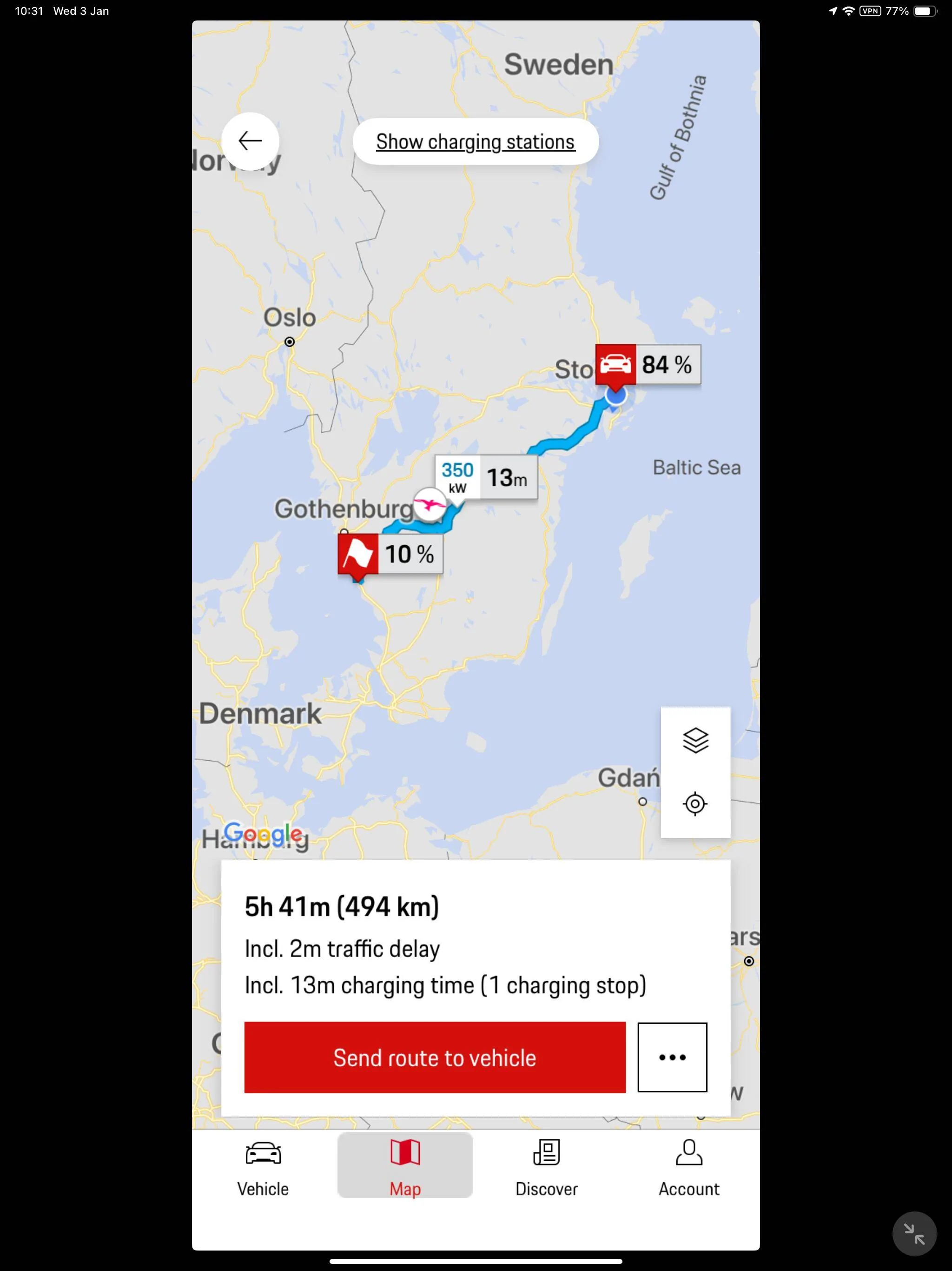

It is at present wild winter weather outside with minus 6-8 C and very windy. I wanted to see how well the app would plan a trip to the swedish west coast to visit some family.
Not very successful!

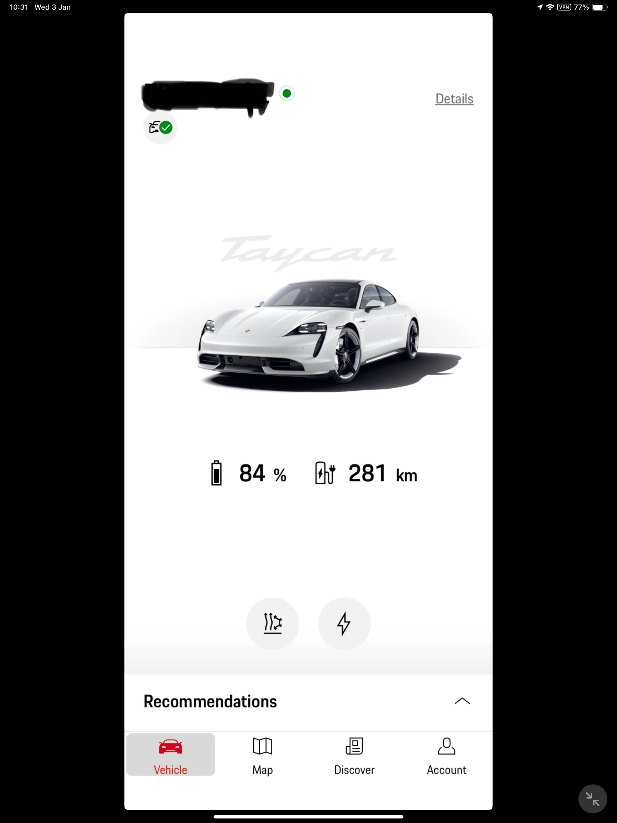

As can be seen the car is charged to 84% with a GOM range of 281 km. Car parked in underground garage and not too cold there.

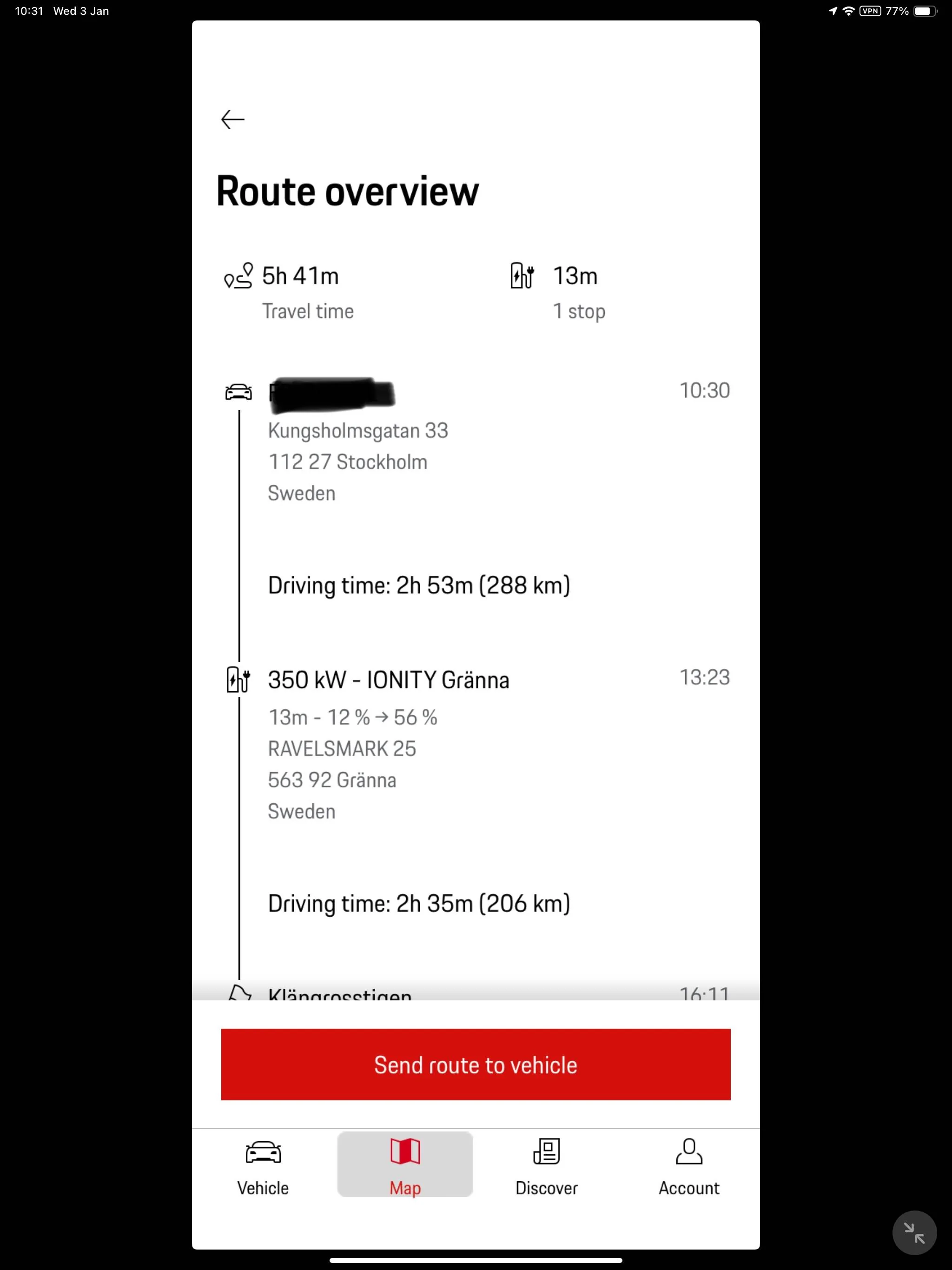

Plan shows next charging stop after 288 km!!! With still 12 % battery charge? :CWL: :rolleyes: Where did that extra energy come from??
I know the plan will change once sent to the car, but this is just so useless. I can not believe Porsche uses such a senseless planner!

Remember that the range shown in the display is an estimation based on your typical daily driving. There isn't really a single truth to how much range the car actually has. It varies greatly depending on speed, weather, driving style and driving mode. What actually matters is the efficiency for a certain trip.
For what it's worth, with the trip planner, it assumes that you're driving in range mode with relatively conservative speed and acceleration.
Lets just do some quick back-of-the-envelope calculation for what this actually means:
Battery capacity: 83.9 kWh
Your current guessometer says that you have 281 km of range at 84% which means that you have a typical daily driving efficiency in Normal mode of
100*83.9kWh/(281km/0.84) ≈ 25 kWh/100km
The trip planner shows that you will go from 84% -> 12% in 288 km. This means that it assumes that eco driving in Range mode will instead have a range of
x/(x-288km) = 0.84/0.12 <=> x = 336 km
With an efficiency of
100*0.84*83.9kWh/336km ≈ 21 kWh/100km
A bit optimistic, maybe, but doable. My CT Turbo S, gets about 22-23 kWh/100km in practice for longer trips when I drive normally, so 21 kWh/100km is definitely possible with some more conservative driving (maybe not in -40°C weather, of course).

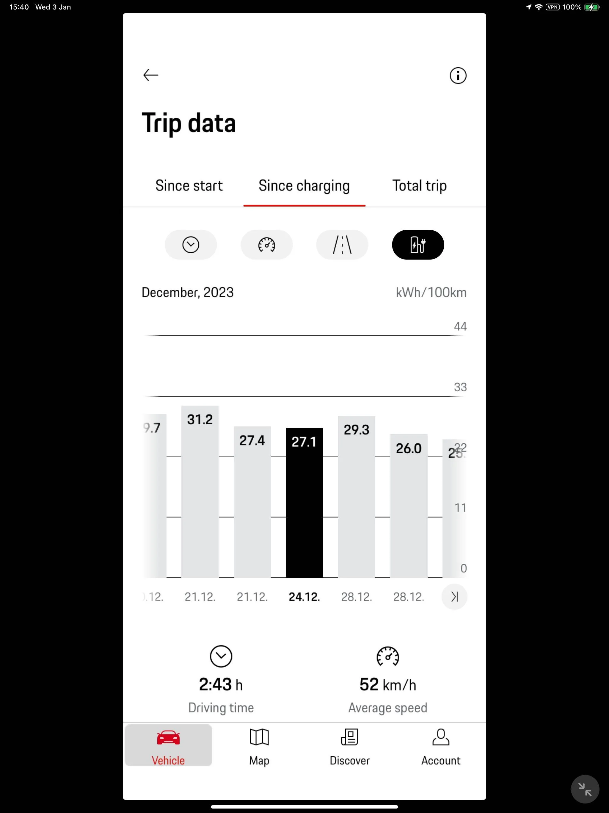

That is great consumption you get, but I seldom get so low. Maybe heavy right foot?
And here is my recent winter trip in -5 C on a 1000 km round trip. All between 26 and 30 kWh/100 km. And with about 60 km/h. In normal mode though. So very much in line with your calculations.
Porsche Taycan Useless planner in MyPorsche app IMG_1873
Which I still was quite impressed by I have to say.

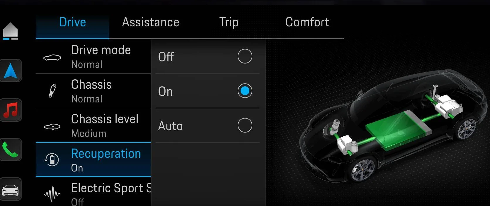

I contacted smartmobilty support via the app. And I got an email response from them! Seems I Need to switch on Recuperation to get that distance to the first charging stop. I copy in their response. I let you decide if you believe this.
Copy:
Regarding your planning trip feature regarding the screenshots you provided, your vehicle can start the trip with 84% of battery, the battery will charge while you are driving through "regenerative braking", the dissipation of kinetic energy is charging your vehicle while you are driving (https://www.porscheriverside.com/ho...peration: when you take,, off, and auto modes.)
Porsche Taycan Useless planner in MyPorsche app 1704305481306
In others words from the screenshot you provided me, you will start your trip with 84% for 288 km then charge the vehicle 13 minutes to charge from 12% to 56% to finish the 206 km remaining and finish your trip with 10% left of battery,
I hope I clarified how work the algorithm of the trip planner, which accurate and trustful,
The last part will mean I would have a Range in my battery of 206km/ 0.46 equal to 447 km in winter time!
