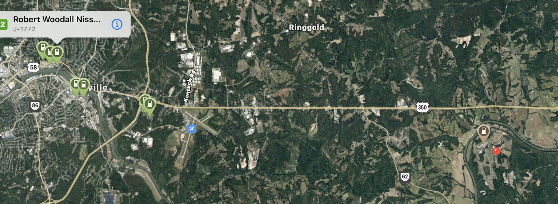

Porsche Taycan Using a campground plug 2C7A2C94-862D-4590-96CA-515F973148A8
there are some decently reliable chargers in nearby Danvile - but wow VIR is a fast charging wasteland!!!
