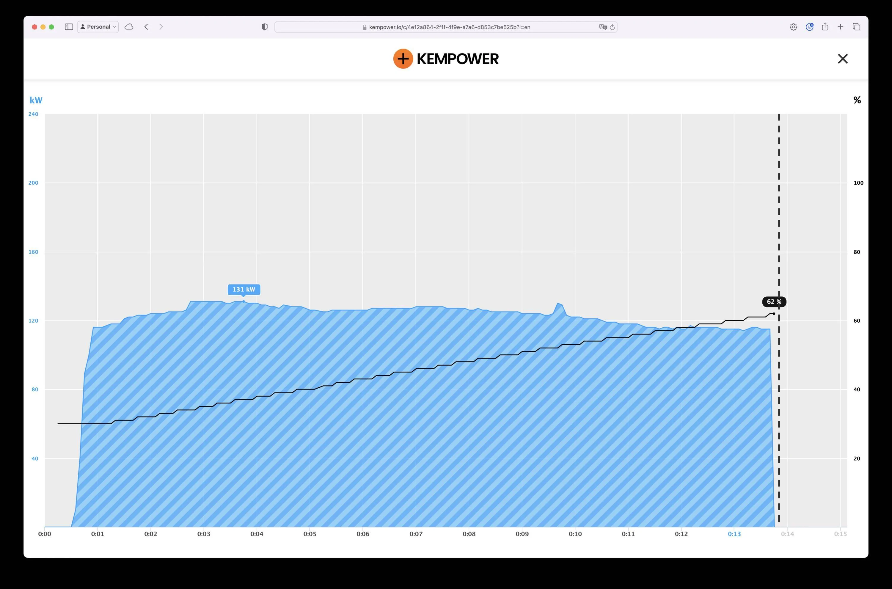

Vehicle limiting charging speed

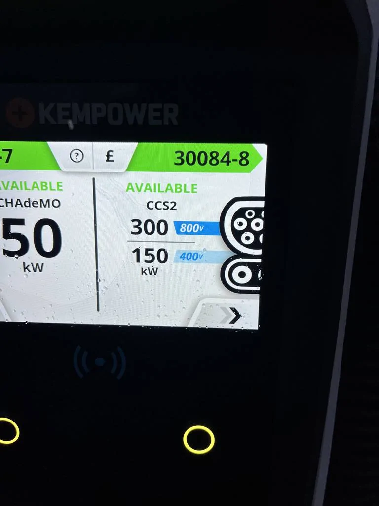

MFG lead the way here with multiple 800v 300kW being rolled out in many garage forecourts. The displays on the units even display the voltage from what I've seen.

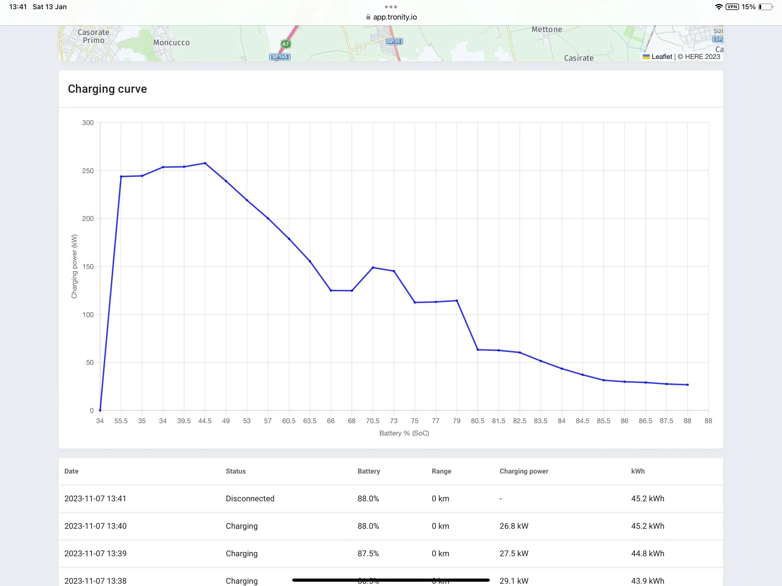

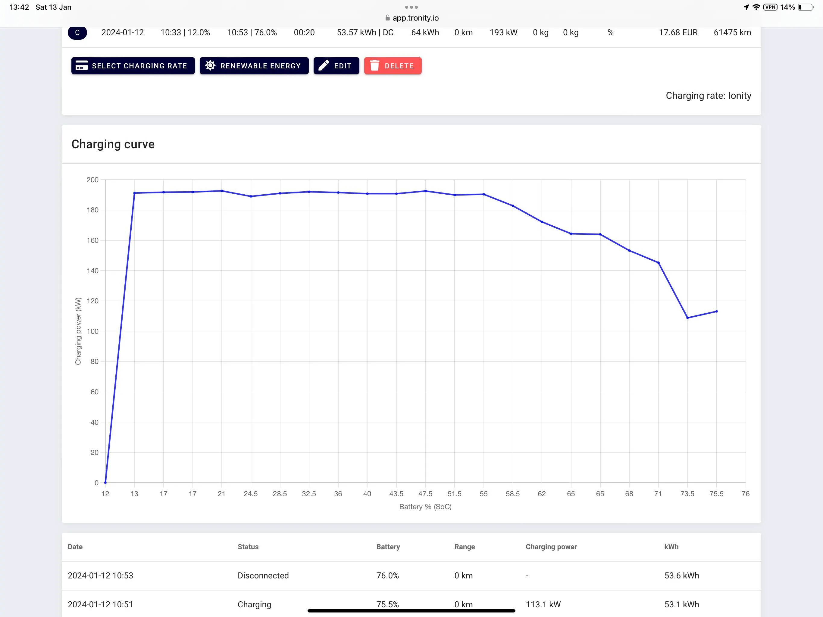

Ionity in France and Germany will give you the maximum power, if the battery has been well prpared. However on my last trip, I am starting to think that the battery saving portion in the PCM (limiting charge to 200 kW), will charge to 80% faster than full power!
Look at the charge curves below! I have seen this a few times and feel that perhaps the battery overheats and limits the charge when using full power?? Anybody else seen something similar?
Charge with Full Power
Porsche Taycan Vehicle limiting charging speed IMG_1902
Charge with Battery Saving switched on:
Porsche Taycan Vehicle limiting charging speed IMG_1903
In either case it is impressive how quickly you can recharge the Taycan. Compared to many other cars , Audi, Polestar, Mercedes , I have often arrived last and left earliest! But of course you need to have the parameters correct, low SoC, right battery temp etc.

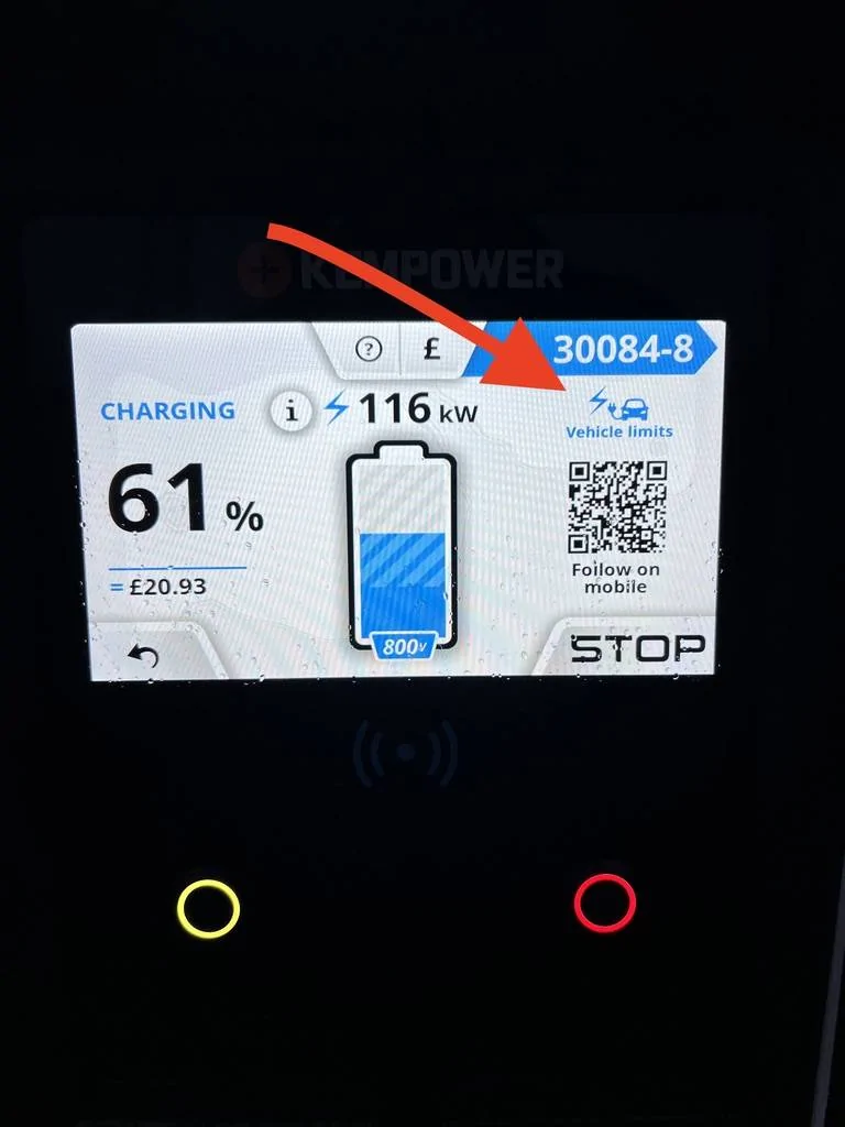

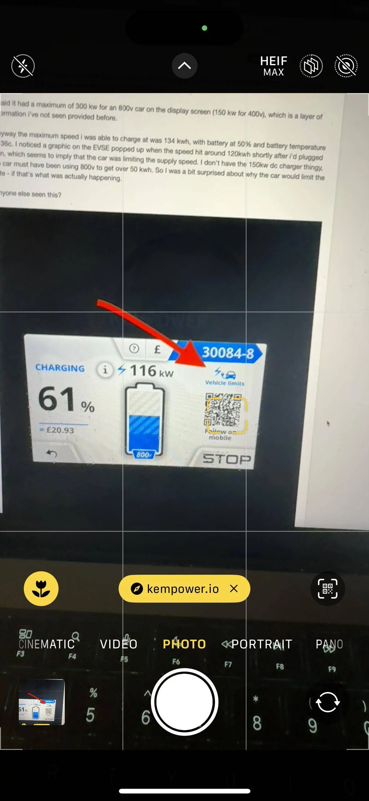

Maybe that's what the vehicle limiting charge icon on the EVSE was referring to. I do seem to have the battery protection box ticked, which i must admit wasn't a function/option i'd ever really thought about.
It's now unchecked as i don't use fast dc that often and i feel somewhat robbed if it's a lot less than hoped for!
Great graphs, well done.
