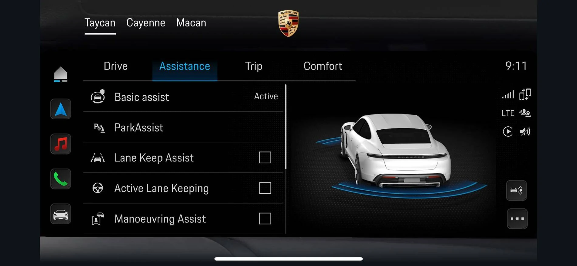

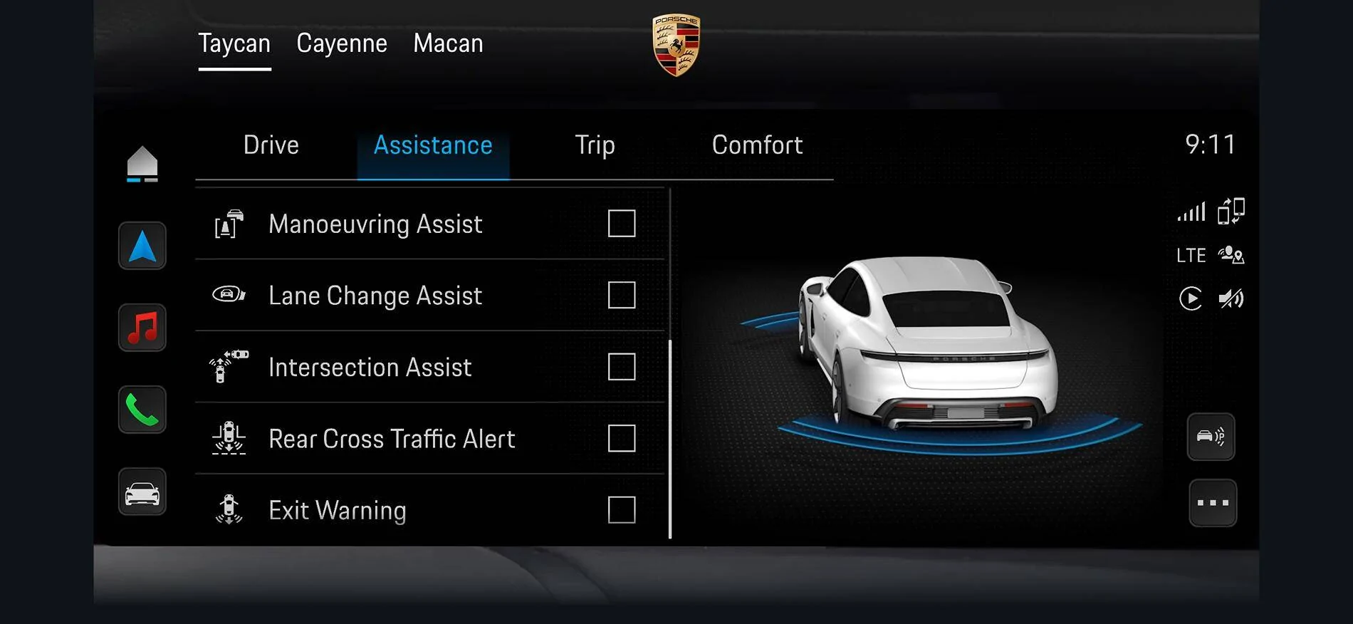

A lot of assistance systems are available for the Taycan, my vehicle only has a few. Which assistance systems are part of which (factory) options, and are a couple of the ones listed below available as FoD as part of ALK or Innodrive? I know factory Innodrive comes with different sensors, but I could not find a good answer to this question on this forum.
so far I know that:
- LKA (Lane Keep Assist) is part of ACC
- ALK (Active Lane Keeping) is part of ALK FoD or Factory Innodrive
- LCA (Lane Change Assist) is part of the LCA option (duh)
but what about these 4: Manoeuvring Assist, Intersection Assist, Rear Cross Traffic Alert and Exit Warning.

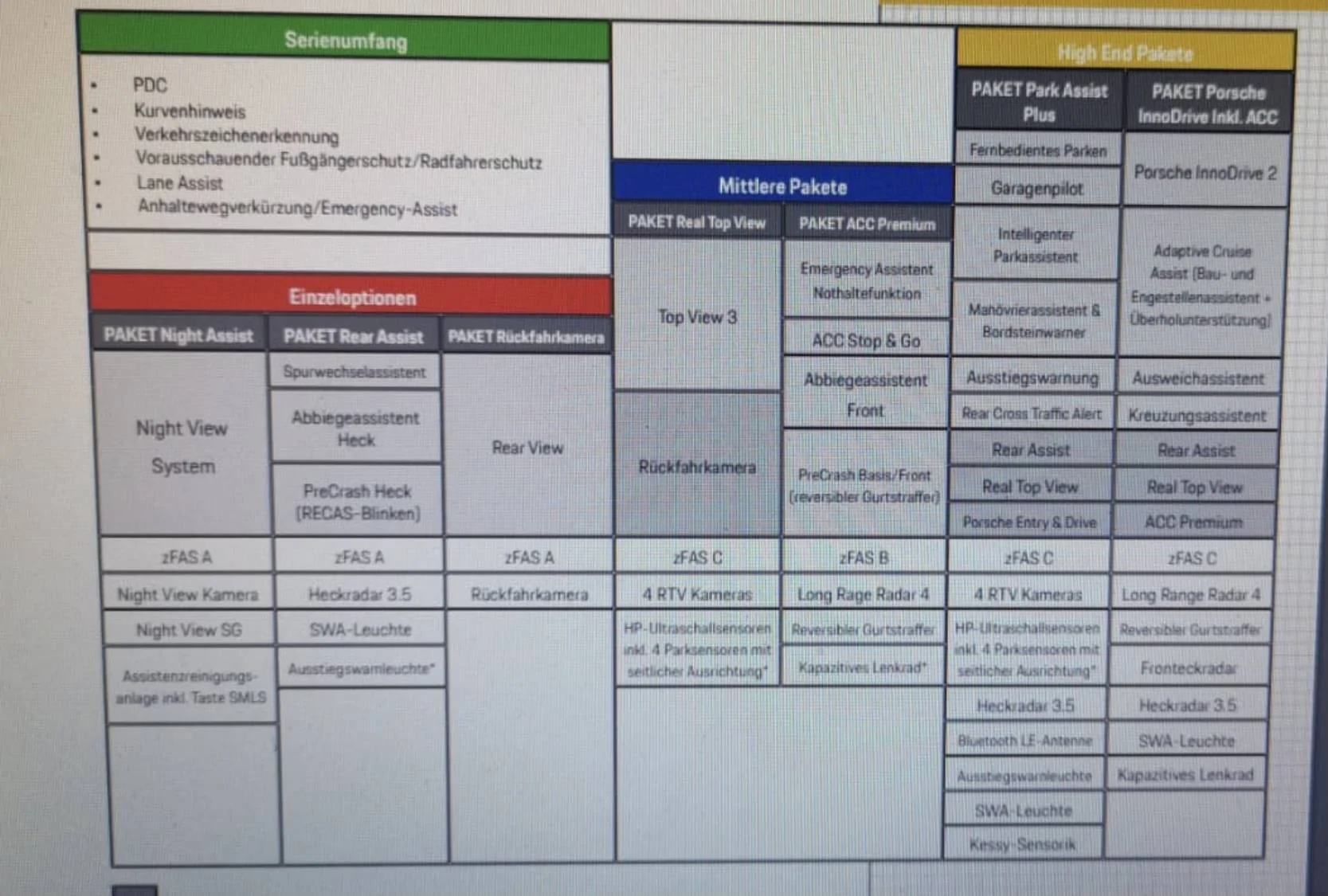

And who has the final answer between Innodrive and Innodrive FoD. I have seen a german chart on this forum about hardware being different between the two and therefore the lack of assistance systems. But all based on assumptions.
Porsche Taycan Which assistance systems belong to which options IMG_4435
Porsche Taycan Which assistance systems belong to which options IMG_4434
The hardware chart:
Porsche Taycan Which assistance systems belong to which options IMG_4436
