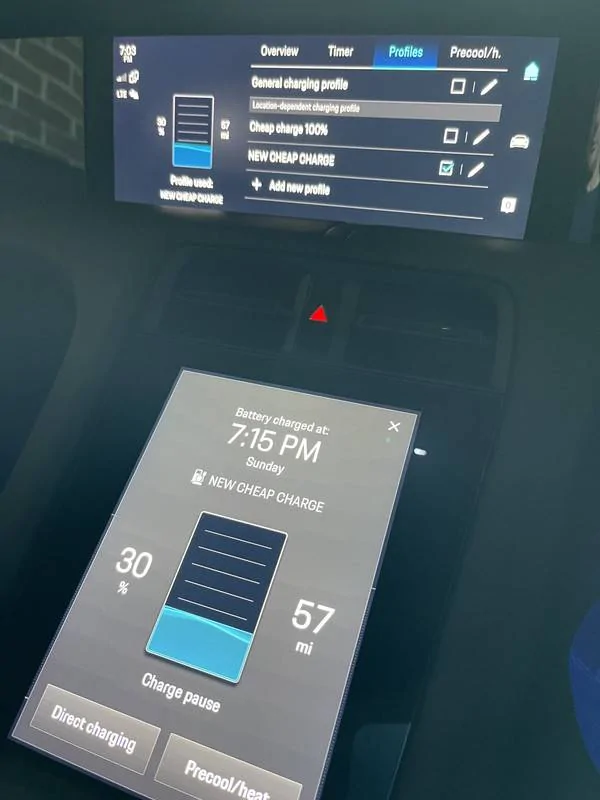

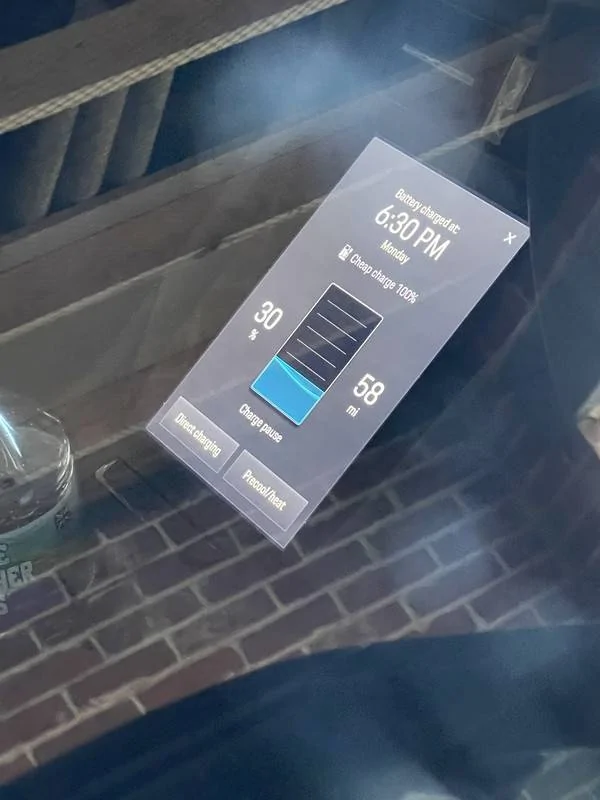

Ok, so I give up. Set it up to charge half an hour after I got home as a trial run. Unticked all boxes, re ticked. Still no joy. Car comes back on as the screens light up but stays in paused mode.
Should now be charging but still paused
Porsche Taycan Will my car charge tonight? 42375957-2E82-4FE8-960C-9E050884B3C3
Deleted all profiles and reset. Same again. Won’t work.
Porsche Taycan Will my car charge tonight? B4908-A3-D-2-BBA-4-D62-9-D89-1-D73915-AD3-F6
So, basically now I’ve given up. My podpoint charge unit now allows you to set a timer and I’ve just tested this. Bit backward in terms of integration but seems to work on a basic level.
So, is it back to Porsche if I want my profile timers to work now? Been fine for 4 months until the software update. So far not impressed with the update. Can’t charge it anymore at night, more German text than before, and none of the annoyances I had before about setting being remembered have been fixed. Not best pleased overall.
