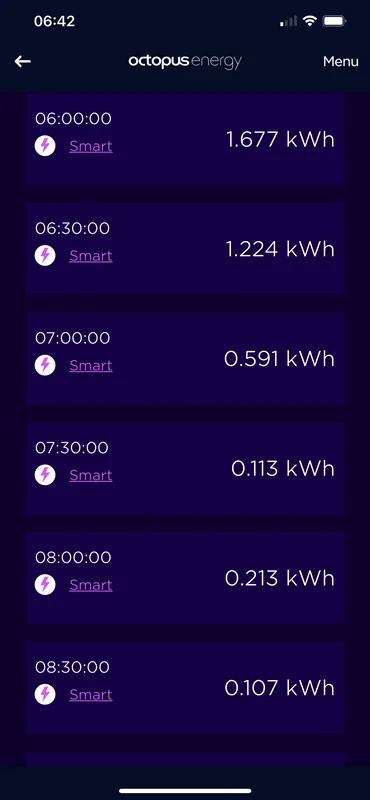

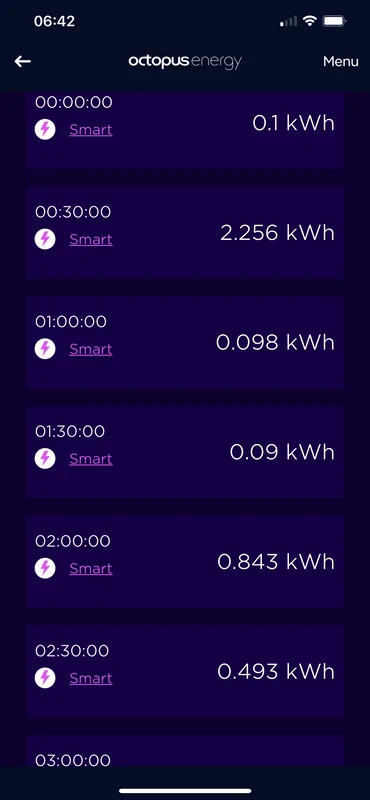

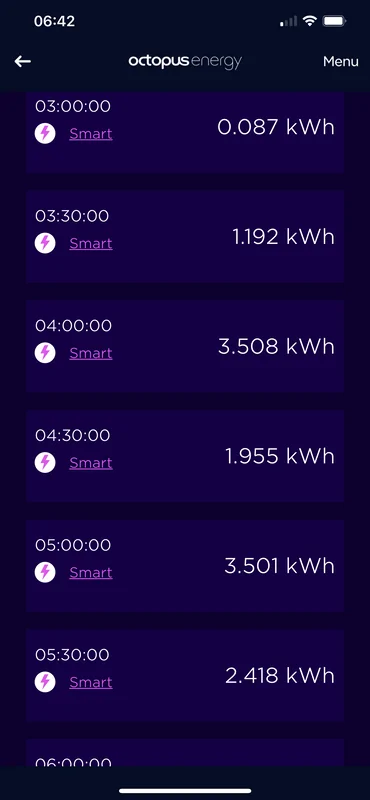

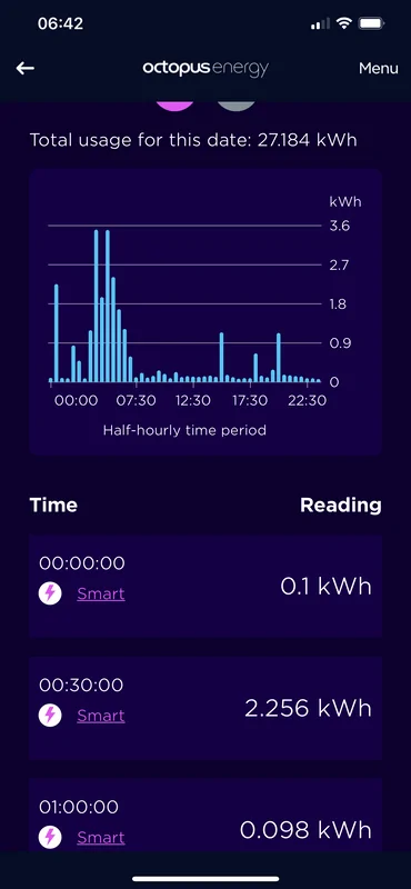

Ok, so just to update setting a timer hasn’t worked. All I want to do is charge the car between 12:30 -0430 regardless of charge % as I have been for 4 months. Electric costs 5p an hour over these hours compared to 15p outside so I charge at a 1/3 of normal cost.
Thought something wasn’t right when I came and cost on electric meter double what I’d expect. Waited for electric smart reading to update to see why has happened. I set the car to charge for 2 hours between 0100 and 0300 knowing this would take me just below 100%.
Looking at the smart meter data it looks like the timer has overriden the profile time and it’s charged but it looks like it’s done it to get to the 7am that I set as a departure time. As a reminder I don’t have a set start time hence why I’ve been using just a profile for 4 months.

Any suggestions what I do know?

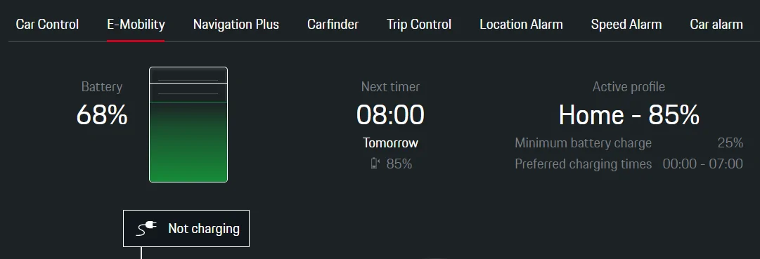

This is what I had set. I just checked and can’t delete the departure time?

Hi, I think you’ve muddled up my posts. The pics posted are my house electric smart meter readings. Completely separate to the car or any charging apparatus. I posted the pics to show my electric usage and when it was drawn.
My last attempt at charging was using only Porsche profile and timers (my pod point timers all disabled, as you advised) and I used a profile and a timer ( as you advised) and the car didn’t charge between 1230-0430 as I wanted it to.
I’ve not used the Porsche charger since I’ve had the car, and to be honest wouldn’t even know how to set it up, so why do you think this will solve my issue?

Hi Nick, looking at your times and your smart meter displays, it seems you only charge at 3.5 kW. Is that all you normally would get. Guess that is about 16 amp on a single phase.
If the above is all power available, you will only get about 14 kWh during the times you have set 00.30 to 04.30. That can not get you even close to 30% battery capacity. Or have you other things at play here?
I think one way to find out is to leave out your profile settings altogether and just set your departure time and desired charge level at 80%, ( or rather the time when charging should be completed to 04.30). When you plug in the car with these settings and assuming you have say 50% charge, the car should be charged to 80% at 04.30, but will likely have started charging well before 00.30. 30% charge for the larger battery is about 26 kWh. If you only have 3.5 kW available it would take something like 7.5 hours to charge 30%!
With the above information I can Not understand how you have been able to charge your car as stated, unless the car started charging shortly after you plugged it in.
I also have no idea how the car will react to have a target charge set, and it realises that there is no way to achieve this in the timeframe given??
I have no experience of how it works when you set charging timers on an external charger.
Hi, pics posted are half hour slots so 3.5kw per 30 mins is 7kw per hour draw and this is the norm in the uk for this sort of charger ( single phase) . 7x 4 is 28kw and works out to be around 30% as I have the small battery.
Thank you have your suggestion above but if I left out the profile it would negate my attempt to charge only between the 4 hours, so no good ( the profile has the timing slot that allows charging between specified hours)
Ah ok I see now what you mean. It is kWh per half hour. Then the 30% makes sense. Sorry.
