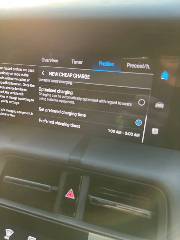

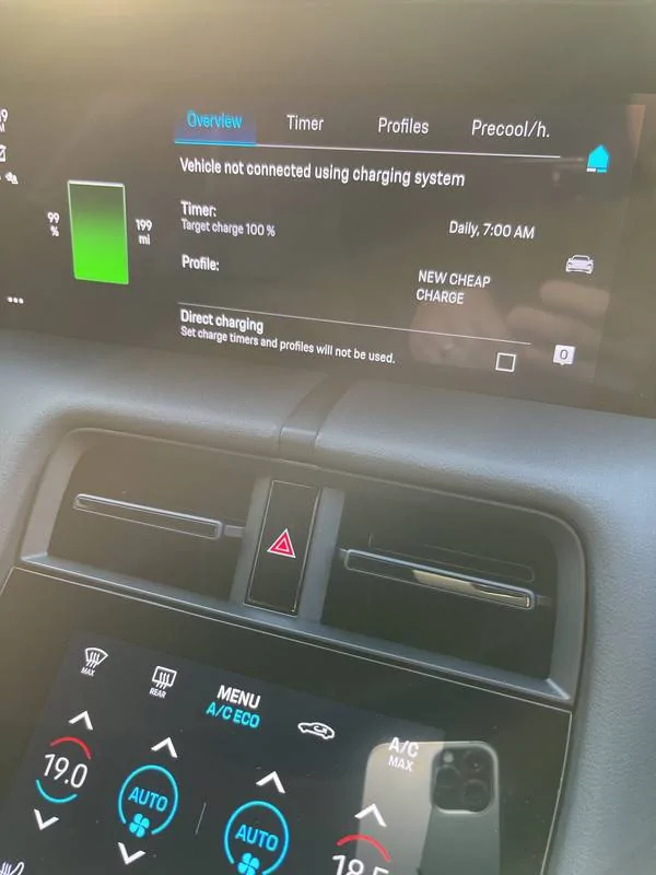

My last attempt at charging was using only Porsche profile and timers (my pod point timers all disabled, as you advised) and I used a profile and a timer ( as you advised) and the car didn’t charge between 1230-0430 as I wanted it to.
I’ve not used the Porsche charger since I’ve had the car, and to be honest wouldn’t even know how to set it up, so why do you think this will solve my issue?
I think it's worth a reset all round.
I've lost track of what the actual issue is but if you are mixing Porsche charging components (timers / profiles) with non Porsche and using a non-Porsche charger I can see opportunity for the electronics to not work as intended.
If you could send a screen shot of the Porsche set up you tried - timers & profiles that would help to unravel.
If you can be bothered I would give the Porsche charger a crack - which one do you have? They are a doddle to configure (honest injun!). You should be able to connect the supply end to you existing outlet but if not try the experiment using the 13A 3 pin.

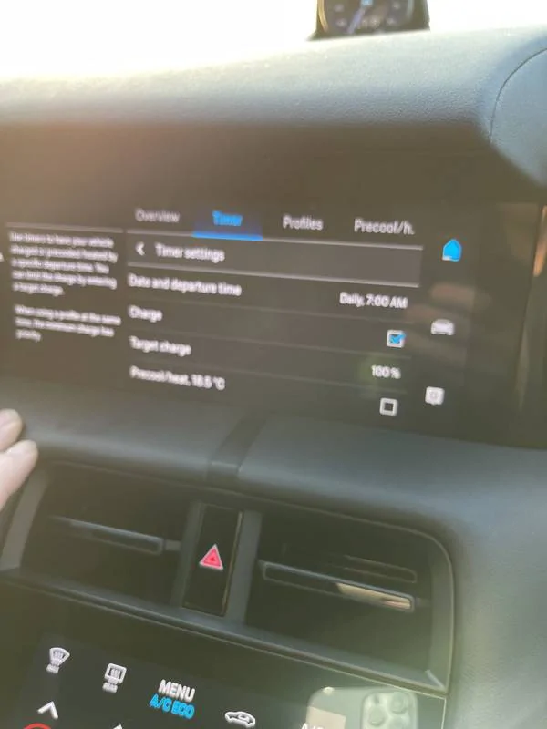

This is what I had set. I just checked and can’t delete the departure time?
I think you will get what you want if you set your departure time to 4.30 AM in the timer and the preferred charging time at 00.30 to 4.30am in the profile.
I know this is not very elegant but I think it will work for what you want. Turn of the preheat/cool function as you do not need this as you have said.
Think you may be onto something here, but what a mad convoluted way of achieving a very basic charging request! So frustrating that for 4 months being working absolutely fine just using a profile, software update applied, now ridiculously complex!
Just gone outside and amended the departure time to 04:30. I’m taking it as long as pre heat disabled the car won’t be doing anything untoward at 0430am?

Your car will not do any thing untoward at 0430 I have mine set up like this for Saturday and Sunday.
During the week I have a a profile set for preferred charging 00.30 to 0430 and a departure timer at 0700 with pre heat/cool set and it charges between. 0030 and 0430 then uses power to heat the car from a round 0700.
If I turn the pre heat/cool off it seems to ignore the preferred charging time and just charges to be ready at 0700 as per your post showing the octopus energy use. This is not ideal!

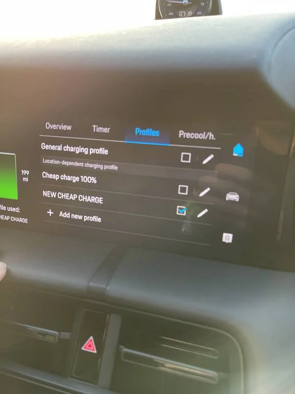

Hi, yes you may be right. Everything I have tried is within the thread with pics. Very simple summery, used to be able to charge between 0030–430 using just a profile for 4 months to get my cheap octopus electric. Got home, plugged in, charged for 4 hours, job done. Post software update, I can longer do this despite the various suggestions using timers/ profiles that I have tried.
Not sure which Porsche charger I have but my car is a my21 delivered mid december 2020. Which ever one came free with it at this point.

Cheers. Well rather annoyingly moving to an 0430 departure made no difference. About to go to bed last night and noticed at 10pm my car had started charging despite a profile timer being set for 0030-0430. I can only guess that as my battery was at 60% and my max charge was 100% it decided it wouldn’t reach that charge in the 4 hours set so started charging early?
Really annoying. Basically impossible just to set a timer to charge 4 hours. Had to disable the Porsche timer and revert back to the pod point timer. This is ok and it works fine but doesn’t integrate with the app and the app shows charging error, so really wanted to stick with the car set up.

So, i thought I’d have another go at using the PCM to control the charge based on everything I’ve read. I now think my car is officially taking the p&ss out of me, or the software is corrupt.
Can anyone explain this?
Charge at 63%. Combo of timer/profile covering the following. Min charge set to 40% so wouldn’t start early.
Max charge set to 90%. 27% is achievable in 4 hours on my car as the smaller battery. Preferred timer set to 1230-0430am. Departure set for 730am. No pre warm selected.

Car started charging at midnight. Stopped at 1230am. Then started charging at 430am. Brilliant. Literally managed to avoid all my cheap electric hours!
I unplugged it at 630am ish when realised it was charging.
All worked fine pre my software update. Could it be corrupt?
