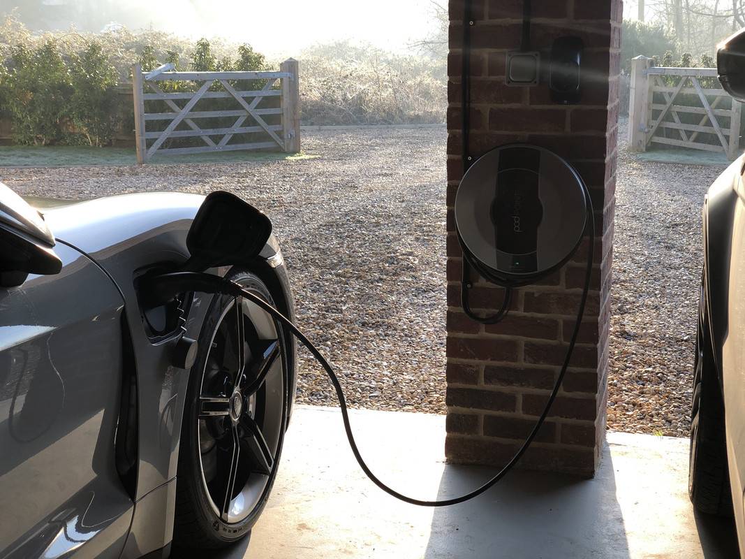

This doesn’t answer your question at all .. but I have my Taycan set to 85% on the general profile and I control the times from my Ohme charger, which knows about my Octopus Eneegy Go tariff (I guess you must be using something similar).
What I have had happen a couple of times is that I’ve manually charged the car earlier than scheduled and then when it came to the scheduled charge it just didn’t work. Last time this happened I had to reset my Ohme charger before the car would charge properly, so I’m not sure what was going on there. If I plug in when I get home in the evening and don’t touch it again until the morning it charges fine, it’s only when I try to manually intervene when weird things have happened.

yes, I’m on octopus and using a pod point. Until a couple of weeks back the pod point wouldn’t let you choose times but it does now, so I’ve used this function the last couple of nights since my issue following the software update. It works ok but not as well as using the Porsche timer. I did wonder about trying to reset the pod point but reluctant as can’t see why this would help and don’t want to create another issue. It’s the car that isn’t starting to charge when its meant to. I will test adding a timer today to see if this resolves.

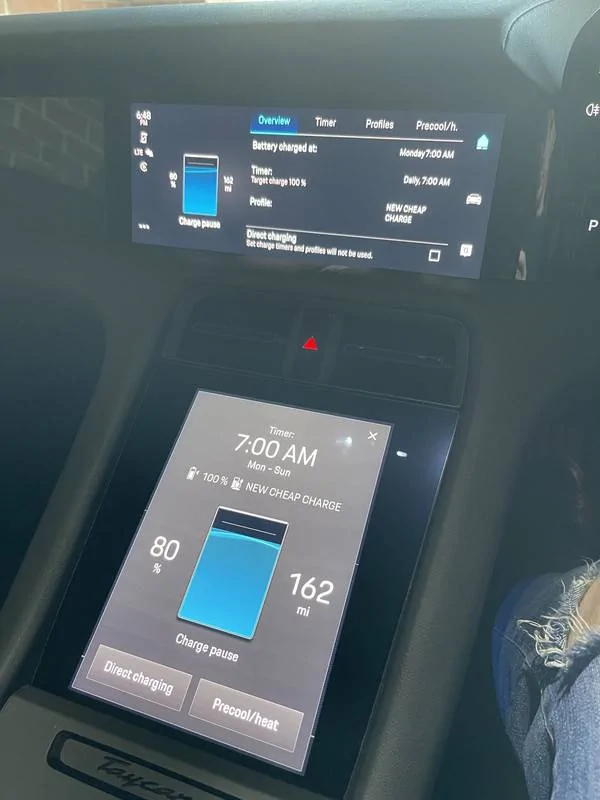

Ha ha. I know that. I just called it cheap charge 100% as it was my 4 hours cheap electric slot with no max % charge.
yes, been charging with just a profile for 4 months. Didn’t need a timer as added unnecessary complexity. Profiles let you add in min charge to get to, then stop and add a time when you want it to start charging and for how long ( eg my 4 hours over night) ( or at least they used to pre my software update!) I will try adding a timer this afternoon to see if this fixes it.

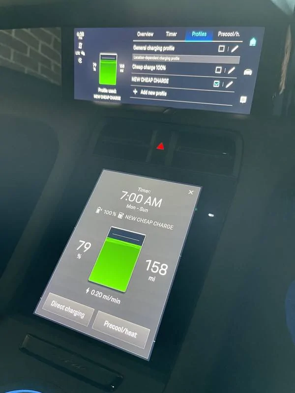

Ok, so did some testing and early indication as some have suggested setting a timer seems to be the issue. Baffled as had the car 4 months with no timer set and been charging with no issue. Set one for tonight for a couple of hours charge so let’s see..
I’ve set a timer at a random time (chose 7am) but presumably if I have pre cool/ heat off this is irrelevant?
I don’t want the car to do anything at a pre set time , but do want it to pre heat on unlock. Noticed the first time I set this in the timer not to pre heat, it forgot the setting and had re ticked itself so let’s see.

Now my generic pointless timer is set it isn’t going to do anything I need to be aware of is it???
11,016
6,805
Preheat via timer is optional and independent of door unlock preheat/cool and remote climate set.
Don't set preheat if you don't need it...simples.
Looks like you are using the tech correctly this time around. BTW - 100% charging is not recommended unless you plan to use the car that day.
