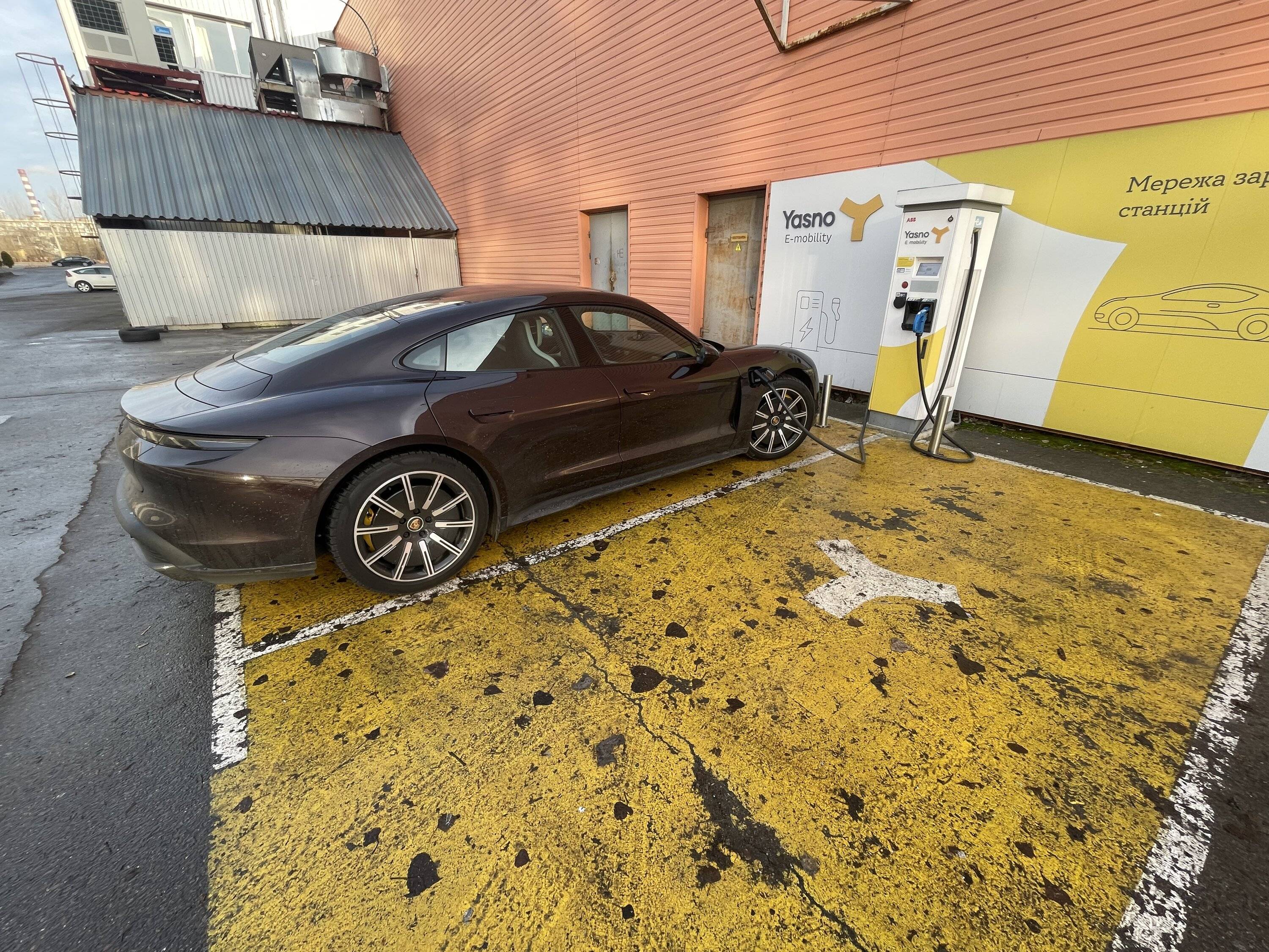

question then remains, is it a disadvantage to dosummer / winter rubber switch twice a year
Well I don’t know really. Considering we get harsh winters I needed those aero wheels to protect PCCBs from all the salt and dirt on the roads, so I’m not really disappointed by that purchase.
