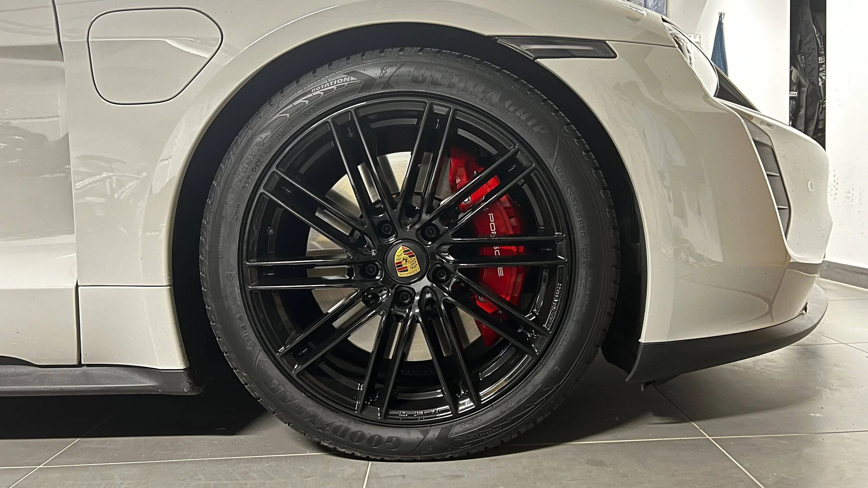

WHEEL DETAILS:
Front axle:
MAK Leipzig-D, 9x20 ET50 5x130 71,6,Gloss Black
Rear axle:
MAK,Leipzig-D,10,5x20 ET55 5x130 71,6,Gloss Black
Tire:
Front
Goodyear UltraGrip Performance GEN-1 245/45 R20 103V XL NF0
Rear
Goodyear UltraGrip Performance GEN-1 285/40 R20 108V XL NF0
Need a bit of help. I'm interested getting a set of MAK Leipzig-D for the winter.
Did you had any issues with Porsche center for using aftermarket rims?
The size is a bit different than original 20 inch rims 9Jx20 ET 54 / 11Jx20 ET 60

It is a TÜV approved rim, tires are Porsche approved N0 marked.
I have had no issue with Porsche Centers yet, but better to turn to them directly. I take this "risk" rather than buy their ugly looking golden priced winter wheel sets.
The car was in service under warranty at winter time (charging door) on these tires, had no comment on that.
I have that combination on my car. And I have been to my Porsche centre for help with the TPMS in the winter wheels as well as several workshop and service issues. Never any comment about any impact on Warranty. Only issue was the TPMS sensors were not Porsches so they could not help, but a tyre specialist sorted that out!
I think the wheels look better than Porsche's winter sets. The dealership told me today that range will be better if I get their 20' Aero wheels but couldn't give a number.

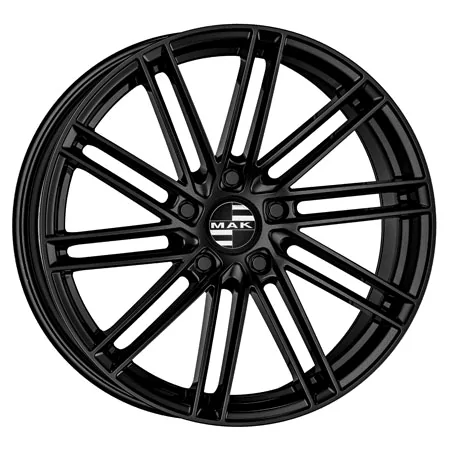

Where did you buy the Porsche center caps? do you know the size of them?
Bognar67
Janos
Jul 9, 2021
831
856
Hungary
Taycan GTS 2022, i4 40 MS 2024, GT3 992.2 2025. 911 C2S 2027 soon.
They are from the original RS Spyder wheels. No need to buy.
