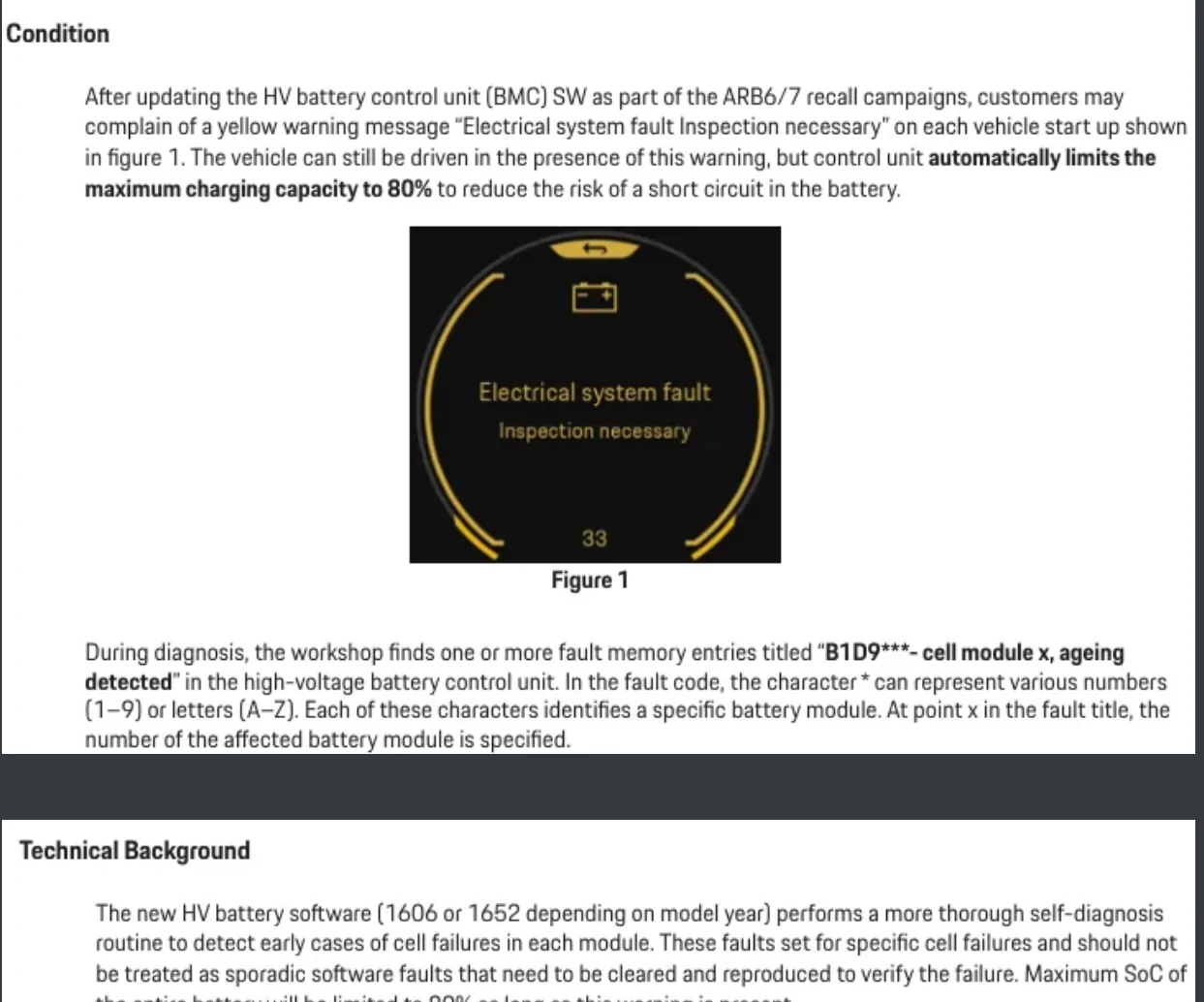

Mine had the yellow electrical error come up last week. No issues driving the car - all appeared well. Went to Porsche today. Has a single cell fault reporting aging apparently. Cell 19. Needs to be replaced.
I have been quoted 2 weeks. It is a 30 hour repair 😱. Presumably at a cost to someone of £7-10k.
My car is 3.5 years old. I have an extended warranty and also the roadside assist. (I know the battery is 8 years warranty). Having driven in, they have sorted me an e Macan this afternoon as the car is deemed undriveable. Not sure if they would have done this if I hadn’t had the roadside assist. It is OK and will be fine for a couple of weeks although it is clearly a base model. But as always, they were very helpful in Tewkesbury.
Intresting that they already started calling it aging :D
If you were out of the initial 8 year warranty, that would have ment you paying out of pocket - even though this is not aging, but manufacturing defect :D
87
8,218
7,252
Warranties only cover failures due to manufacturing or design defects, typically never aging or wear. After warranty neither are covered.
All parts have an MTBF curve, typically a normal distribution (a.k.a. bell curve). Warranties for expensive parts typically cover the early part of that curve, so most people can expect their parts to live beyond warranty coverage. Hypothetical example, say the failure curve for the whole battery is a perfectly normal distribution and warranty covers -1 sigma (16% of batteries fail during the 8 year warranty), then 84% batteries last more than 8 years, but only 2.5% last more than 16 years.
Problem is that 99% of these “aging” defect are actually manufacturing defects; which should have been fixed via hardware replacement as soon as the defects where known and the recalls made public.
Instead, porsche choose to develop a software that calls it “aging”, which coincidently is the exact language to make these manufacturing defects not covered by the extended warranty anymore, even if you choose to extend warranty beyond those initial 8 years.
It’s just that for now, no car is beyond those initial 8 years. But the fact that they are already calling it aging in services, and not just the software, is quite a clear tell.
It has been hypothesized several times on the forum that this is porsche clearly avoiding responsibility and passing down costs for manufacturing defects to the costumers.
Spot on.
It's the sort of practice you expect from some backstreet 2nd hand car dealer.
IMO Porsche seem to be in a race to the bottom with how badly they can treat Taycan customers.
Calling battery manufacturing defects 'ageing' to avoid future expensive warranty claims is a new low.
