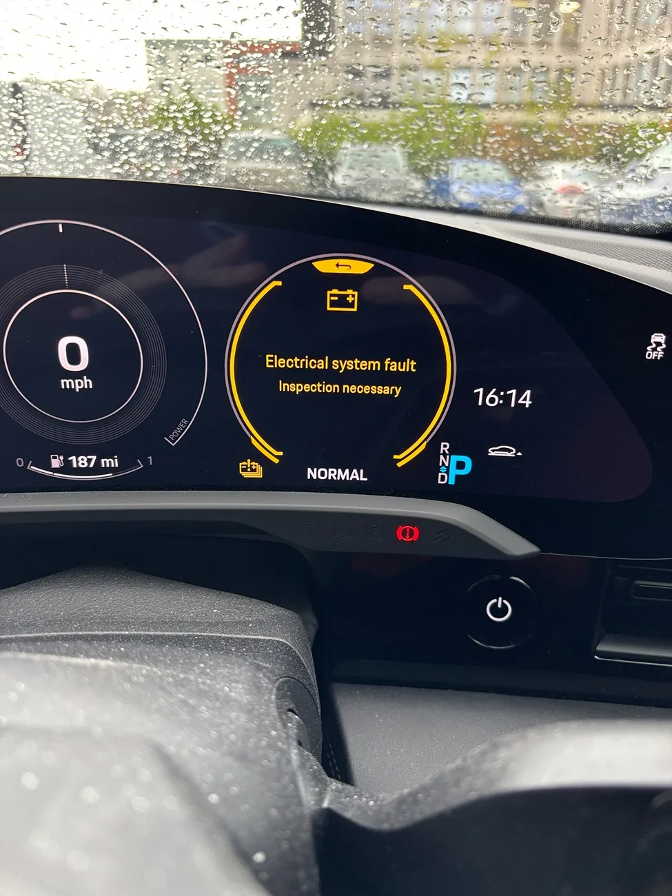

Mine had the yellow electrical error come up last week. No issues driving the car - all appeared well. Went to Porsche today. Has a single cell fault reporting aging apparently. Cell 19. Needs to be replaced.
I have been quoted 2 weeks. It is a 30 hour repair 😱. Presumably at a cost to someone of £7-10k.
My car is 3.5 years old. I have an extended warranty and also the roadside assist. (I know the battery is 8 years warranty). Having driven in, they have sorted me an e Macan this afternoon as the car is deemed undriveable. Not sure if they would have done this if I hadn’t had the roadside assist. It is OK and will be fine for a couple of weeks although it is clearly a base model. But as always, they were very helpful in Tewkesbury.
